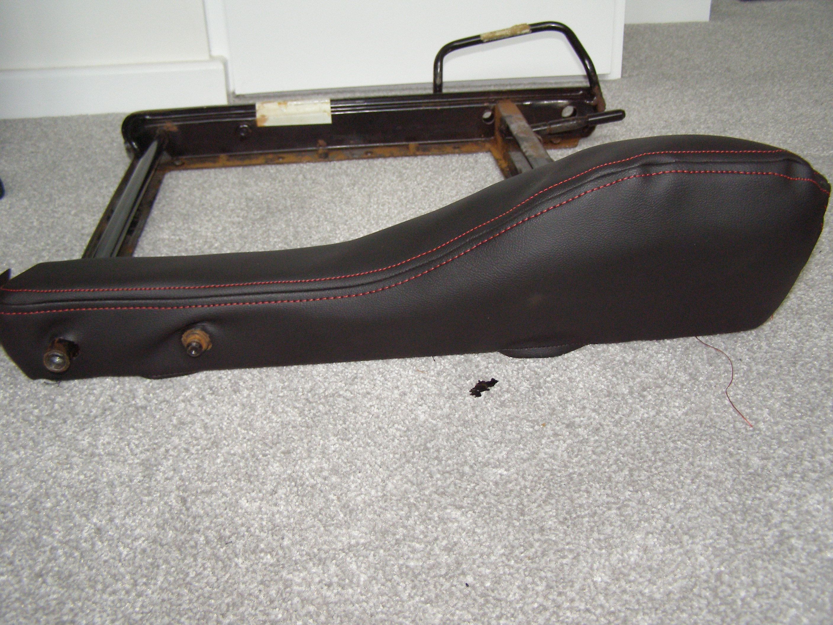

Here is a picture of my first attempt at a bolster, I know the top stitching is awful but that's due to the problems mentioned above, the machine runs too fast and is very difficult to control and get it to go in a straight line and the machine doesn't cope well with thick materials and can't pull them through easily. I also need to make a few adjustments to my pattern and to remove some material from the seam on the reverse side to follow the curves better, its my first attempt so it was bound to be less than good.

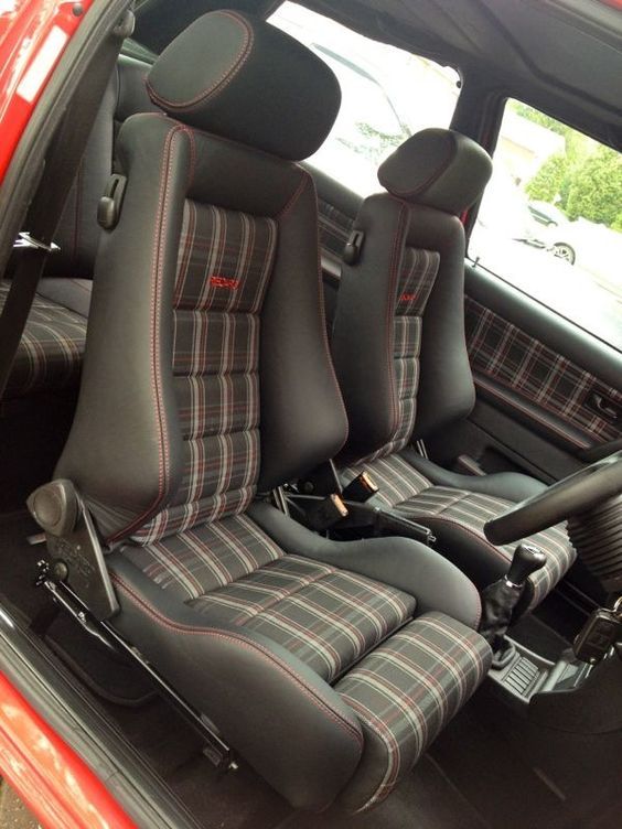

Trust me, it is not that easy to sew at beginning even if you have great machine. Using incorrect equipment is just shooting yourself into the leg. Making headrests with french seams like on picture above is hard(if not impossible) with table sewing machine, not even talking about non-industrial ones.
