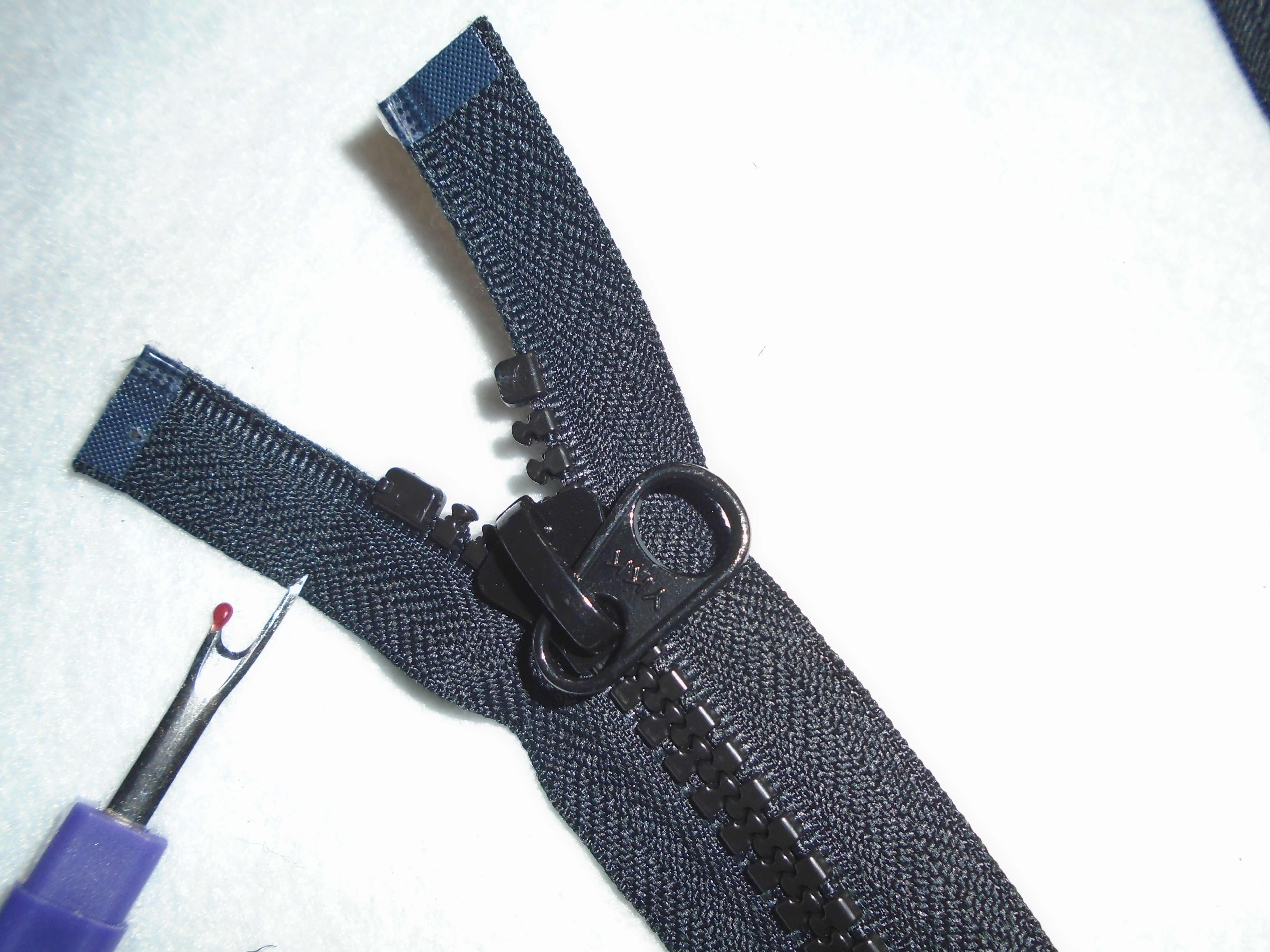

For plastic zippers I use some of the off cut teeth meshed into each side and then use my hot knife to melt and blend it together.

Melting the teeth is an easy way, you can add a piece of fabric to cover a few teeth to make a stopper as well, and as mentioned before, depending on zipper size, you can fold over
#22588
Tried the melting method and it works just fine but snipping a piece of 3/4 binding folded over the teeth and just sewn in with the zipper is more efficient time wise. #10 zipper stops aren't difficult to put on, i use a pair of curved needle nose pliers and they do a fine job.
