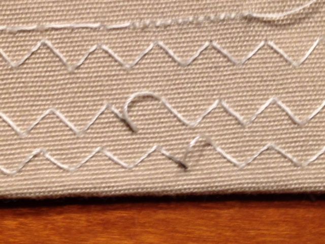

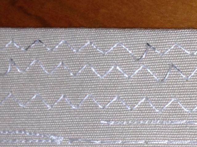

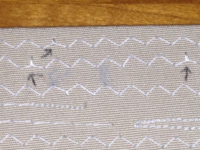

I have a Thompson Mini-Walker walking foot machine. Lately in zigzag mode, after several inches of perfect stitches, there are several with an huge excess thread loop on the bottom. I'm sewing 2-4 layers of Sunbrella 9 oz. canvas. And there is always a dark grease/oil stain visible on the thread on that stitch. And the top thread at those points are pulled over way too tightly.
One top side photo and two bottom side photos are attached.
Machine is in good repair and is oiled correctly. I wiped ALL of the oil off the shuttle area and the problem persists. There are no nicks on the gib hook or cap spring. The gib hook rotation timing and side clearance from hook to needle are in spec.
What could cause the top side thread mark? And what is wrong?
