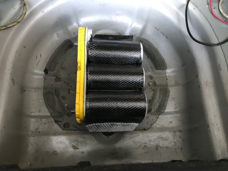

Did a rough cut on the carbon fibre shell. Next is to cut the lines more straight, glue some rings to the carbon where the bolts will go for even distribution of the force when torquing down and continue with the bottom piece for the bracket.

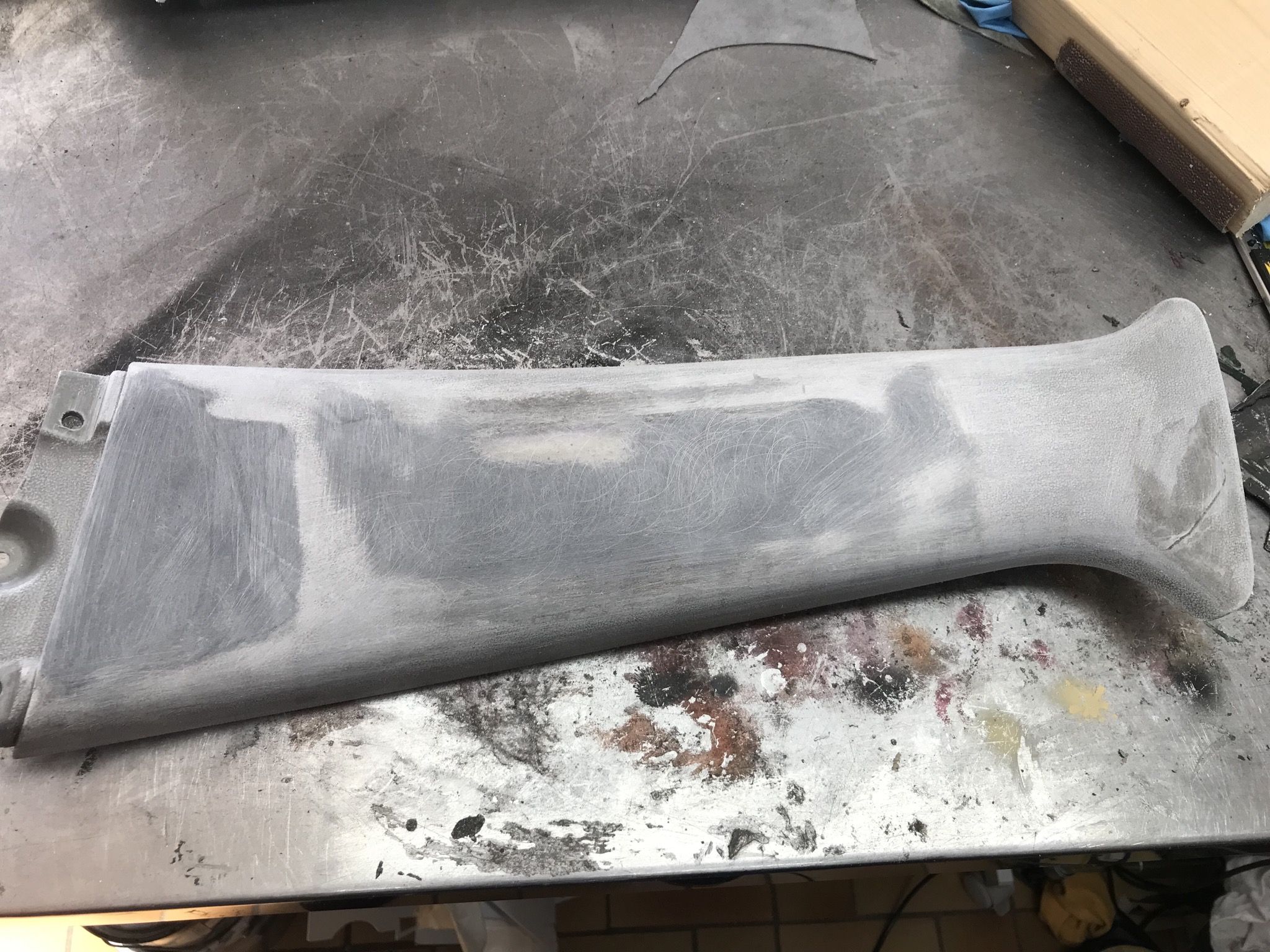

Closing the hole on the B pillar.
Made a template for the lower part where the seat belt normally comes out between the plastic covers, to fill it up and make the panel even for upholstery.
By AvensisGT4
#10164
Applying plastic bondo to smooth out the panel.

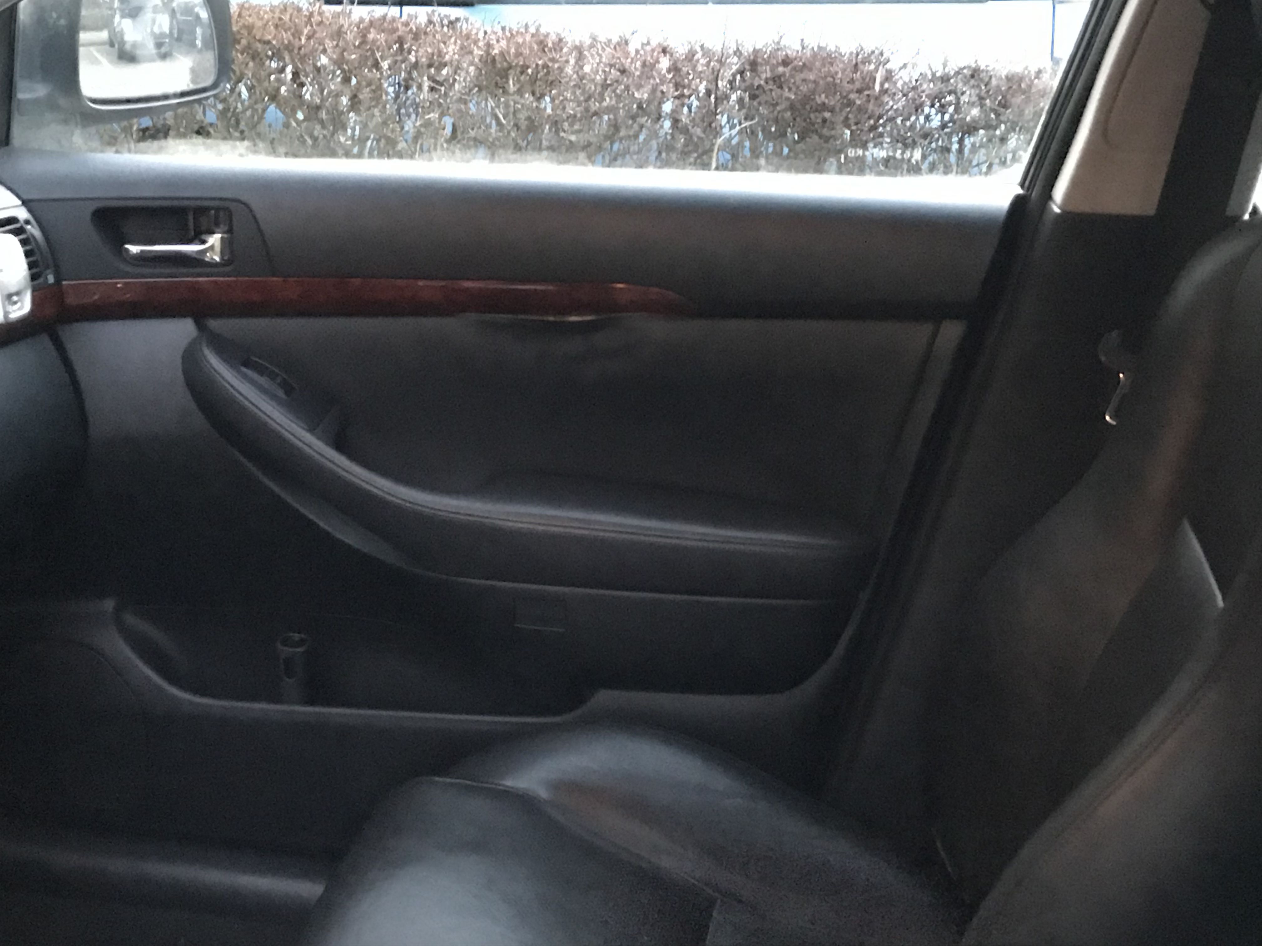

#10204
The door inserts of my other toyota avensis were coming loose at the edges. Took the doorpanel out and replaced the black perforated leather with dark grey leather.
