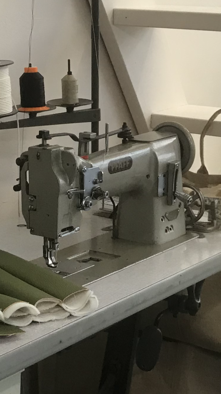

Yesterday working with my Pfaff 145 (H3-6/01) I stumbled into an issue when the presser foot got stuck in the up position. The lever on the backside suddenly went from functional to being all loose, and having no impact on the presser foot while flipping it up and down. It feels like something "jumped out of its place" or a screw somehow got unscrewed, disengaging the presser foot function. Is there someone with an experience on this matter? Is there some sort of an instructional youtube clip or a online PDF out there to help me solve my problem?

What was going on when this happened? Were you sewing and raised the lever and it wont come down? Was it being transported and found this to be the case when it reached the destination? And is it the model with or without the big leaf spring on the top of the machine?

Hi Adam! Exaktly, I was sewing and raised the lever, and then it wouldn't come down. And from that moment, the lever on the backside's been all loose. I'm not sure exactly what a big leaf spring is, but I'll include a picture of the machine here in my reply, and maybe you'll be able to tell if that's the case or not!

That bar on top is the leaf spring i referenced, its for foot pressure rather than having a coil spring around the presser bar. Measure the height from needle plate to bottom of the foot, should be 11mm, if its more i bet its just in a bind. Reference @John's diagram and try tapping it down.
