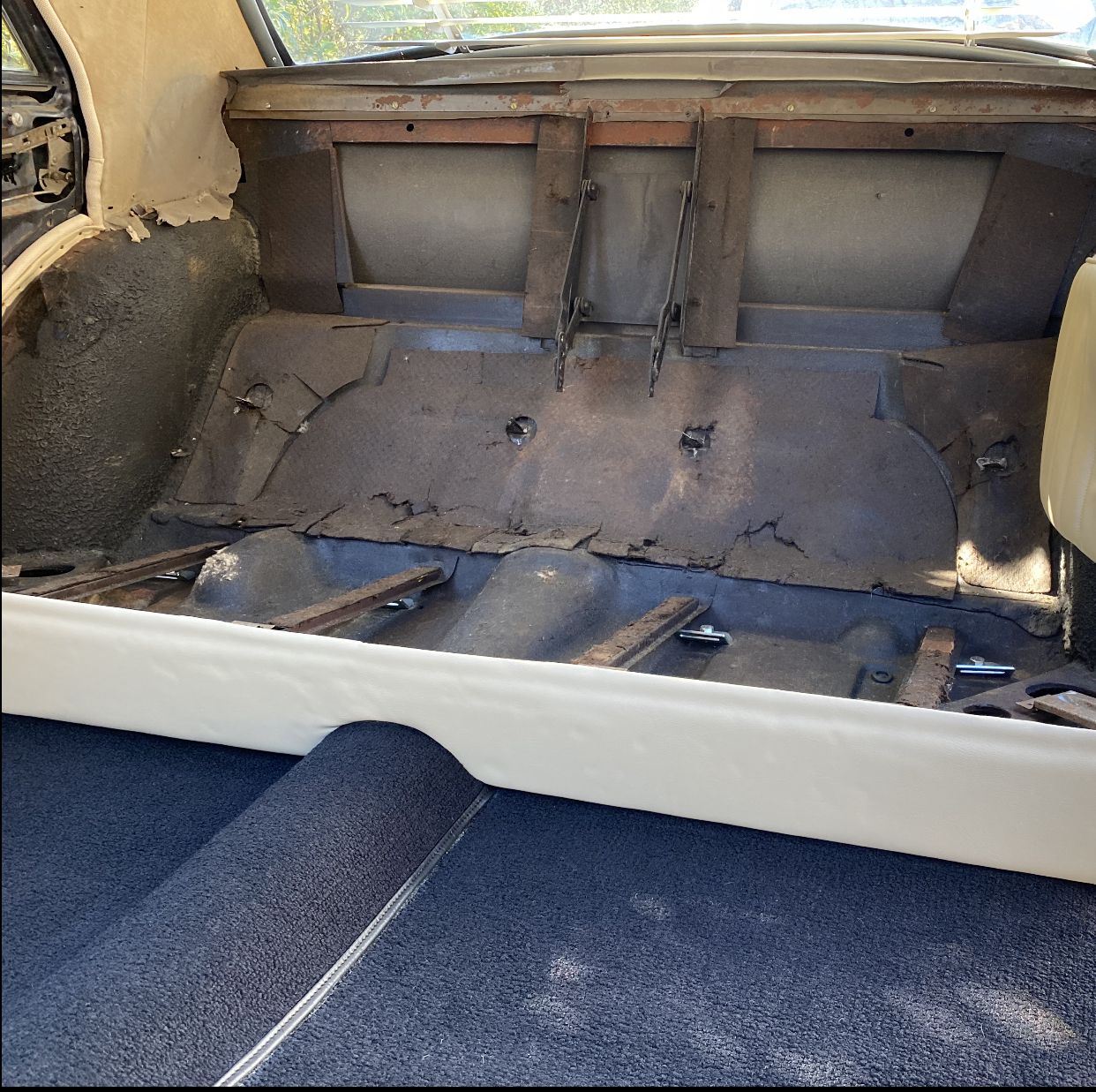

Love the work you did on your seat. That back is amazing. The previous owner of this 49 drilled holes in the floor boards (good or bad) and put a 1/2" bolt, large washer and lock nut on the underside of the vehicle. I have included some photos of the original interior before I put new carpet in for the front seat and also the back seat. If you decide to go this route, I would add some water proofing sealant on the holes you drill through the floorboards tp prevent water and future rust issues. Hope this helps.

. I would also add, that you can see the seatbelts from the back seat on the floor. If you are worried about seeing them, you might want to place them as far forward as possible or make a material pocket to place around the silver latches on the floor so they are not a distraction from the amazing seat you created, just a thought to consider.

I also wonder how did he ran seatbelts thru the front seat frame? Did he cut slots , something like this?
By Pitt_Boss
#15838
Nothing was cut on the seat frame. The after market lap belts were fed in around the seat frame in-between the gray heater plate which is on the floor and the seat frame. This would be below the red markings you added to the photo. The belts are long. They laid on the metal frame going back toward the back of the seat. The bottom seat placed over them and then they are placed to lay on top of the bottom seat cushion. It might be better to cut into the seat frame, but I'm guessing you'd need to smooth out the cuts so the seat belt isn't cut over time. You'd never know the belt is deteriating if its shredding at the cut point in the seat frame. I'm guessing you may not have this as your daily driver, but if you're turning her into a hot rod...based on your sewing skills... you might want to upgrade from lap belts. Hope that helps. Let men know if you have any other questions on the interior as mine is all ripped apart. Best of luck
