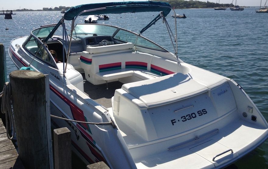

I have a 1996 Formula 330 Sun Sport power boat that I'm re-upholstering (the current vinyl is 23 years old,getting brittle and starting to crack). So, I thought I would start a thread to share the project and seek some advice along the way.
The boat has a fair amount of seating in the cockpit

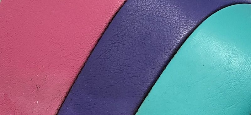

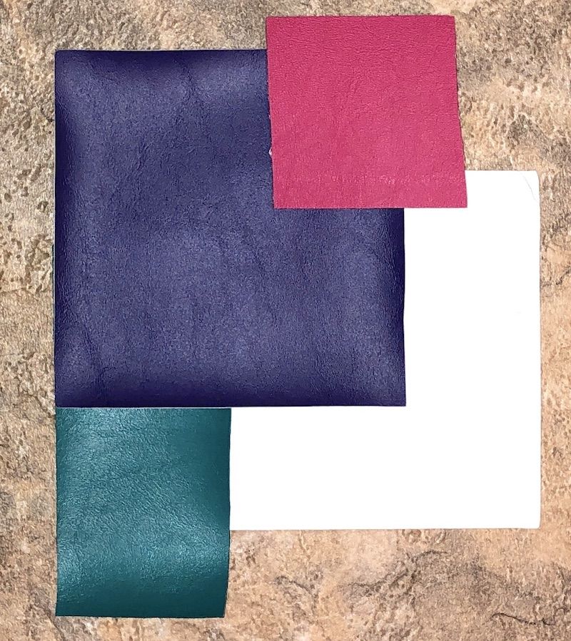

I contacted the Tech Support folks at Formula Boats to see about the vinyl colors. The color scheme is a bit dated (pink/purple/seafoam green), but matches the exterior of the boat, and as such, I wanted to stay close to the existing color scheme.
The colors are discontinued, but I was able to get some leftover stock of the pink and matched a purple, but not the seafoam green. I settled on a darker green. So the colors are Nautolex 'Bright Ruby' (pink), Morbern Seabrook 'Purple',Morbern Seabrook 'Deep Sea’. The white is going to be Morbern Seabrook 'White'.

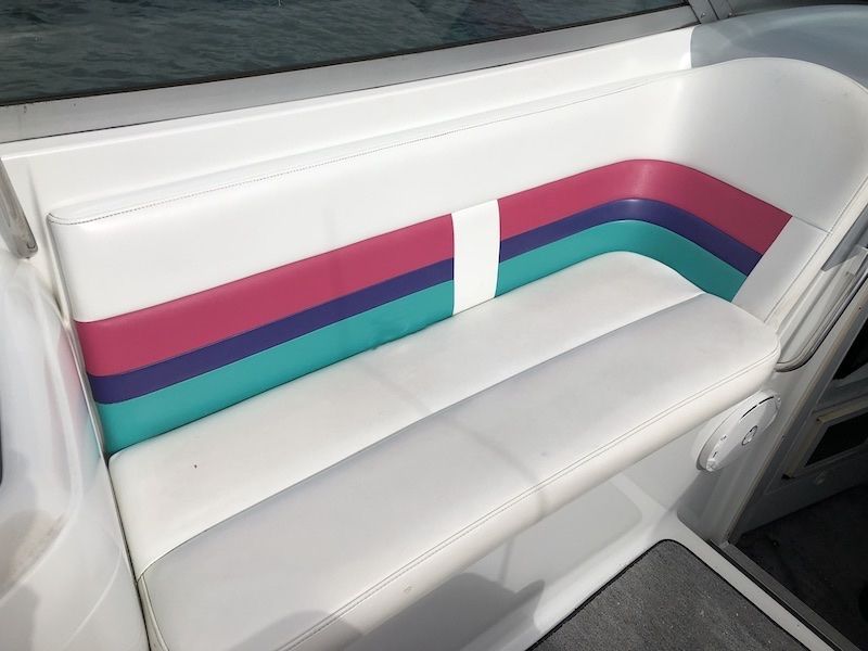

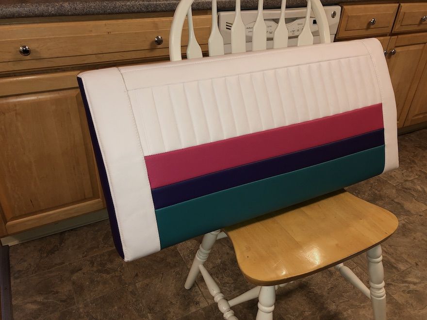

I also wanted to change-up the design a bit and use a white channeling vinyl in combination with the white. Here is a mock-up of the previous and new seating designs:
Continued on next post . . . .

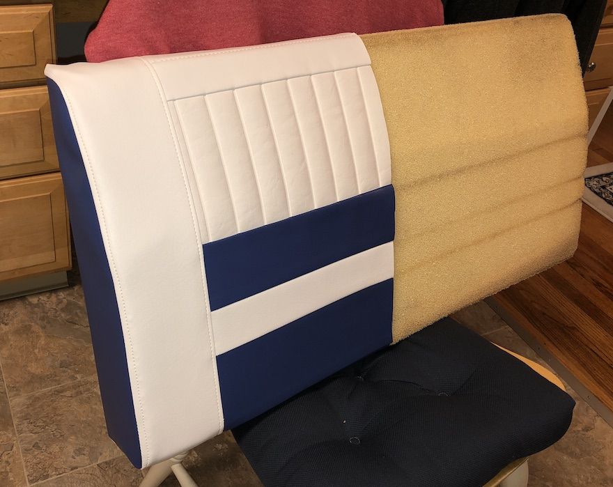

Continued from post #1 . . .
Here is the previous design:
Here is a rendering of my plan for using channeling fabric in the design:
I plan on having a 4-6" strip of channeling fabric in the upper part of the seat backs. I also plan on having 'boxed' ends of the seat backs with top stitching rather than the previous 'wrap-around' styling.
I have taken a few of the seats/coverings apart to get an idea of the stitching, etc. All of the vinyl has a 1/4" foam backing with scrim cloth (pretty much deteriorated after 23 years :) )
I also made a mock-up of the seat panels for practice (using some spare vinyl) to see what they would look like for real:

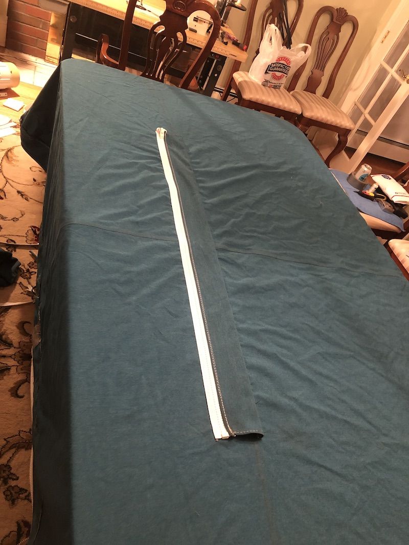

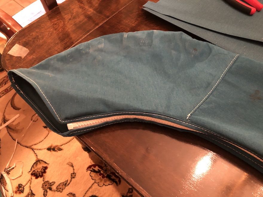

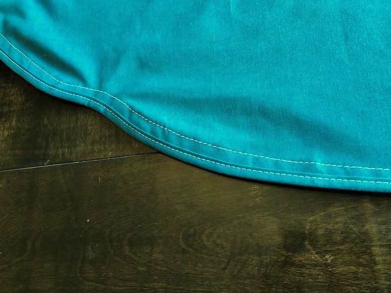

I am working on the canvas first, before diving into the vinyl work. The bimini to needs a new set of zippers. Most of the zippers are 48" YYK #10 . . . a few are a bit shorter, so I am starting with a 48" zipper and cutting it down and placing in stops.
I've done 4 zippers and am starting to notice a problem . . . I am getting an intermittent tension problem on the top stitch. It is fine for most of the 48" run, but along the way the bottom tension wins out and I am left with an extra length of top stitch that shows on the bottom (maybe about 4-5mm, 1/4"). This will proceed for about 10 stitches, then the tension will return to normal. I have tightened the top thread a bit, but it seems to keep happening.
Not sure if this is a tensioning problem or something else :thinking:
The needle is 135x17 (Nm160/23) and the thread is 'heavy' Tenara (138).

#6356
Thanks Guys,
I did find a couple of problems with the thread tensioning and the bobbin.
1) the bobbin spool seemed to be a bit warped, which made it turn with uneven tension in the bobbin.
2) the top thread tensioning disc got dislodged (somehow) and hung up on the little pin that the thread is supposed to loop around. So the net effect was less contact area on the thread for the tensioner. I didn't realize the issue until I looked at the tensioner closely.
I replaced the bobbin spool and reset the top thread tension. The latest zipper seemed to do fine. I am finding that the Tenara thread is a bit temperamental, especially when working with canvas (Sunbrella)
I am winding my own bobbins from the large spool of Tenara.

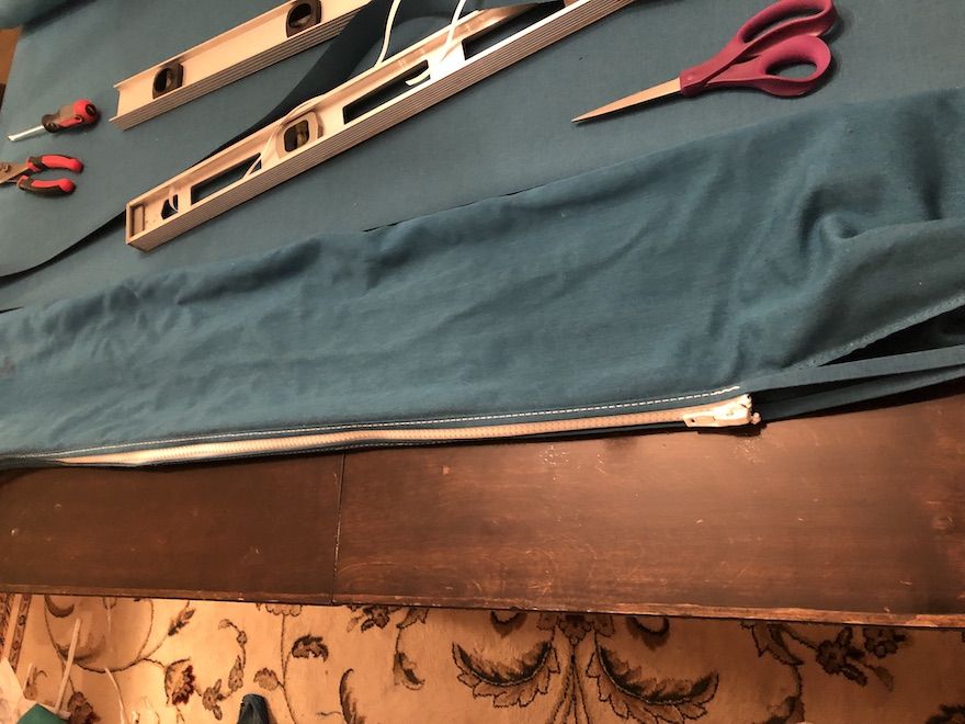

More canvas work. I finished the new zippers on the bimini and now am replacing the zippers on the bimini cover.
The edging on the cover pretty much came off with the old zippers. So, I am doing new edging along with the zippers.
One more zipper to go, then it is onto the upholstery. First thing there will be to make some new bases for the seats to replace the rotted ones.

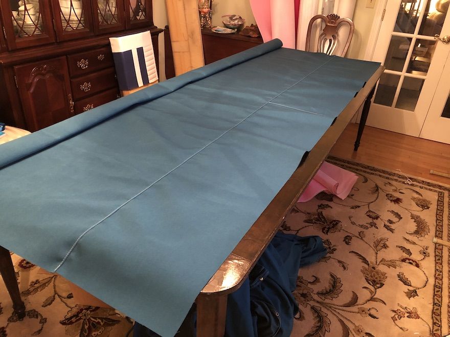

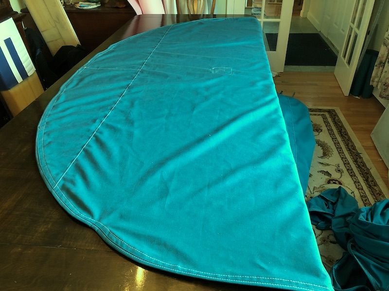

The canvas work is done . . .
I was able to get the 1" binding tape around the perimeter, although 1.5" would have been better

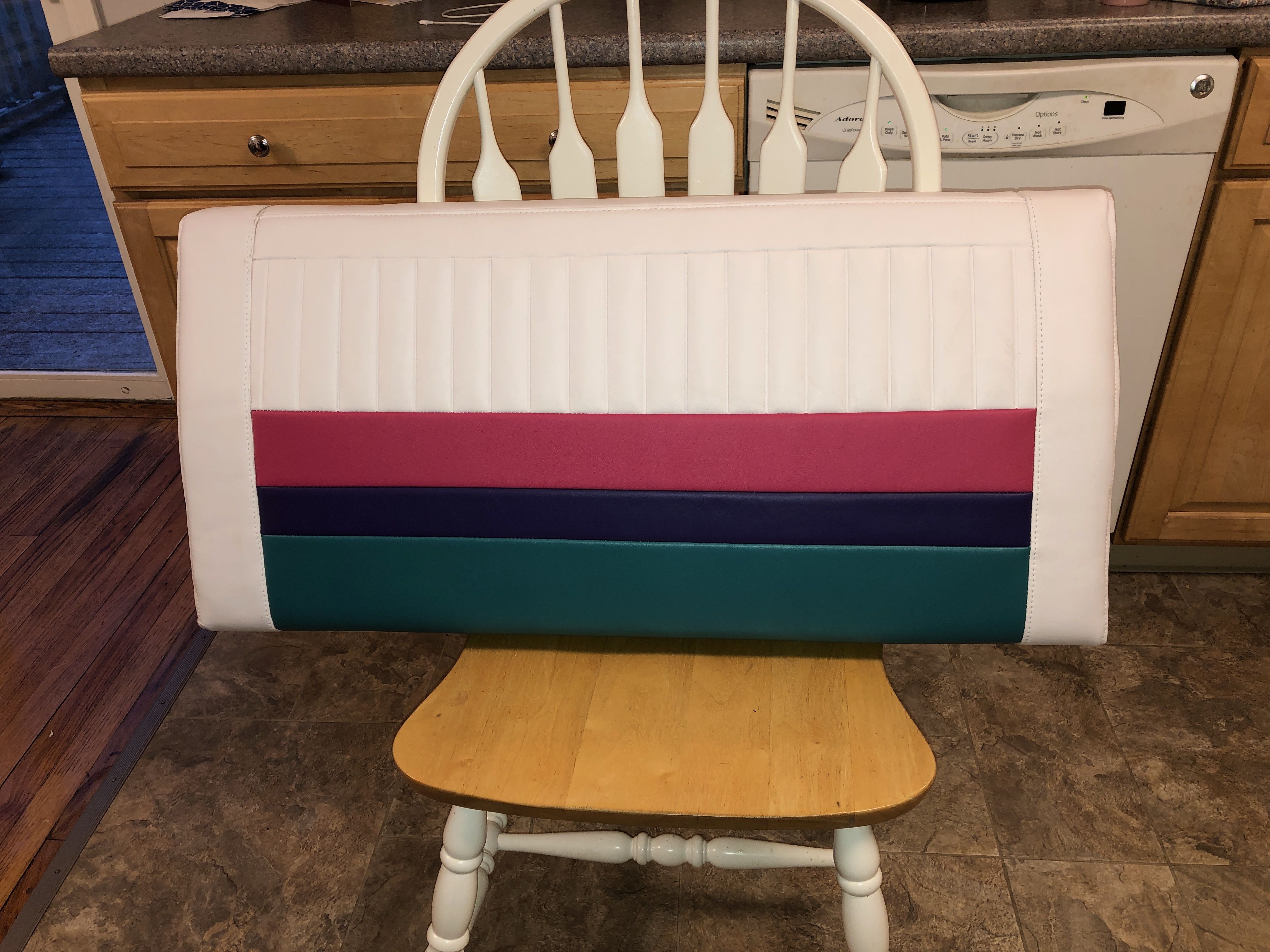

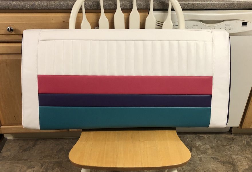

Here is my first attempt at the vinyl skins . . .
I had some trouble with the top stitching and the end pieces. So, this one might be just for practice :rolling_eyes:
I'll take the learnings from this skin to make some changes to the patterns and the stitching.
#6519
Here is my re-make of the previous skin.
I got the top stitching much better than the previous attempt. This one will be a keeper.

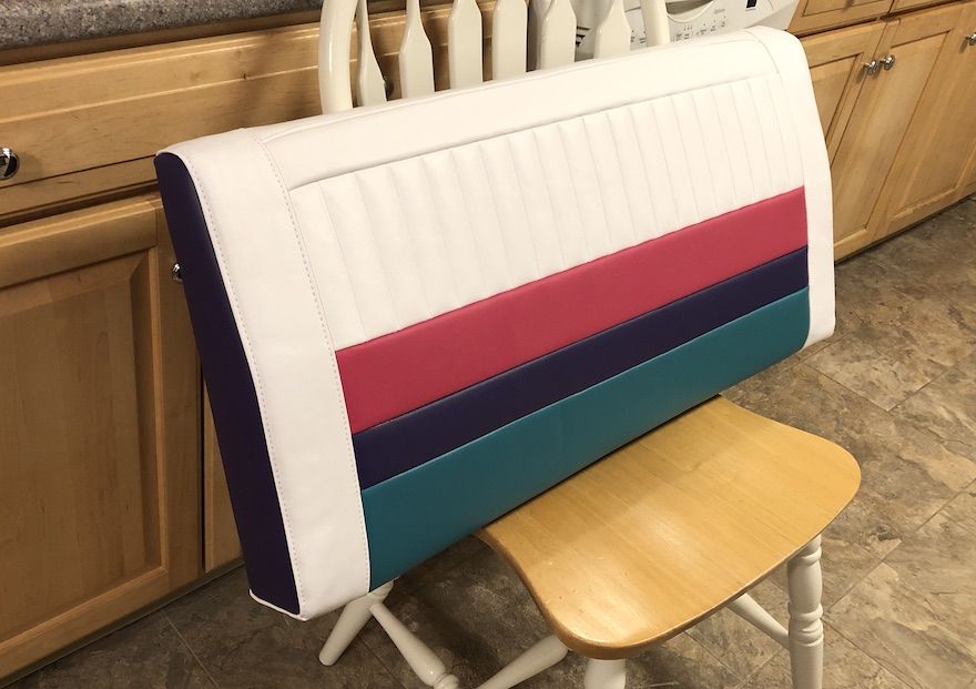

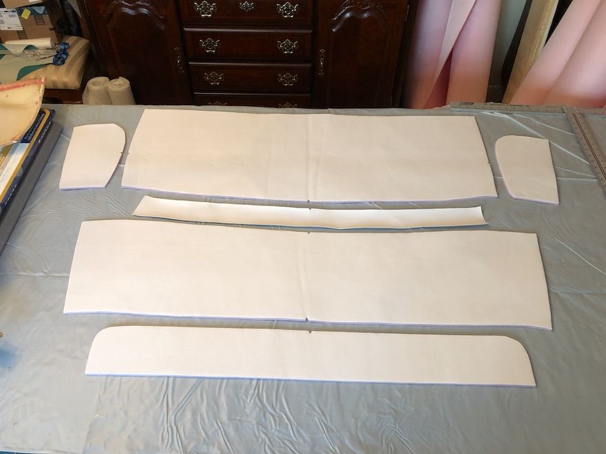

#6524

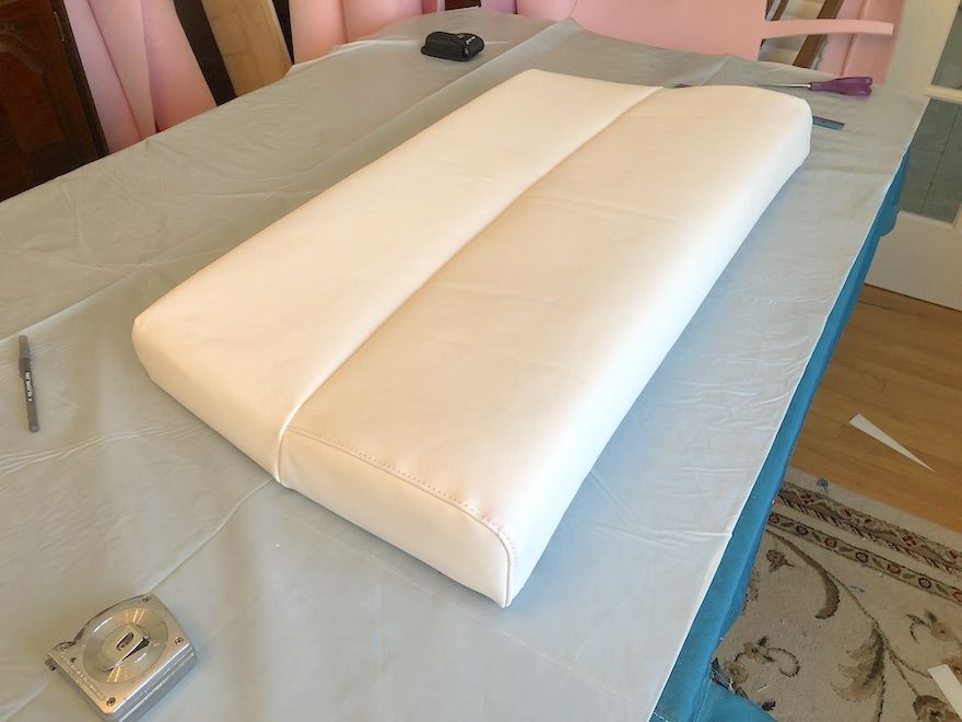

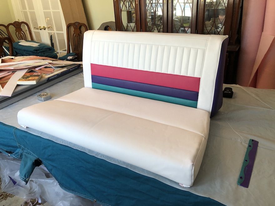

I got the matching base to the seat back that I made done . . .
Here are the pieces
IMG_3710 2.JPG (60.78 KiB) Viewed 74119 times
Here is the completed seat.
Here is the pair . . . Seat back & Base
I am still having trouble with the sharply curved areas. I tend to get a wrinkles or 2 in the seam.

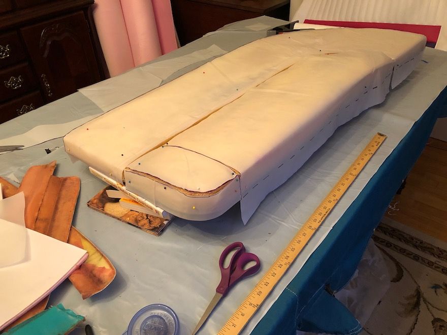

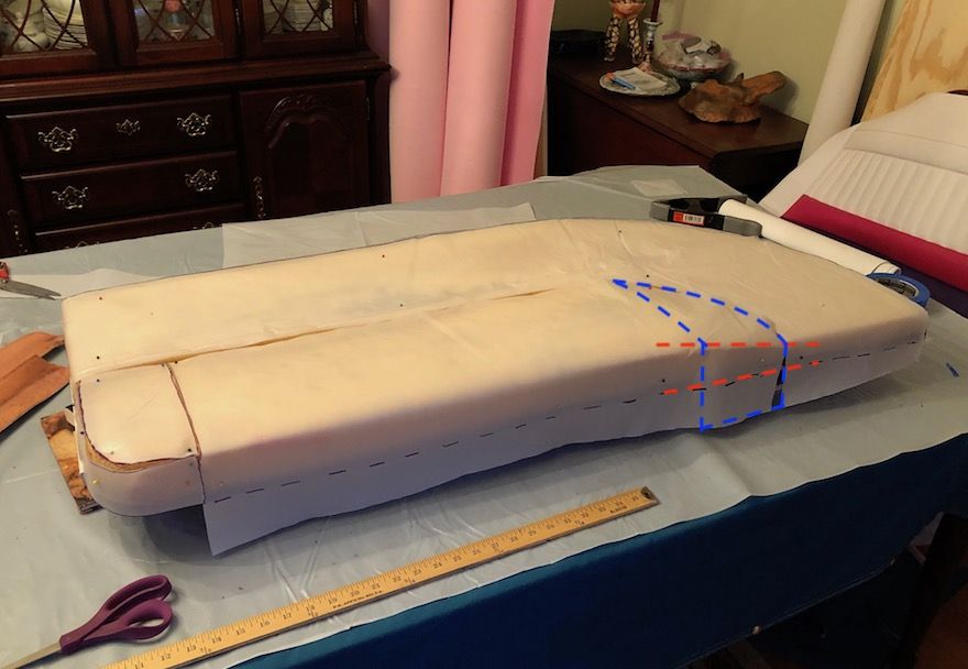

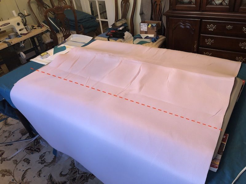

There are 4 seat bases to the main seating areas of the boat. I moved on to the second of the 4 and used the vinyl pieces from the old seat as templates for the new vinyl.
That approach did not work out and the resulting piece was unusable. So, I am now strictly using templates that I freshly make from the foam/bases directly, ignoring (for the most part) the old vinyl.

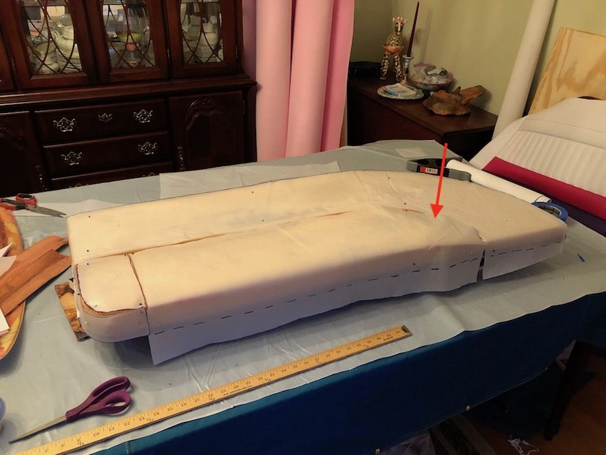

Here are a few pictures of using 6 mil plastic sheeting as the template material, mimicking the OEM patterns.
I did notice one area where the OEM pattern does not conform well to the contours of the foam. The boat manufacturer, obviously did some stretching of the vinyl to conform to the desired shape.
The red lines show the area where the foam changes shape along its leading edge. I plan on making a separate piece (shown in blue lines) to better accommodate the contour of the foam.
