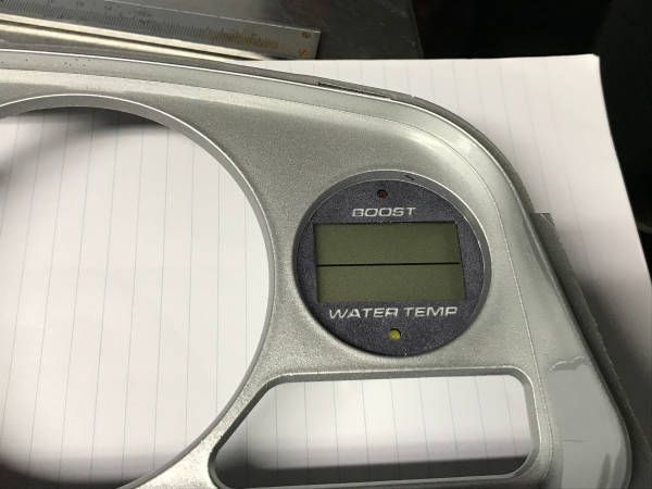

The dials with 9000 rpm tacho, fuel gauge is deleted and a digital one installed in the bottom of the cluster, engine temp gauge is removed. At the fuel and temp gauge i am now installing SPA dual digital gauges.
