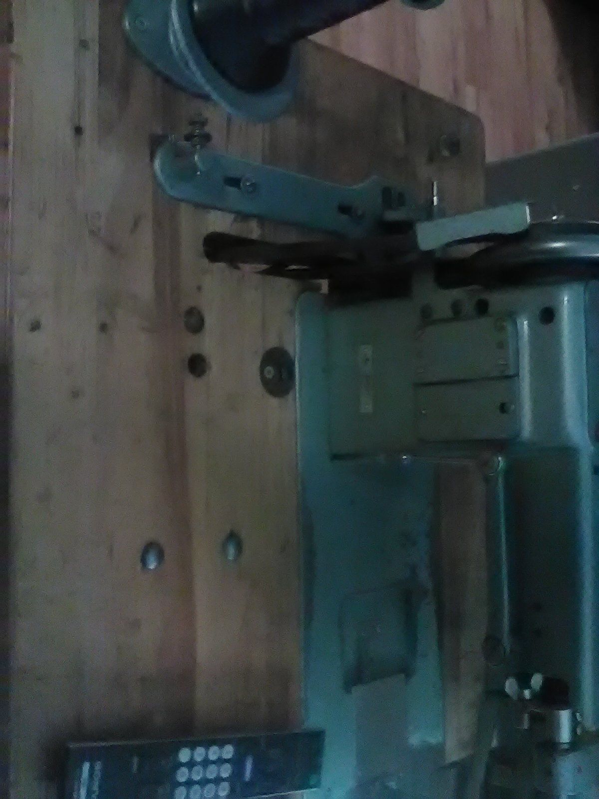

@MalcolmM Thats awesome! Can you post a picture of your knee lift conversion?

Take off the knee pad, rotate the rod back on itself so it's at the back of the oil pan and as far up, nearly touching the oil pan. Then attach the pittman rod to the end of the kneelifter rod (you need a second treddle). You now have a foot actuated presser foot which I find much more useful than a kneelifter.

That is genius!!
