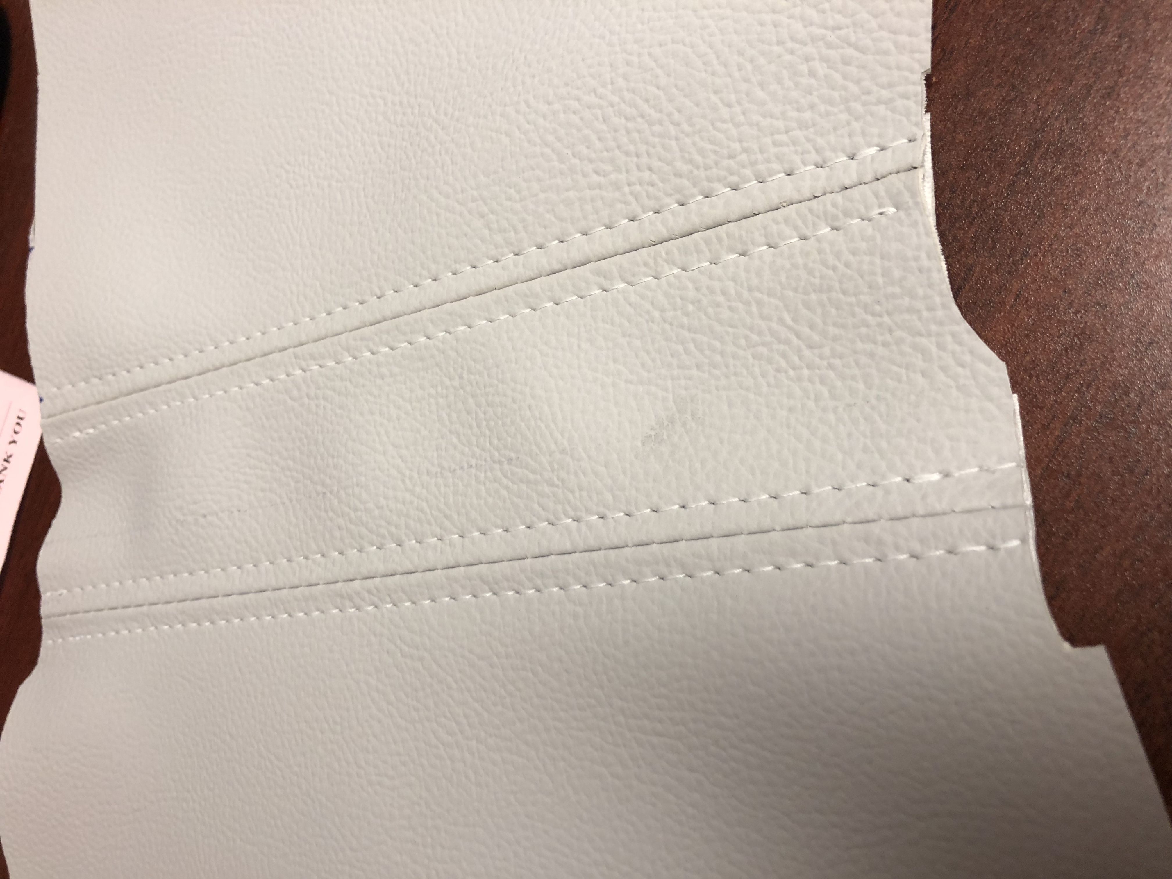

I am actually practicing same thing. Needle size definitely going to make difference. With 22/69 I had similar issues. Tension might be OK but hole is too big and it shows.
Picture from my excersize last night. #20 LR needle. Have 19 in R kind only, but I checked with both almost no difference. On my material LR makes better bortom stitch
I am using special feet with a guide
