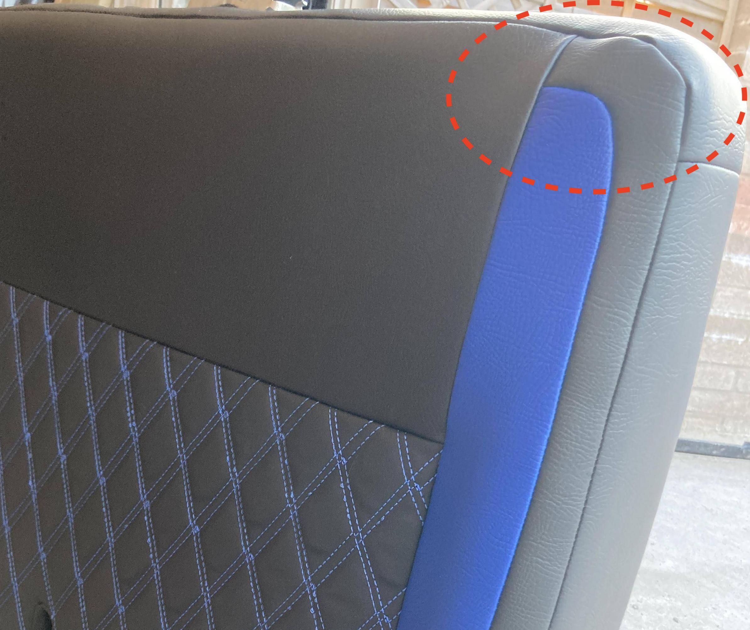

#15018
Well guys I think I’m getting better but more eyes may say different
So it’s taken me 10 hours to remove the backrest from the seat then destitch to make templates then sew it altogether to create the seat
Here’s a few pictures I’ll upload a few more once there back in the vehicle
LLeeT liked this
#15021
10 hours may be about right, but as you gain experience you will find methods to reduce the amount of time.
Additionally, more experience will get you making smoother corners and the overall appearance will be enhanced.
This corner for example . . .
It looks like you may not have cut enough relief notches in the seam allowance after stitching and therefore the seam allowance underneath the exposed vinyl is bunching up and distorting the curve. Also there are times when you may want to cut off most of the seam allowance to avoid excess material altogether.
Also, the smoother the curve's stitching, the smoother the appearance of the finished piece. All of these subtleties come with experience and knowing how to maneuver the curved pieces through the machine to get very smooth curves.

#15026
I totally understand what your saying, I have started putting in relief notches and I can see a difference and I now what you mean about sewing a good corner, if I do a corner and it’s not the best I’ll go back around
Not to bad tho considering the machine isn’t supposed to do this material
TedP liked this
#15029
