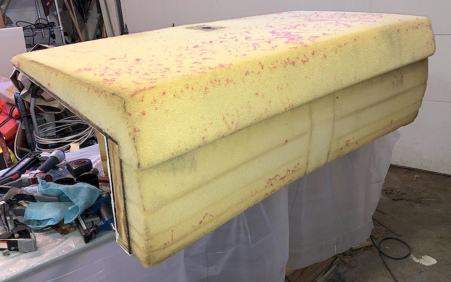

Working on the new backer boards for the seat bases . . .
1/2" Exterior Plywood with a homemade wood sealer.
These will take a few days to 'dry' and then I can apply the foam and vinyl skins.

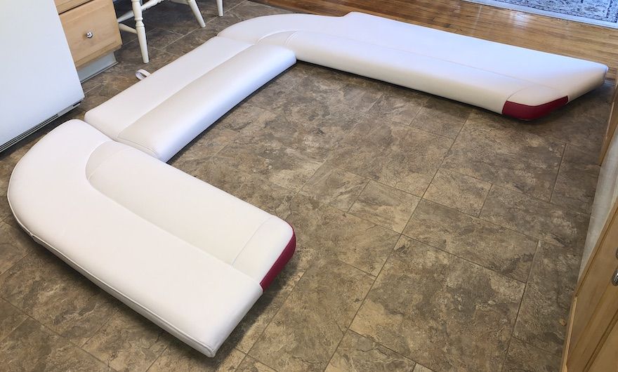

Here are the 3 sections of the bases for the U-shaped seating . . . done.
There is also the port side settee base, shown below.
In total I have 5 pieces done out of a total of 13 pieces.
