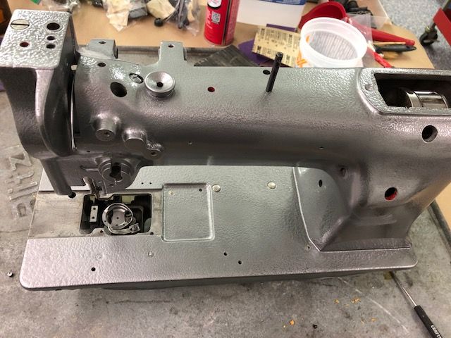

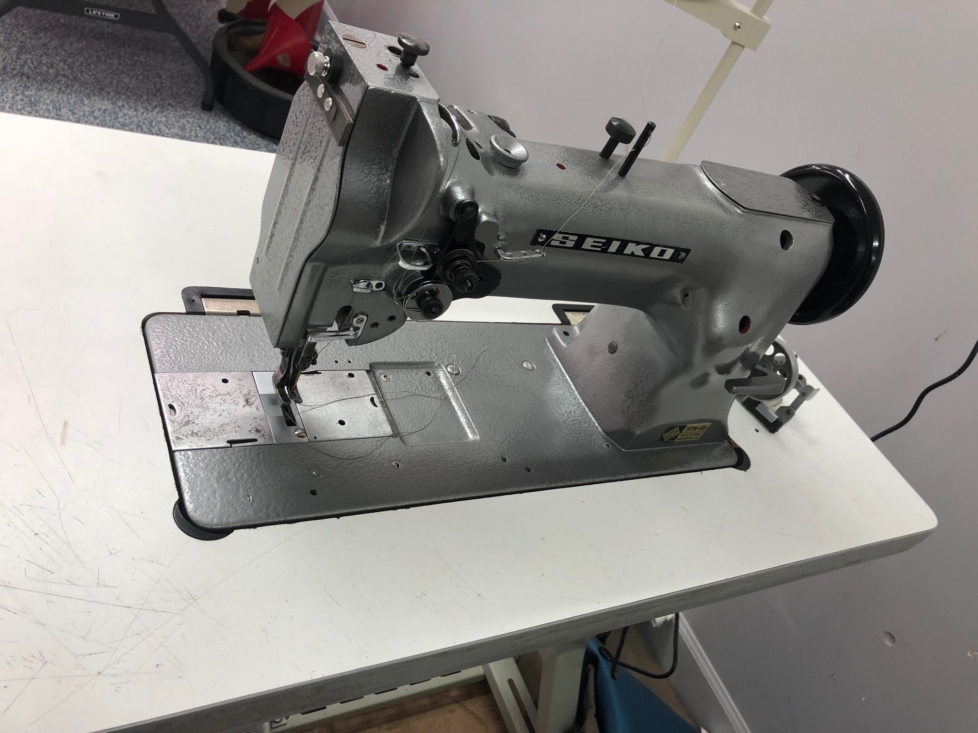

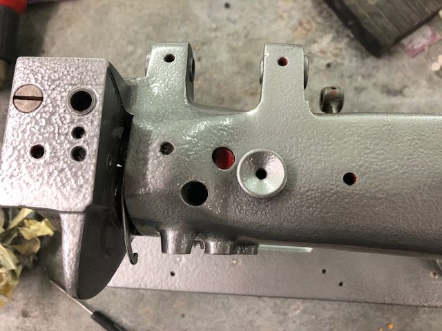

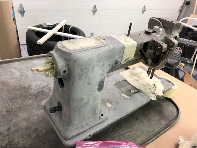

I decided to do some service and paint job to Seiko I got. Results so far :)
Going to replace some small parts and see if I can make it sew again

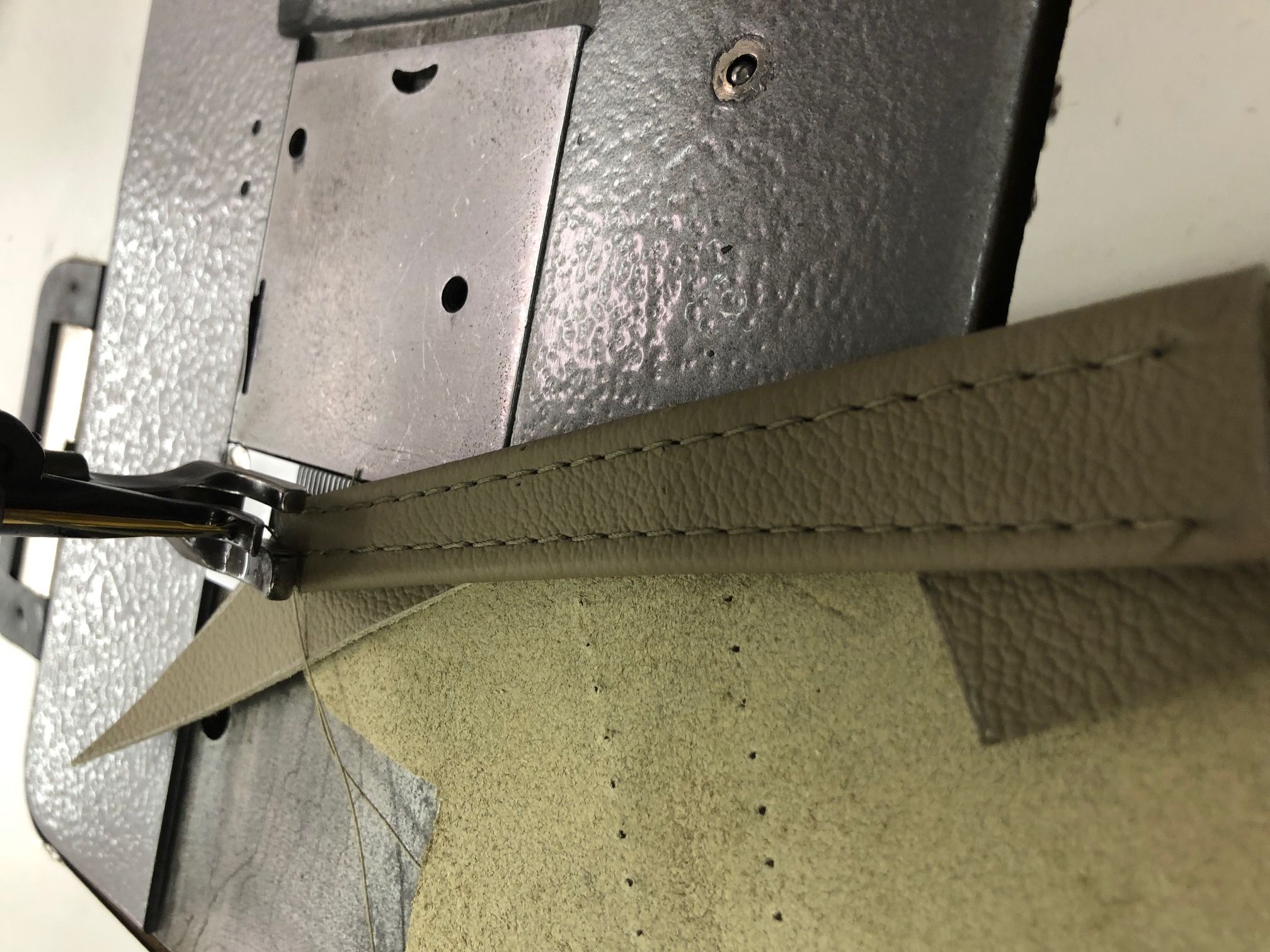

#4383
Finally alive. Every adjustment that could be misadjusted - was screwed up. Got it to sew and it runs! Any speed, 4-6 layers of leather or as much as I can put under feet - no problem.
Still need to do some tiny adjustments to make reverse stitch just perfect, other then that - it's running good now.
By ajnegus

@ajnegus You don't have to go through machine like I did, you can buy it dialed in. Right now I will be selling one of my machines, either PFAFF 1245 or this Seiko, one have to go since I don't need 2. Not sure which one to keep though

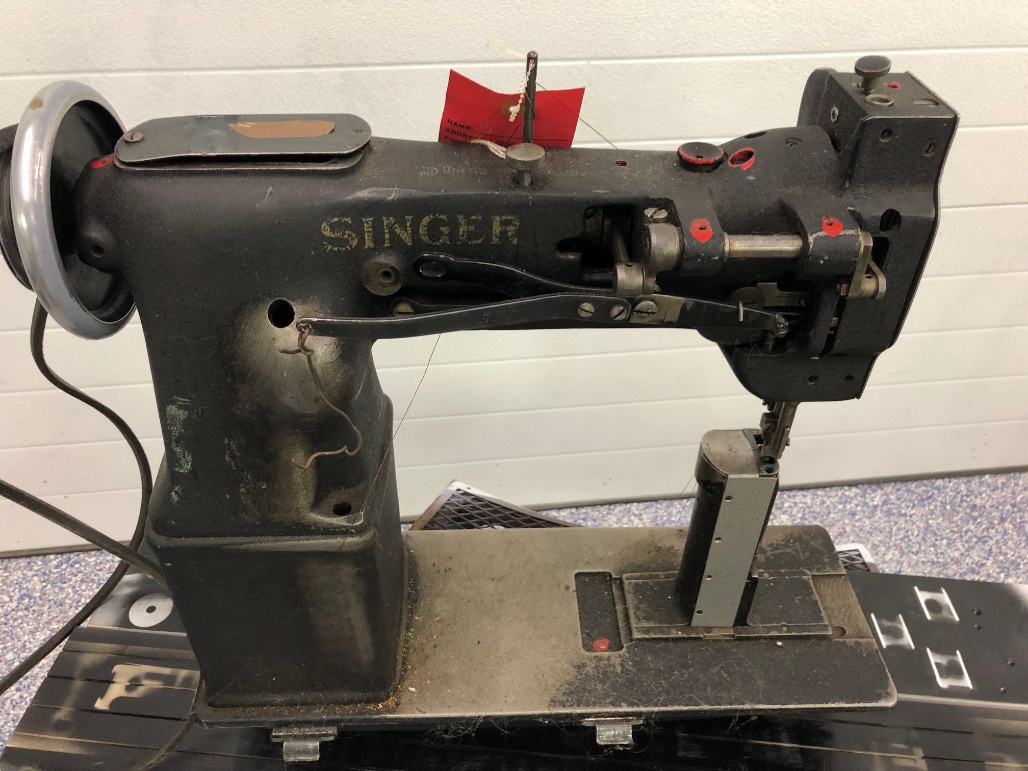

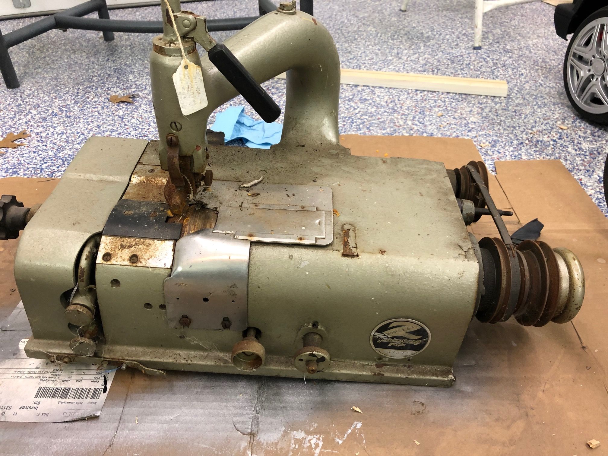

Machines now following me. Just bought 2 more, was very good deal, can't skip. I wanted skiver but didn't want to pay for it. And machine was always on my mind to do stuff like headrests. Guy had both and more.. Skiver already apart, will go through as it's got rust and some parts were seized. So good cleaning/lube and paint in order. Machine just need to be cleaned and adjusted.

Pays0n-UK wrote:That singer post bed looks interesting. Are you planning using it or was a two for one with the skiver?
It was at very good price to not take it. I always thought about something like this to do headrests. Having trouble sewing them on flat bed machine. I didn't plan on buying post bed but for the price it was "why not" so I got it. Not sure how much I will use it but I will make it work and try doing those headrests and see how it works. Maybe I will realize this is what I really need as 1 machine.
Not this one (as it doesn't have reverse) but maybe another post bed machine with "flat" adapter can be all needed. Will see.
By Pays0n-UK
#4444
I have one with the wheel feed but I have seen your type with a stationary presser foot as well. I can’t see from the picture what yours has got. Some of these machines have trimming attachments near the presser foot as well. Anyway, I had never tried one of these before but was pretty happy with it on a project to sew a thick wool hat and it really allowed good access to the tight areas like around the headband which a straight stitch machine would struggle with. I also used it to sew a really thin bit of synthetic material for a kids costume and it didn’t like that. Too thin and I think I would need to adjust the height of the needle bar up a bit or the feed wheel down which I haven’t figured out how to do yet. I found a pdf of the manual for your type of machine I think if it’s a 168 series if you need it? Let me know if so. What sub class is it on the little brass plaque? Maybe 168-k-104 or something?
#4445
It's 168w101, Essentially the same as Singer 111 but with a post. It's a walking foot machine, just like Seiko on top, I bet lots of the same parts.
It's definitely for heavier stuff, I know people using up to 207 threaad with those.
By Pays0n-UK
#4447
Thanks great if it’s a walking foot one. I forgot to say, I agree that the no reverse is a bit annoying on these machines. In a table they are going for a fair bit of money in UK on ebay. Like $700.
I wanted to say that there seem to be a lot of Dürkopp-Adler used upholstery machines for sale at the moment in UK. The N291. For UK based people this is relevant to the thread topic. I wonder if some big setee (sofa) factory went out of business or something? A local supplier near me had around 10 of them! I got a good cash price on one for an auto upholstery job I am doing. They aren’t super cheap, like 1000£-2000£ but really geared for upholstery. I was put off by the programmable stitch controller for factory use as well as the necessity to use an air compressor for the foot lift. All this stuff just seemed like more to go wrong and especially to go wrong and be far out of my ability to sort out myself. In the end I was desperate and no older more straight forward machines like Pfaff were around or at least only weaker, knackered old ones. I went for it in the end and despite the steep learning curve and some trouble with the tensioning and auto thread cut feature not working (despite a trip back to the supplier for adjustment by the engineer), it has been a good machine to use. It is the heaviest machine I have ever experienced! I can’t move it in my own and you can’t even just take the head off for all the air lines, oil lines and computer control cables... That being said it is a really top quality German specialised machine which there seems to be a glut of right now in UK so maybe other people can take advantage of this and get one for a good price as well. Another thing though is the cost of parts even bobbins or presser feet are really expensive. Even Chinese’y ones are expensive. This has to be factored in to any decision I guess. I’m not sure about compatibility with other makers machines presser feet. Does anyone know about this? It would be great if there was a brother or seiko or juki machine that uses the same feet. Here are some links to some on ebay for example:

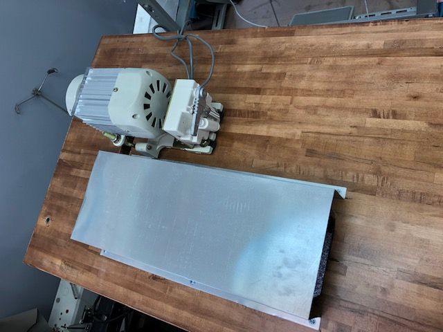

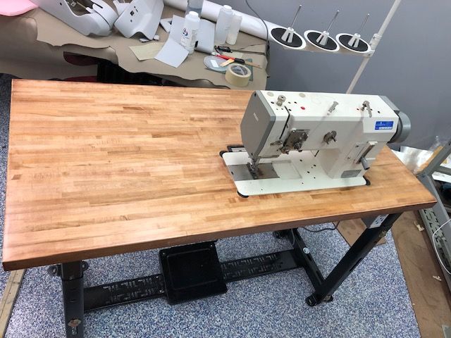

My "sewing machine table" project is completed now! It's little bit too much and I wouldn't do it again but I love end result.
Had to make my own aluminum pan, installed better motor, 1100W with needle positioner and 24V for knee lift (might add that too).
My other machine (Seiko above) is for sale in St. Louis complete with table/servo if anyone looking.
