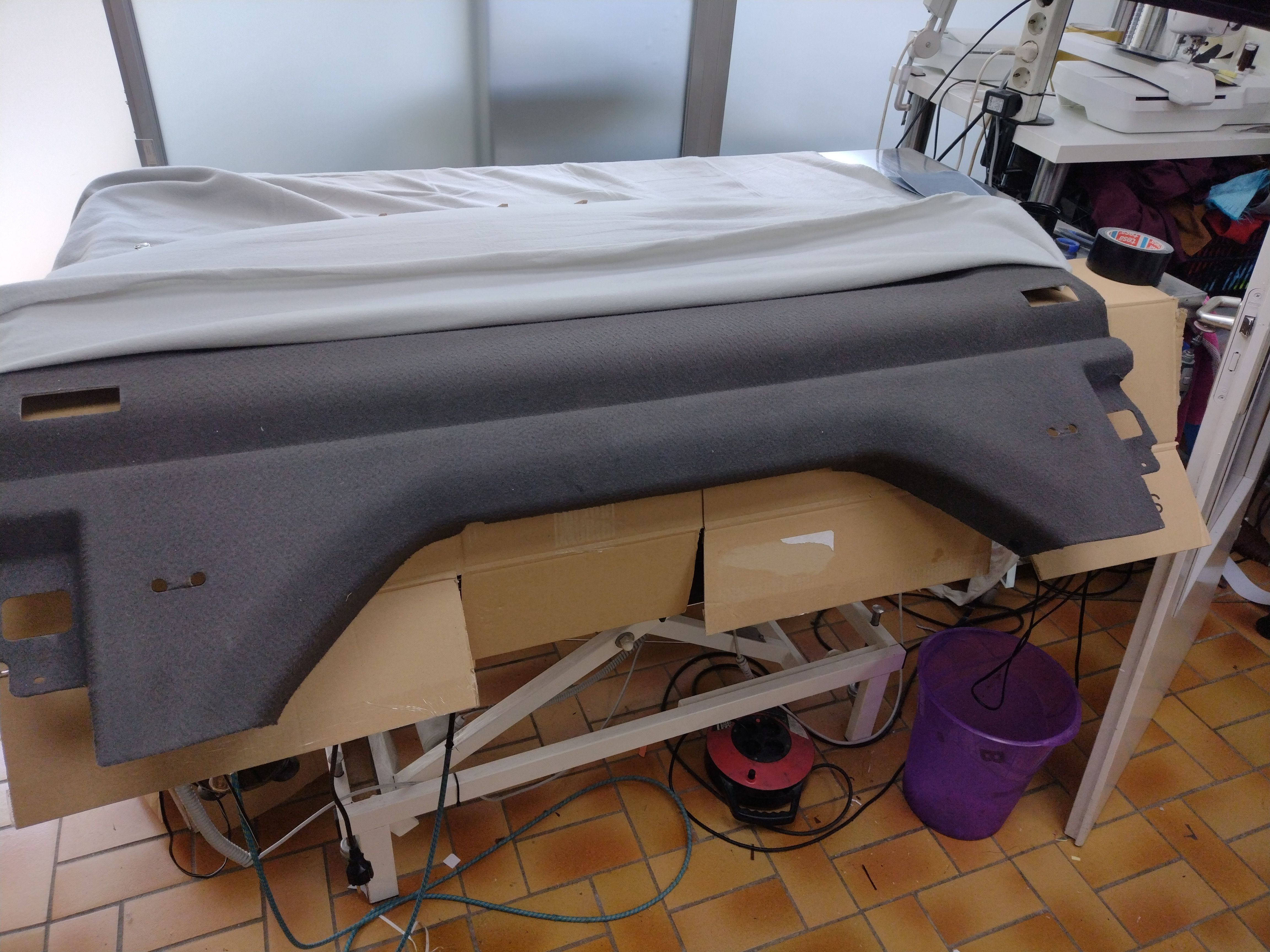

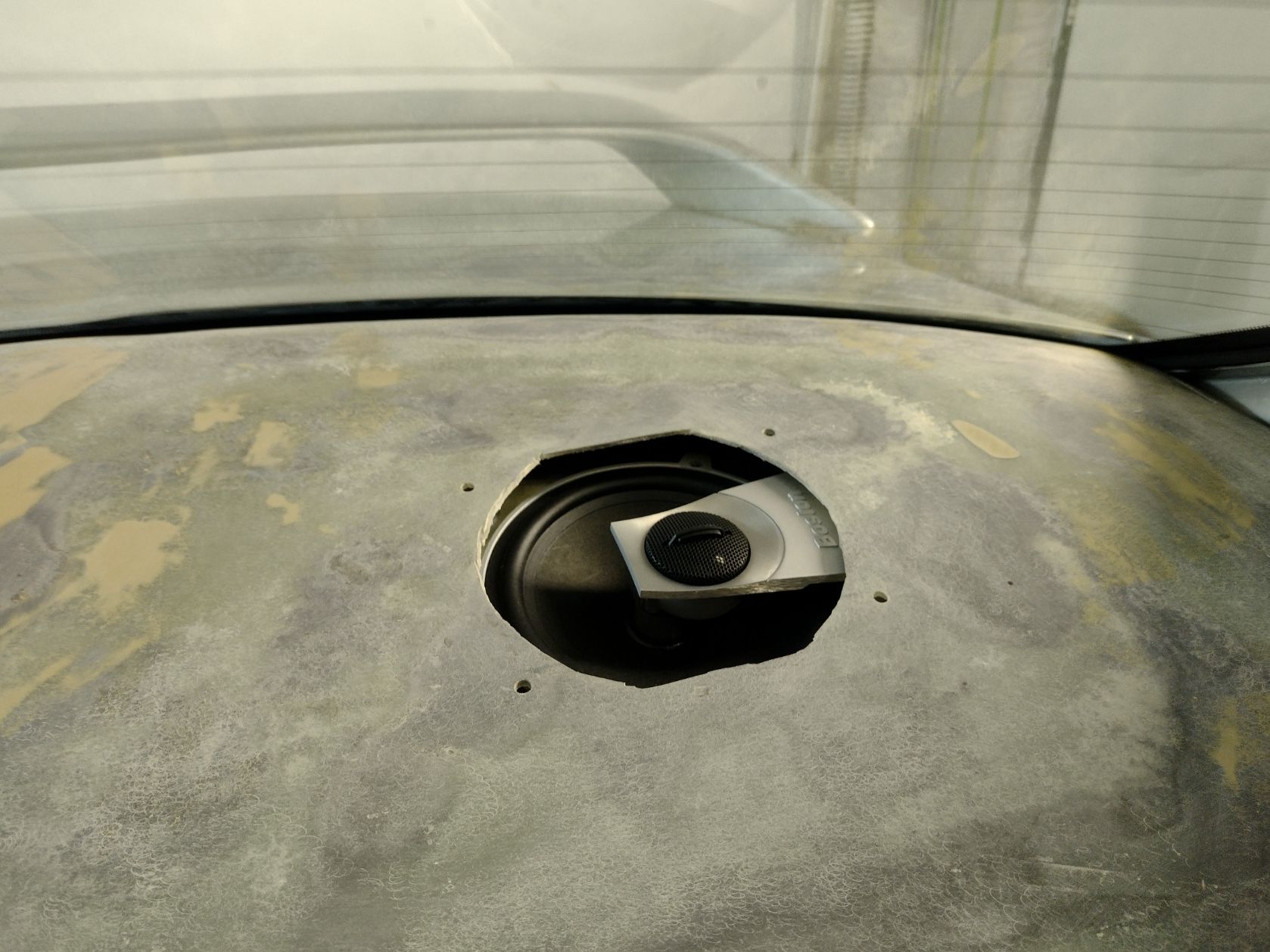

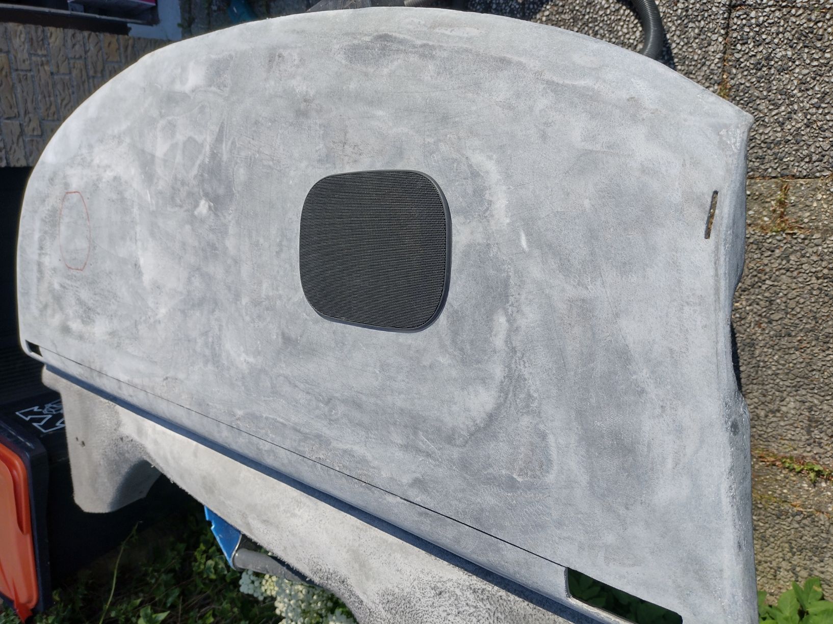

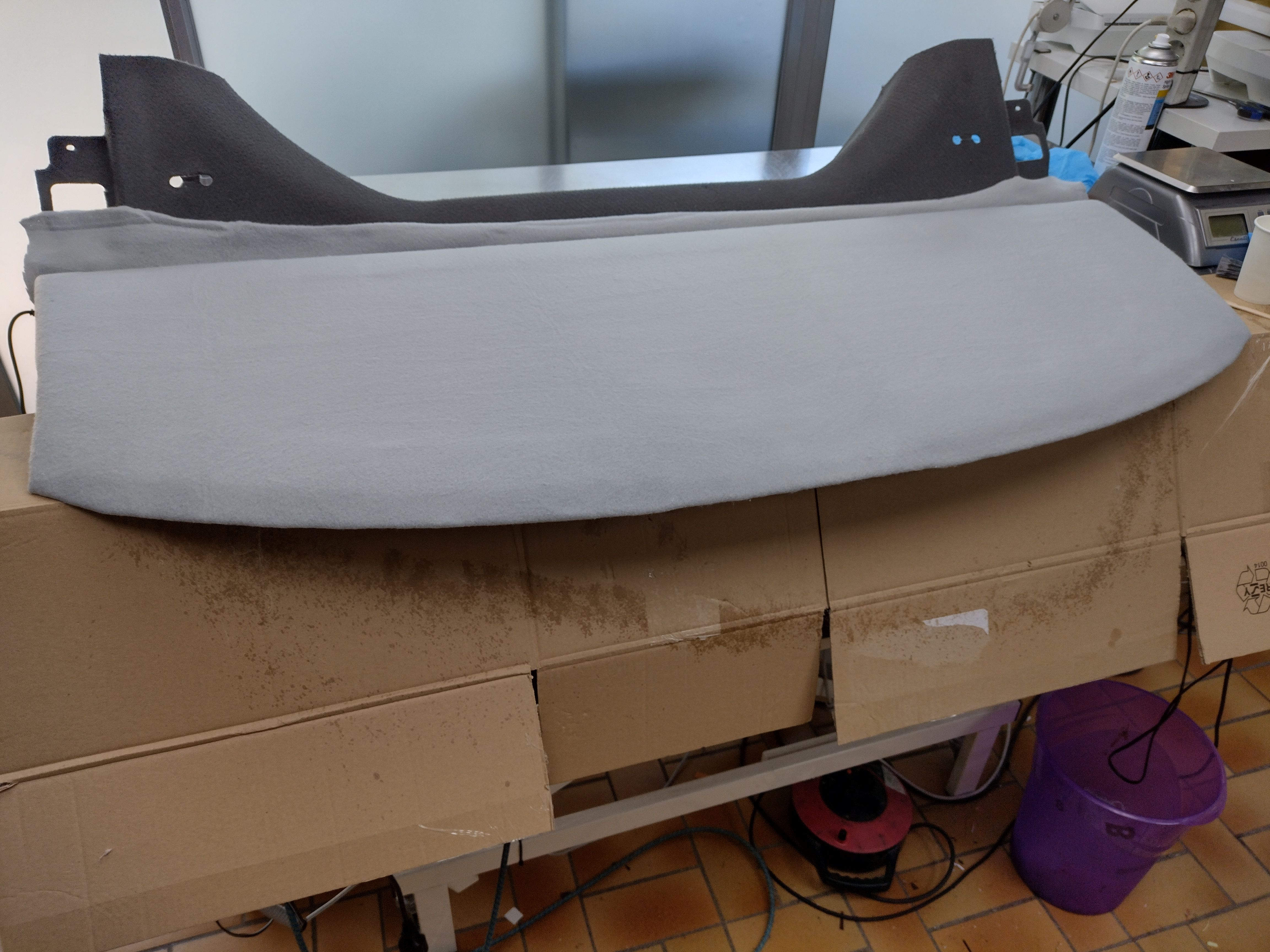

The speakers wont be installed in the rear doors, but in the rear deck. I have wrapped fleece around the rear deck part, and with fibre glass and epoxy made a new smooth surface. Since the third brake light is in the rear spoiler and it not allowed to have 2 third brake lights i have removed the one on the rear deck.

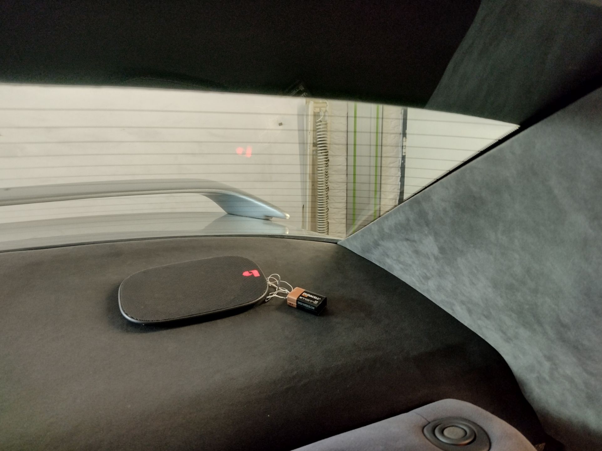

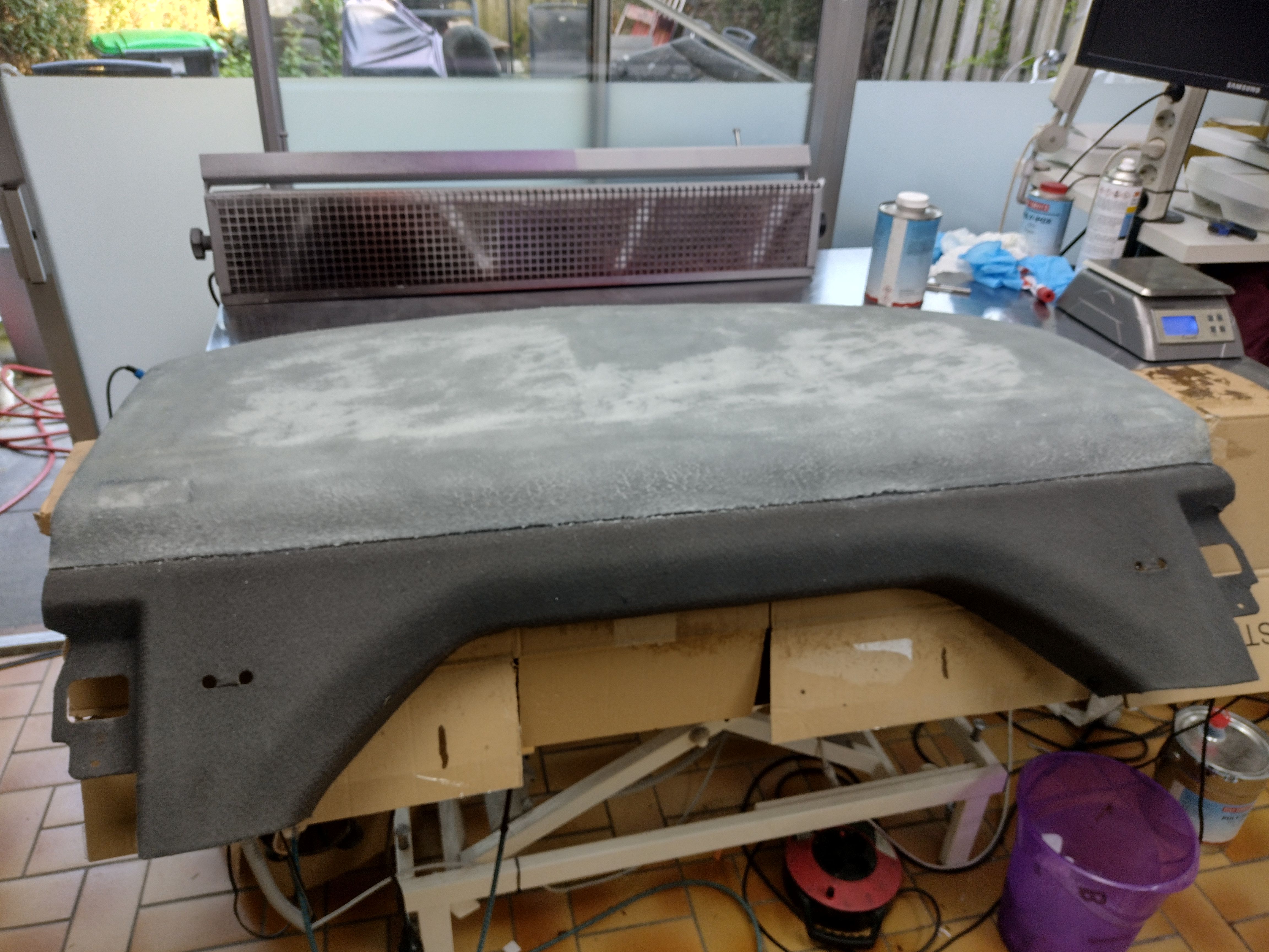

I am not happy with the 3M glue, it does not work very well with this fabric and epoxy surface. I got an ugly line just behind the read rest, so i will have to do this one again. A different glue is ordered and should arrive soon.

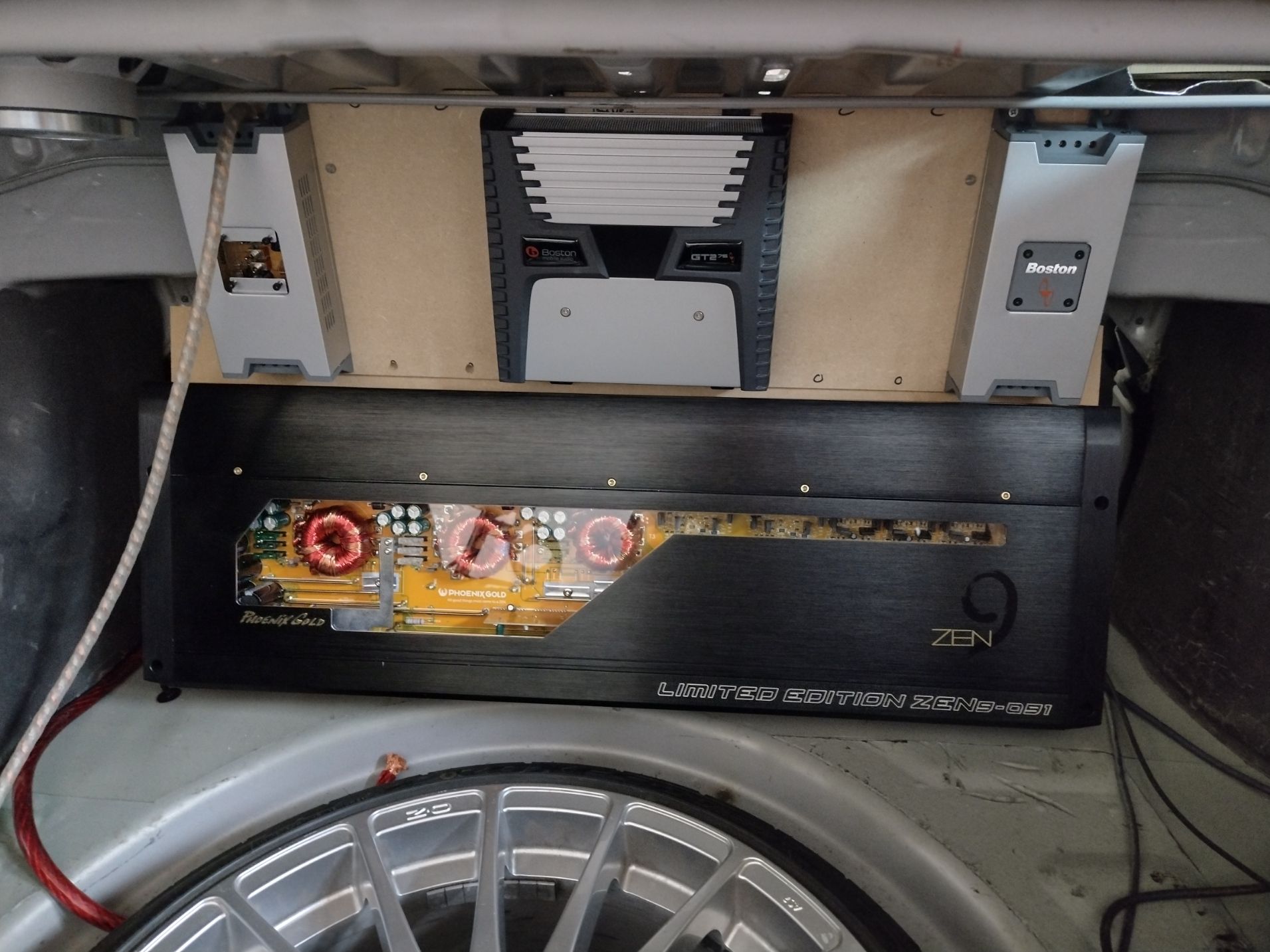

#17203
The new amp, a 9 channel Phoenix Gold Zen 9 limited edition, and a Boston 2 channel, gives 11 amplified channels in total for the surround system.
