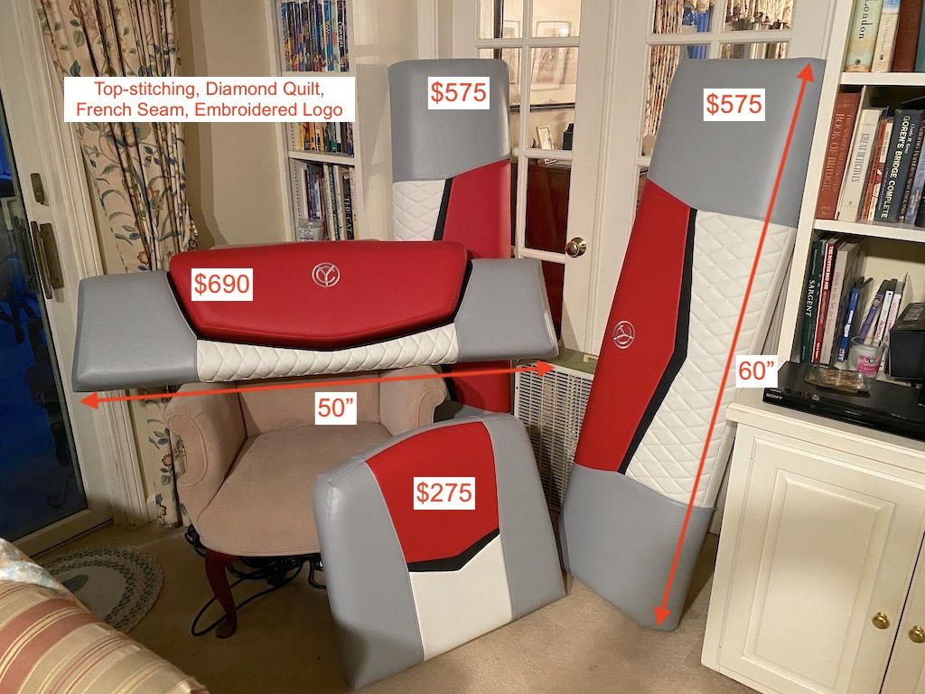

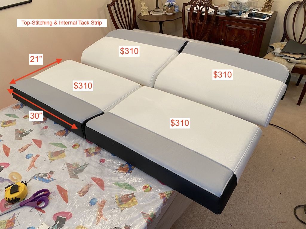

If I did take this sort of work on for a business, and used the spreadsheet estimating guide that I worked up, my pricing might look something like this for the stuff I have been doing. . .
These might be a bit low . . . or maybe a bit high in some instances.

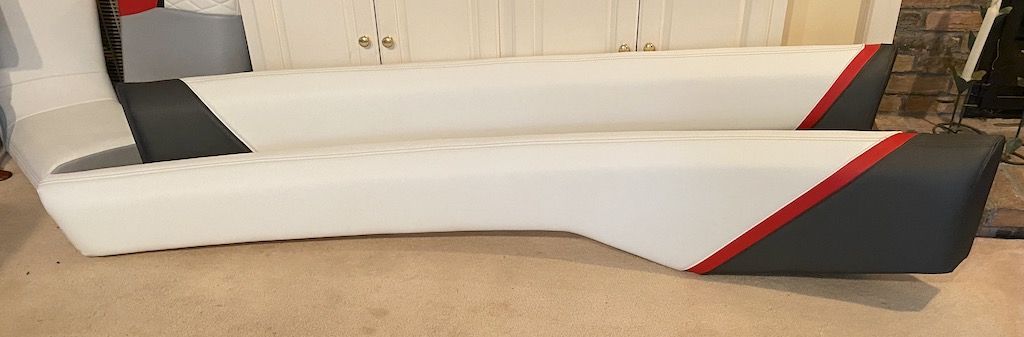

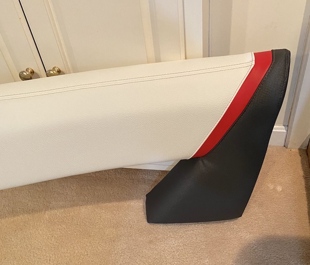

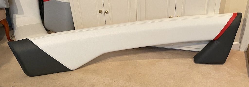

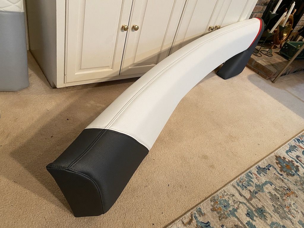

Here is the latest piece . . . it is a side cushion that goes in the bow of the boat.
IMG_2820 2.JPG (47.78 KiB) Viewed 13257 times
IMG_2822 2.JPG (149.23 KiB) Viewed 13257 times
I added the red stripe to the pattern, since I have added red elsewhere in the upholstery.
This one took all day (and then some) to make. More difficult than I was expecting. I am getting better at the french seams, combined with top-stitching on an adjoining panel. I made sure to remove as much bulk to the seam area as possible and to add an extra 'tab' of material at the end of the french seam to help the material 'roll under' for the intersecting top-stitching.

I finished the other bow side cushion . . . Same sort of thing as the previous side cushion. I added the red stripe.

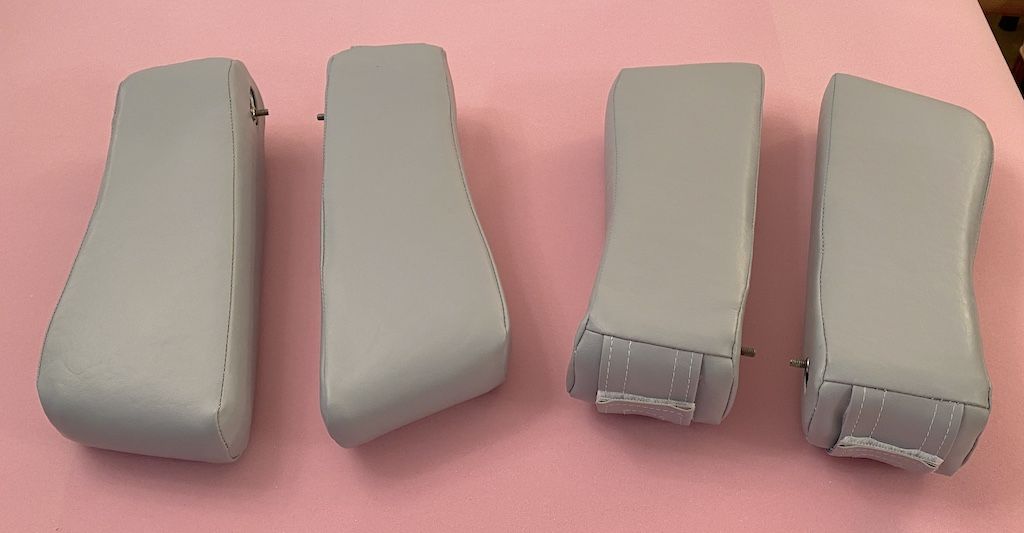

I am onto the helm seats which are really complex. 2 armrests, a flip-up portion of the base and then the normal base cushion and backrest. So, far I got the armrests done. They took about 1-1/2 days.

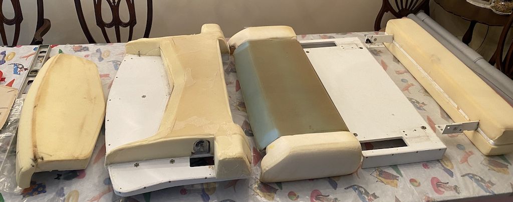

Here are the various pieces of the helm seats, less a few bits and pieces. It took quite some time to dis-assemble. More staples than I had ever seen on a boat seat.
There are 2 of these seats. . . 6 covers each. I've already done the 2 armrests.
My plan is to do the covers over the course of about 4-5 days.

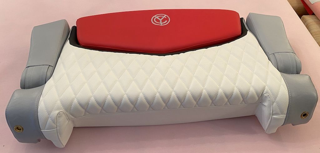

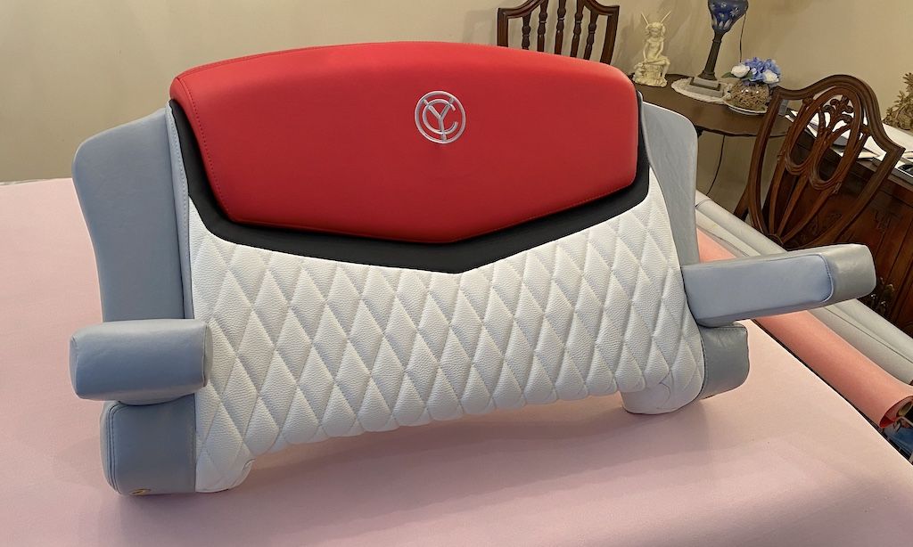

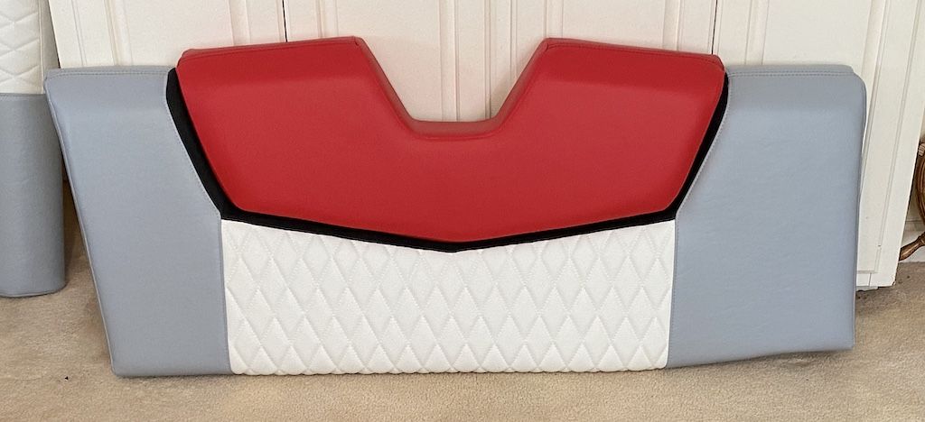

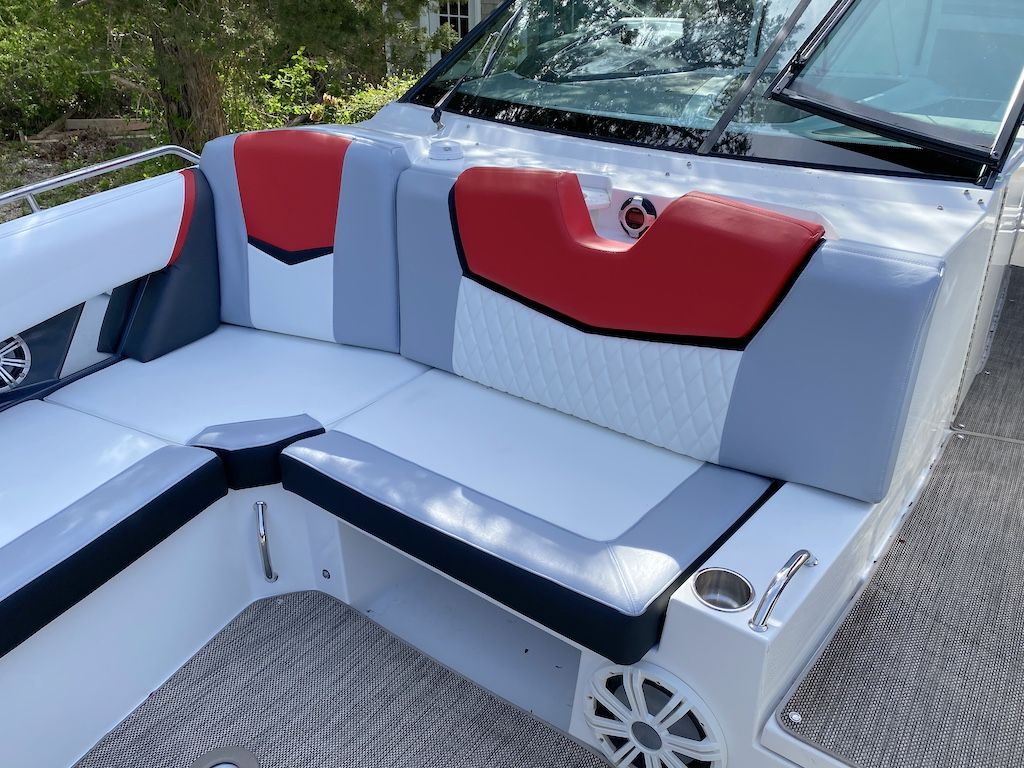

I got 1 helm seat backrest done . . .
IMG_2950 2.JPG (86.31 KiB) Viewed 12701 times

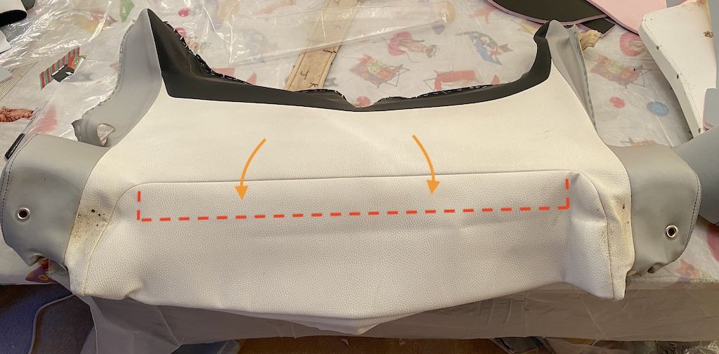

I altered the original pattern (as shown below) so that the diamond quilt would wrap around the bottom a couple of inches, making similar to the other seats in the boat. The original pattern would have the diamond panel stop right at the bottom of the backrest and a visible seam.
The alteration has a bit of ugliness underneath (first picture), but it won't really be visible when the backrest is in its upright position.

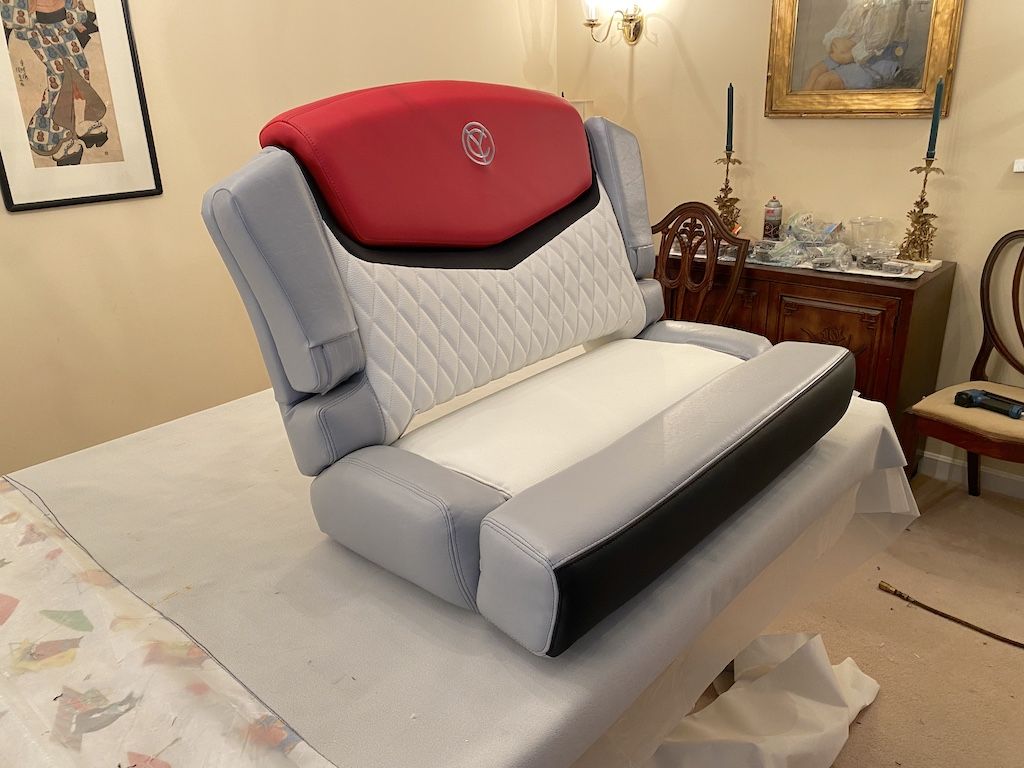

I got the seats all sewn and have put one of the two helm seats together. . . . lots of mechanical assembly.

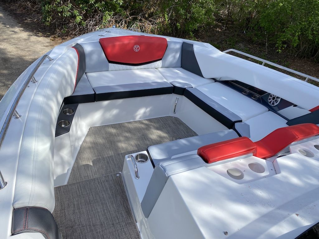

The seats are going in. I have the bow section done and will be moving to the mid-section of the boat soon.
The stern section may take a bit longer as there is an electrical issue with the actuator that converts the back-to-back seat into a sunpad.
