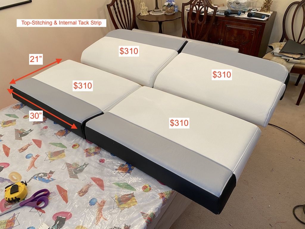

If I did take this sort of work on for a business, and used the spreadsheet estimating guide that I worked up, my pricing might look something like this for the stuff I have been doing. . .
These might be a bit low . . . or maybe a bit high in some instances.

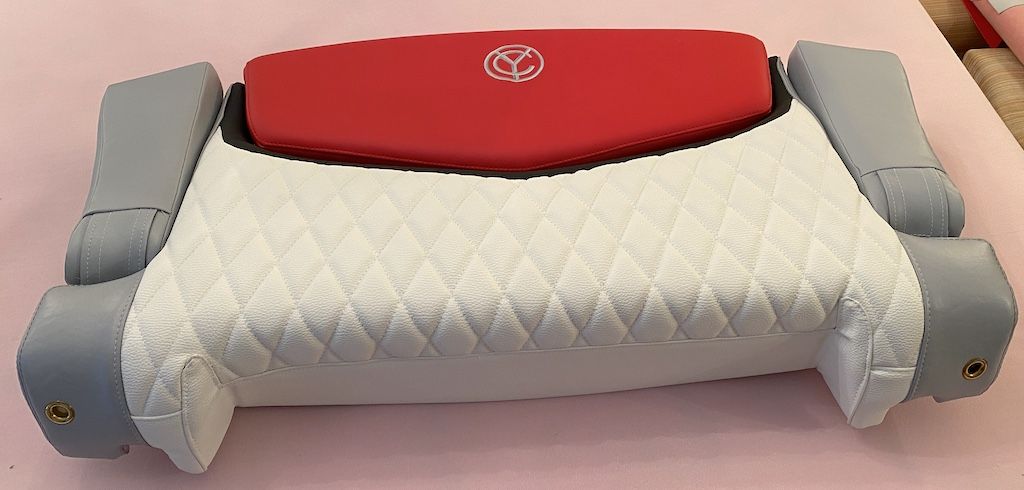

I got 1 helm seat backrest done . . .
IMG_2950 2.JPG (86.31 KiB) Viewed 12584 times
I altered the original pattern (as shown below) so that the diamond quilt would wrap around the bottom a couple of inches, making similar to the other seats in the boat. The original pattern would have the diamond panel stop right at the bottom of the backrest and a visible seam.
The alteration has a bit of ugliness underneath (first picture), but it won't really be visible when the backrest is in its upright position.
