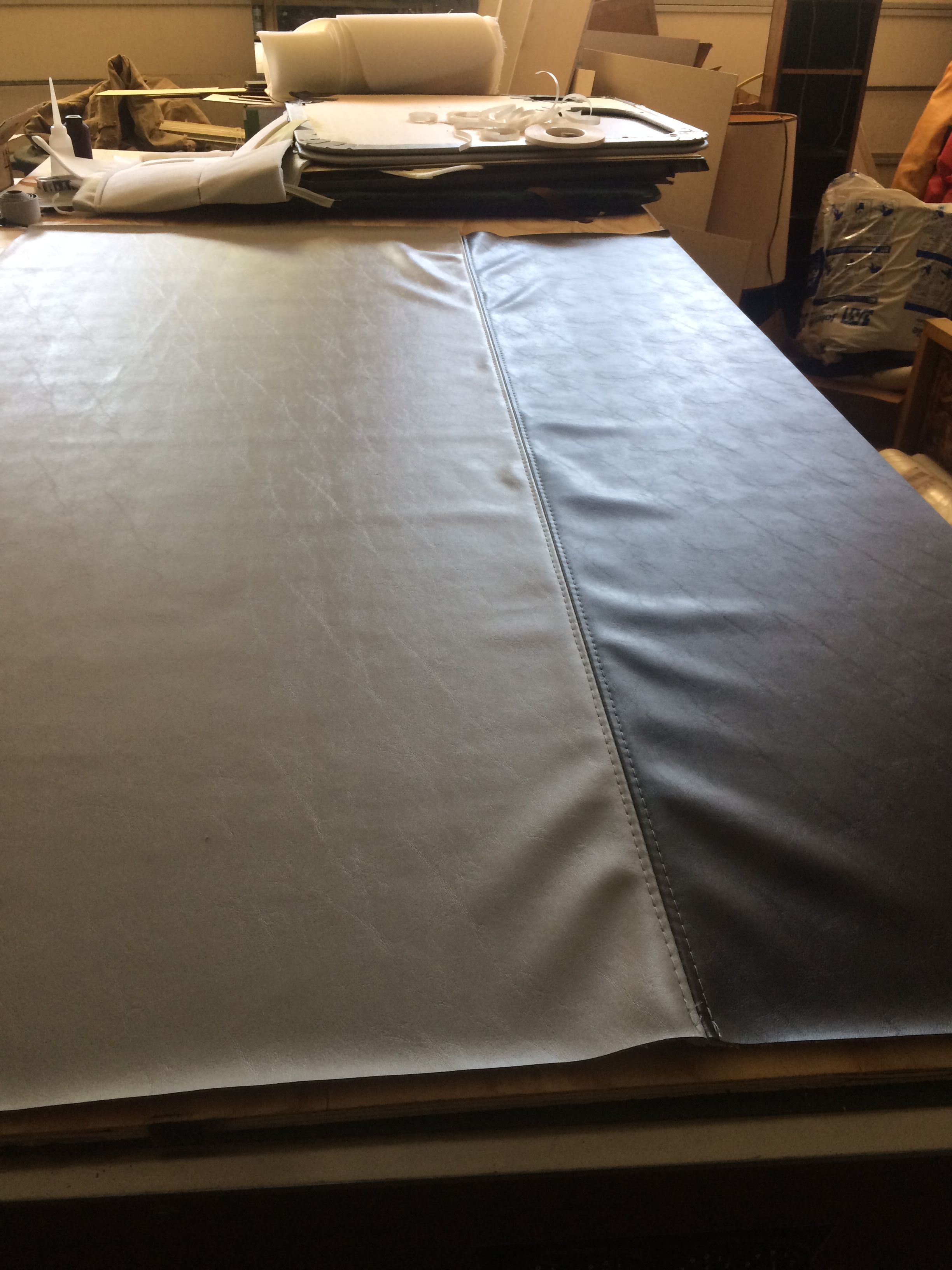

After tweaking and testing with the machine for awhile I went ahead and stitched another panel. It has definitely improved from where it was. I'm wondering now if just the fact of having thread through the vinyl and the cloth backer on the seam is enough to make it pull together slightly. Basically it looks like to me the ends are trying to get drawn into the middle. All of my tensions on everything are as low as I can possible make them and the machine still sew. Getting these wrinkles out when going to the panel shouldn't be an issue and it looks worse than what it really is.

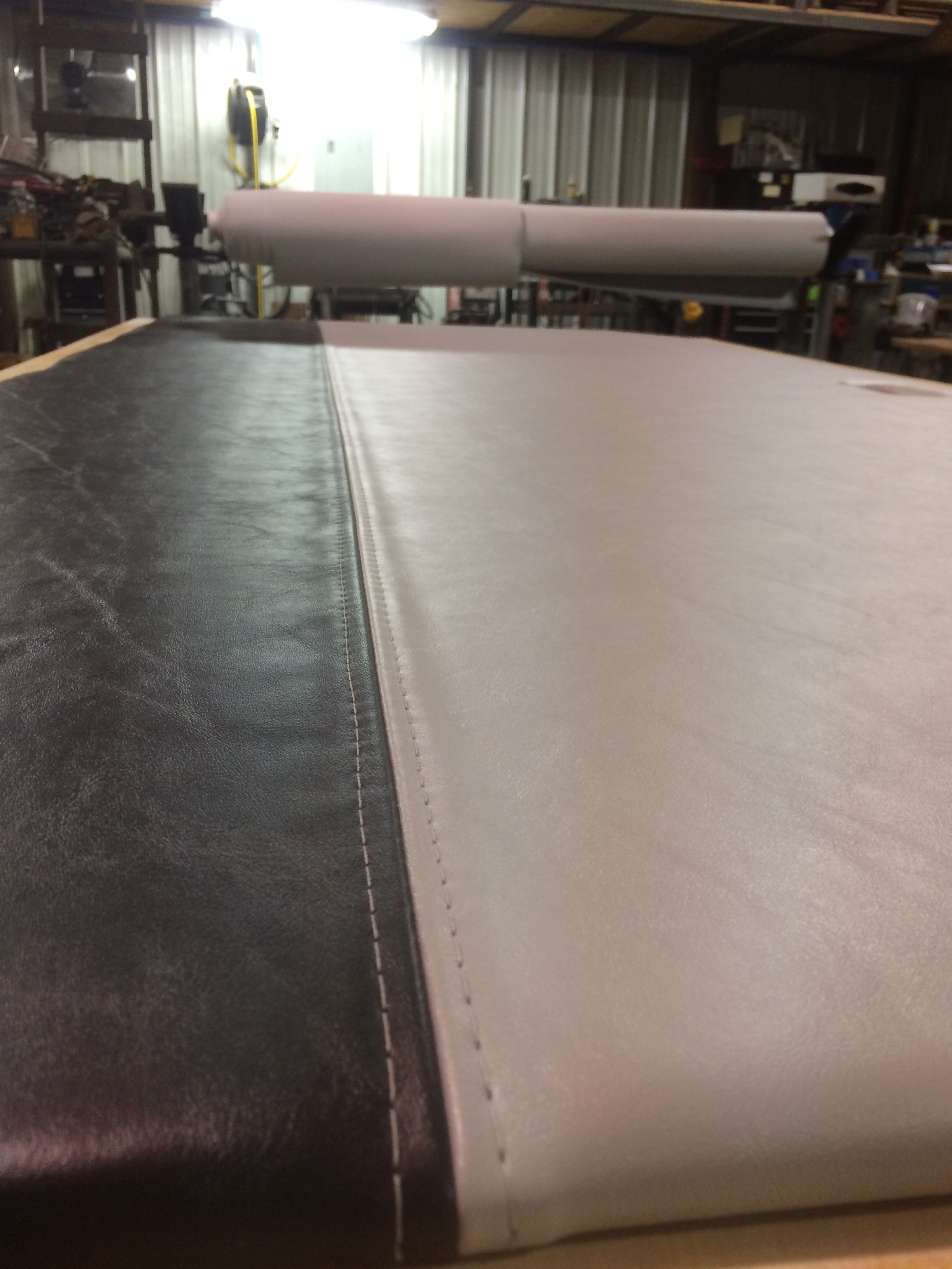

Finally got this monster put together. It laid down decent enough. Pretty sure its the biggest panel I've ever done.
