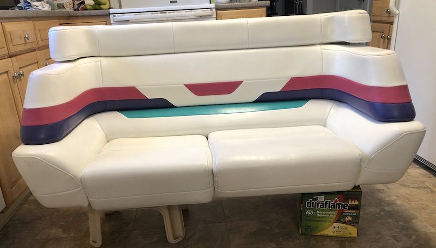

#9819

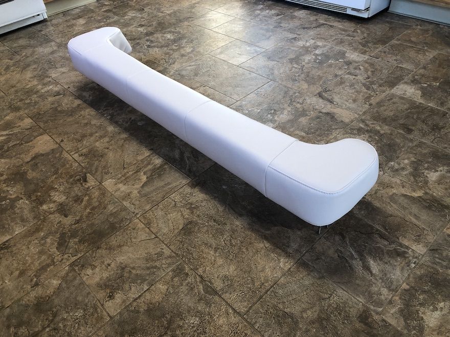

Looks awesome! Those inside curved panels can be really difficult. Hopefully some of those wrinkles will come out when you screw it in to the boat and it pulls the frame back in to place making the cover tighter.
As for custom patterns being a different size... The custom patterns if done properly will be the exact perfect size for what you need. When using patterns from the old cover you are going off the work of the last person that made the cover. Its anyone's guess weather or not it was correct.
Depending on how much foam you are backing the vinyl with you may need sew up the cover a bit tighter.

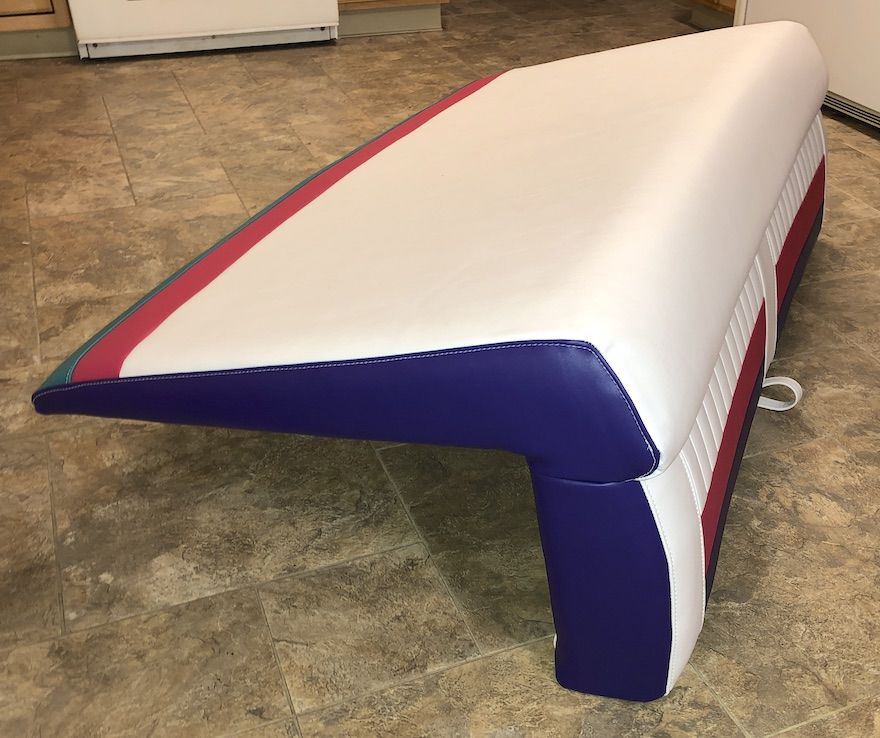

#9875

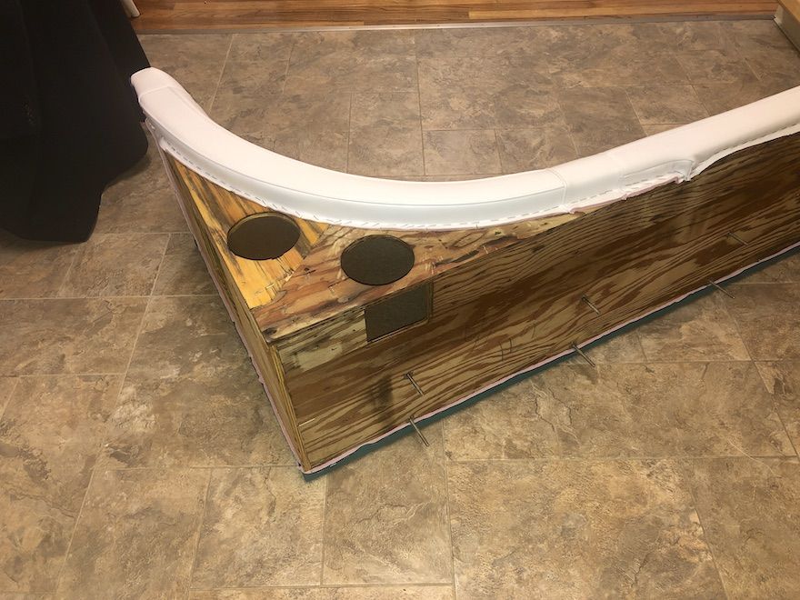

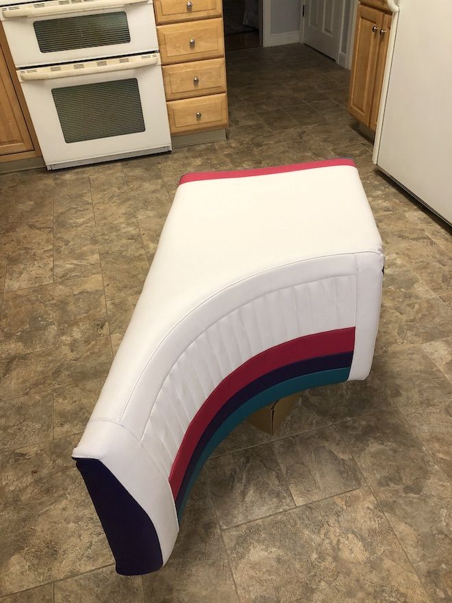

Update . . .

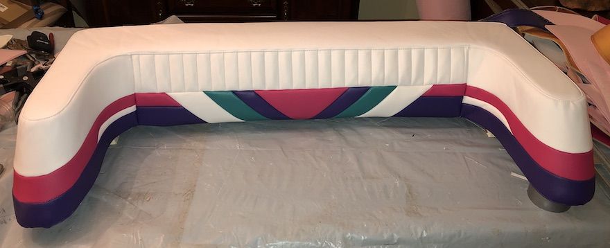

I got a couple more of the backrests done. Here is the rear corner.

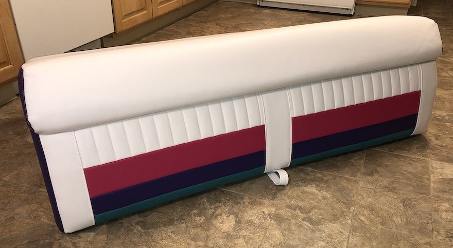

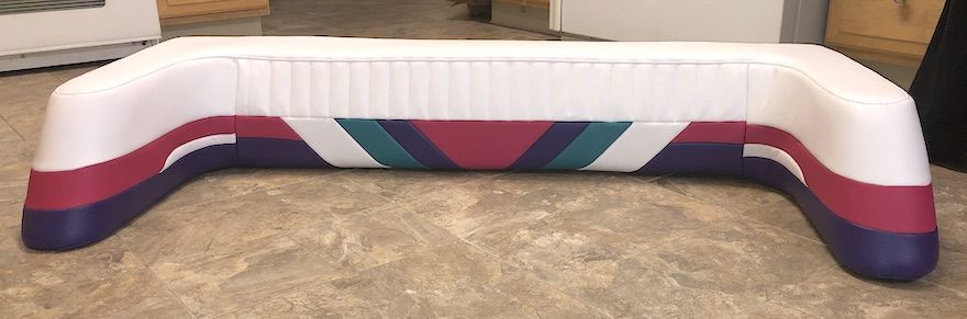

#9876
Here is the large rear center backrest section that also serves as a sunpad and a storage hatch.

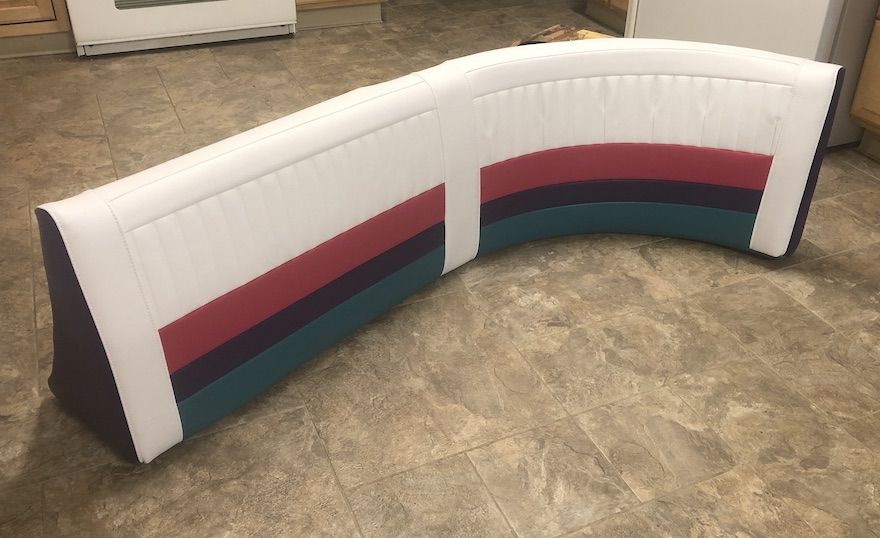

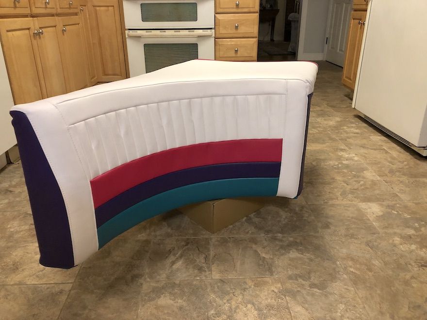

#9923
Here is the final backrest for the U-shaped seating . . .
I keep making mistakes with the patterns though . . . This one has better than the curved settee backrest, but still not 100%. It seems that I am having a tough time making the color/channel/white combination from one side of the middle (white) strip to the other. In checking my dimensions after the fact on this piece, it looks like I made the channel panel on the 'stright' part of the backrest 1/4" bigger than it should have been. (6" instead of 5 3/4") . . . :rolling_eyes: just don't know how I did that since I carefully checked everything and knew that it should be 5 3/4" as that what I was using for all of the other backrests. :tired_face:
Anyway, not sure if there are any tricks to make sure the dimensions are the same . . . maybe just checking the cut pieces against the patterns and intended dimensions (maybe)?

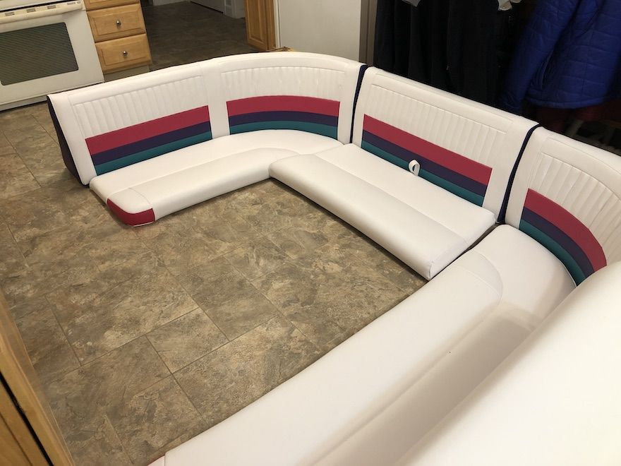

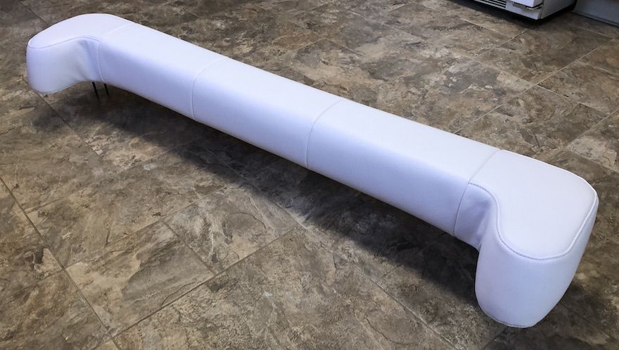

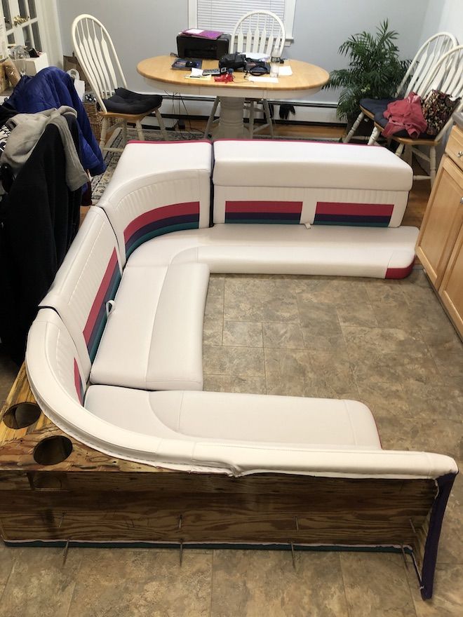

#9924
Also, now that the U-shaped seating is pretty much complete, I assembled them as they would be in the boat to get an idea of how it is going to look for real.
Here are a few pics . . .
Next things to do are a small end cap piece for the U-shaped seating and then onto the Helm seat, which is a project in itself.

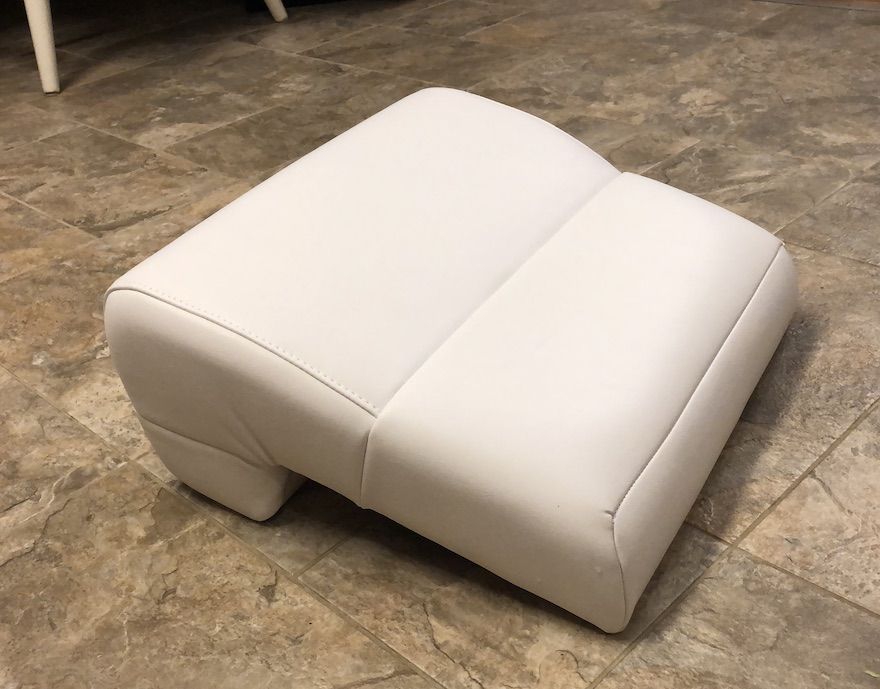

#10012

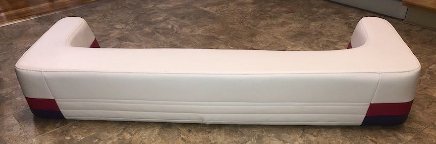

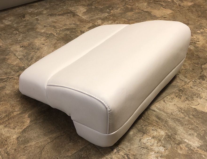

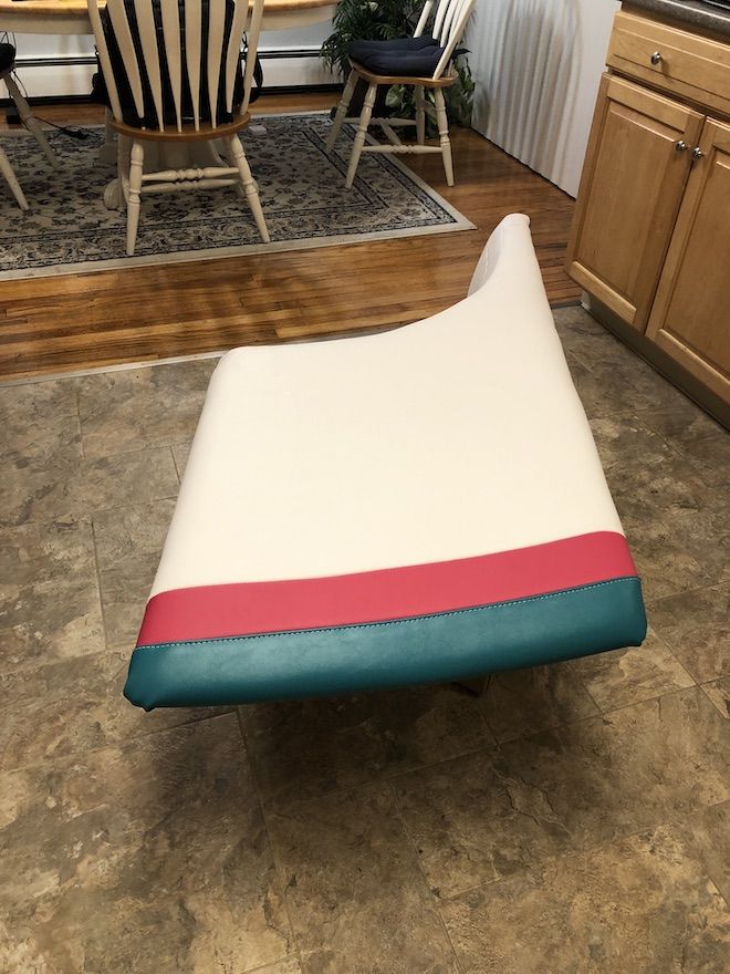

Helm Seat . . .
This is the last of it, having saved the tougher one for last.
The seat is actually 5 pieces. (bottom white/green, middle white/purple/pink, top white) plus the 2 seat bases
here is one of the seat bases all done.
John, miket liked this

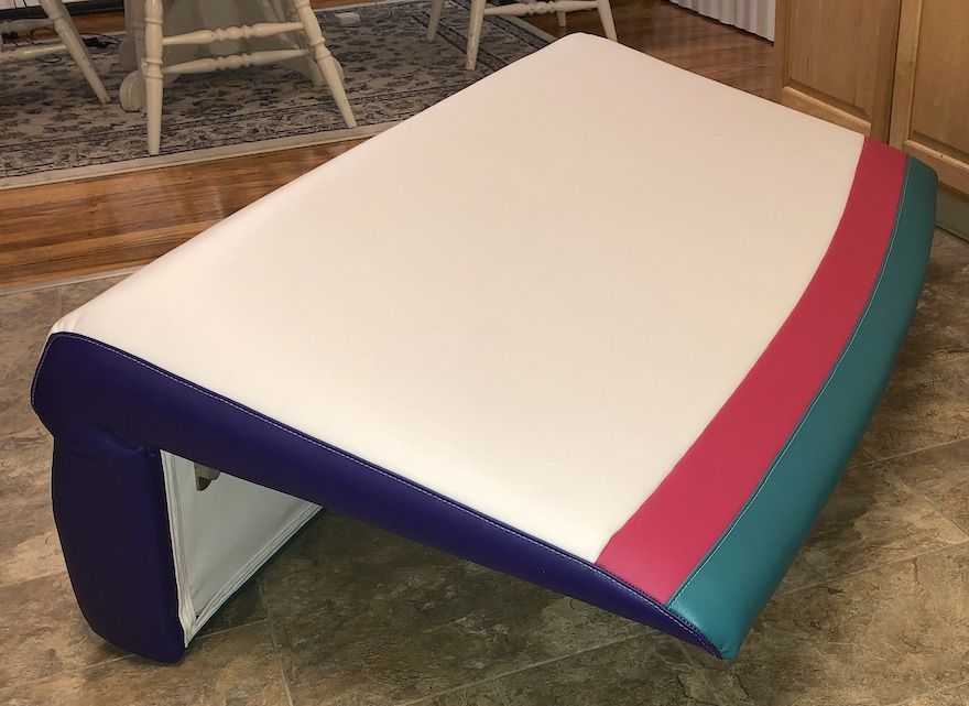

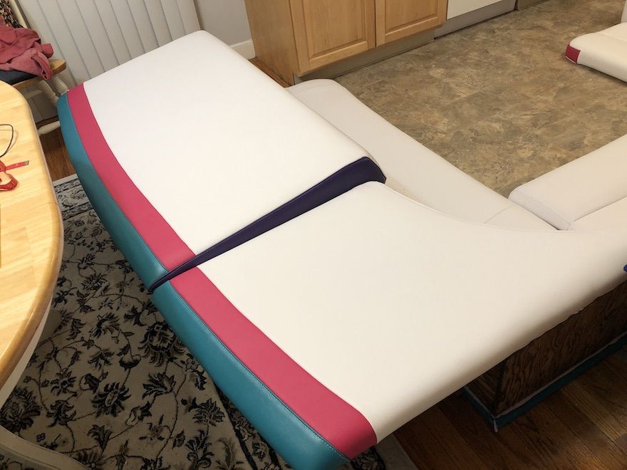

#10042
Helm seat backrest . . . Just loosely attached at this point, not stapled yet.
This skin was a real challenge to make, probably the hardest one so far. There is a top and bottom panel that stitches to a large 'wrap-around' panel with all the various shapes and colors that you see. The challenge is that the perimeters of the top and bottom panels have to be the same length as the wrap-around panel where they get stitched.
Somehow, I managed to get these distances the same . . . would have been a big problem if they did not match up. The top piece (white) that you see was the more critical of the two, since it is a single piece. The bottom (which you cannot see) is two pieces, so the fit/alignment can be adjusted during stitching.
#10049
Here is the backrest all stapled up . . .
One more piece to go . . . the helm seat base.
