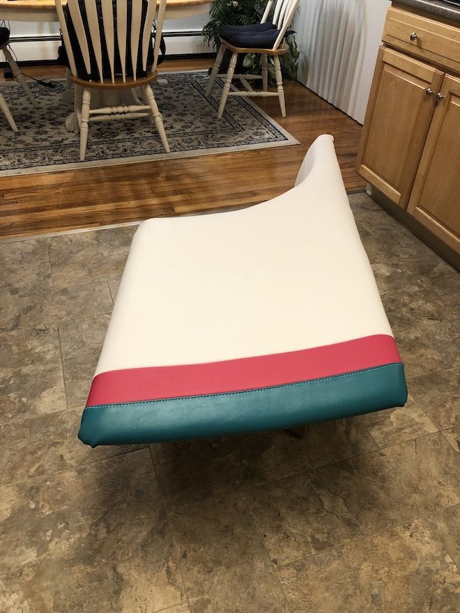

Posted: Fri Feb 28, 2020 10:53 am
by TedP
Helm seat backrest . . . Just loosely attached at this point, not stapled yet.
This skin was a real challenge to make, probably the hardest one so far. There is a top and bottom panel that stitches to a large 'wrap-around' panel with all the various shapes and colors that you see. The challenge is that the perimeters of the top and bottom panels have to be the same length as the wrap-around panel where they get stitched.
Somehow, I managed to get these distances the same . . . would have been a big problem if they did not match up. The top piece (white) that you see was the more critical of the two, since it is a single piece. The bottom (which you cannot see) is two pieces, so the fit/alignment can be adjusted during stitching.
Re: Re-Upholstering cockpit seating of my 33 foot boat
Posted: Sat Feb 29, 2020 10:59 am
by TedP
Here is the backrest all stapled up . . .
