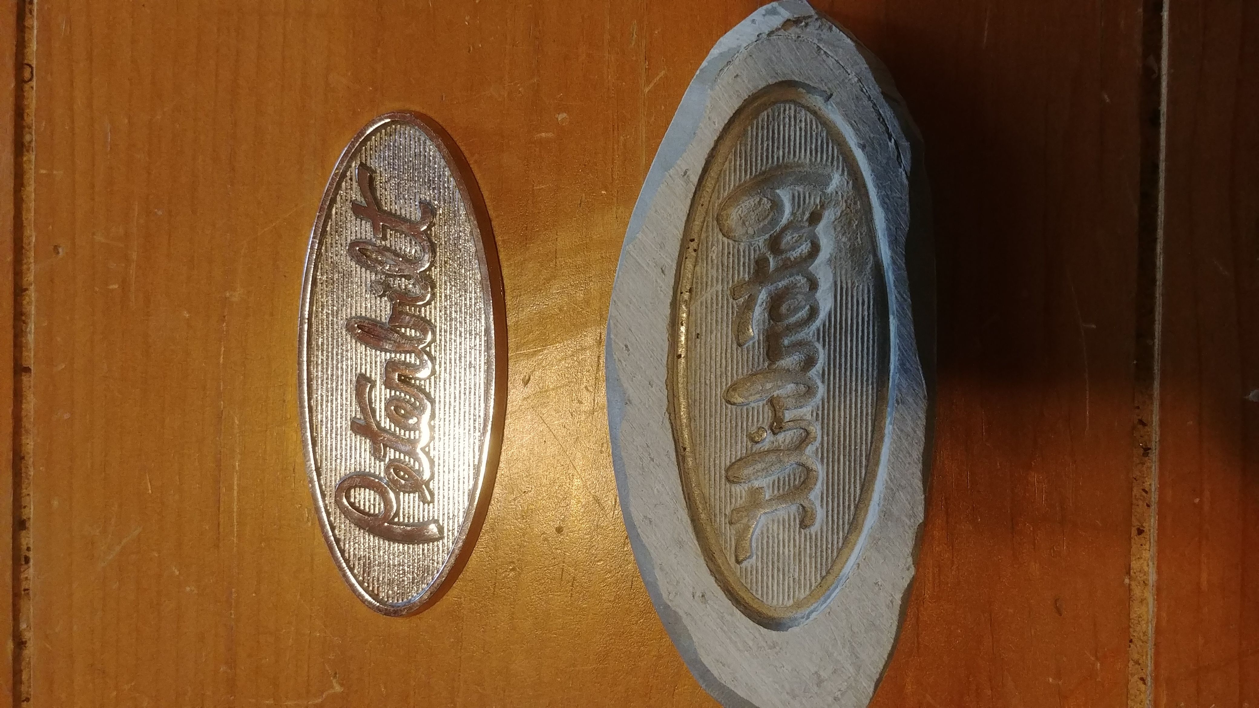

I made a die stamp out of JB Weld and an original emblem, I'll post the pics. I'm experimenting right now but cold pressing is not getting it. I haven't heated the vinyl yet but when I figure out how I can easily line up the stamp and die I will either heat the emblem or the vinyl and see what works best.

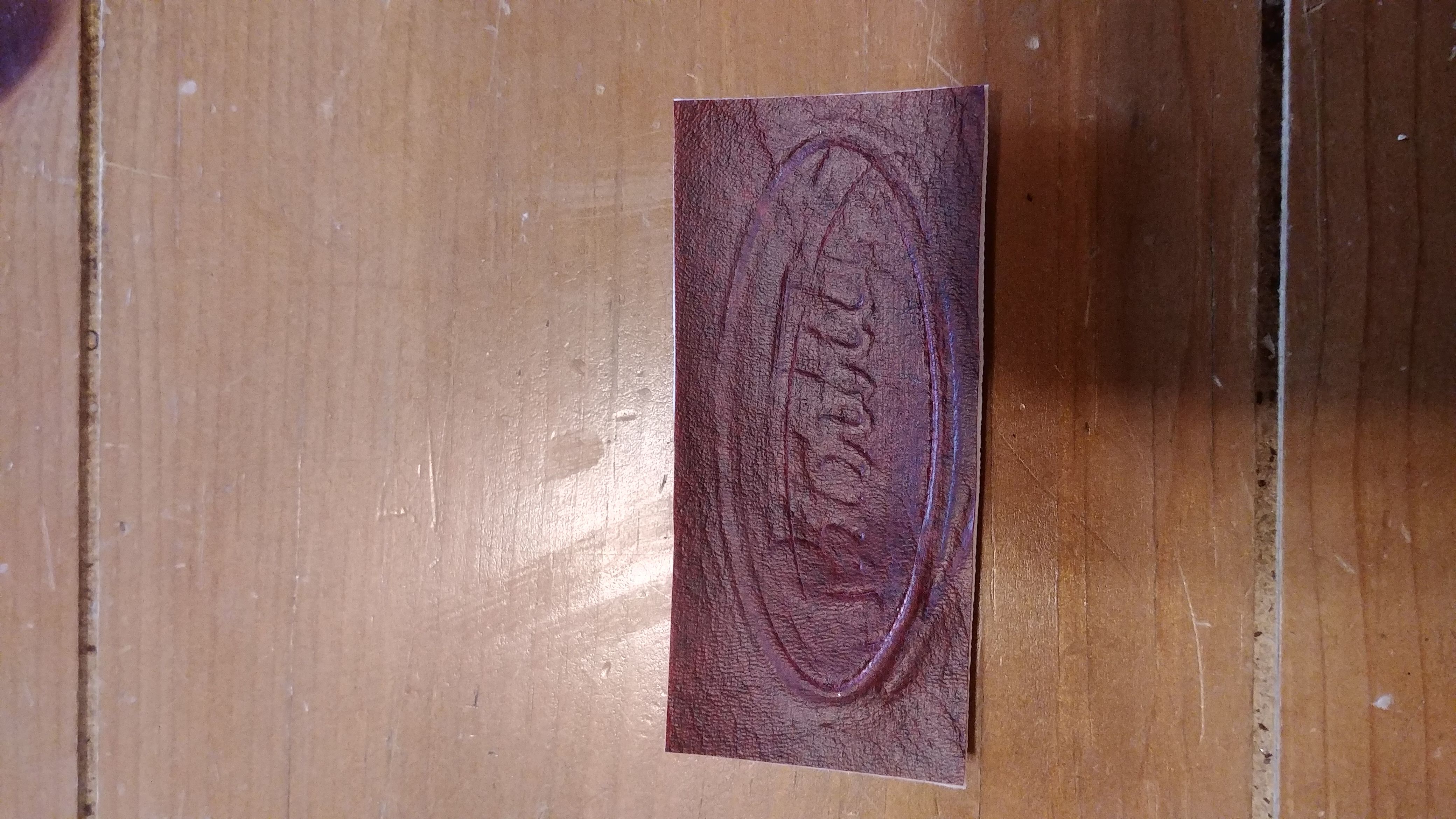

You can see I double pressed the vinyl and got it misaligned.

I think the heat will not hurt because as we talked about earlier in the vacuum molding they got the vinyl pretty hot in the oven before vacuuming. What I see as a problem is using two dies as you have made with jb weld that has no clearance between features for the vinyl to form into :nerd:

@hapyrdr I think your right. After my post I went back and took a propane torch to the piece I pressed staying about 8 inches away from the backside and it never changed color but the cloth backing did scorch. So vinyl, Naugahyde anyway, can take the heat.
