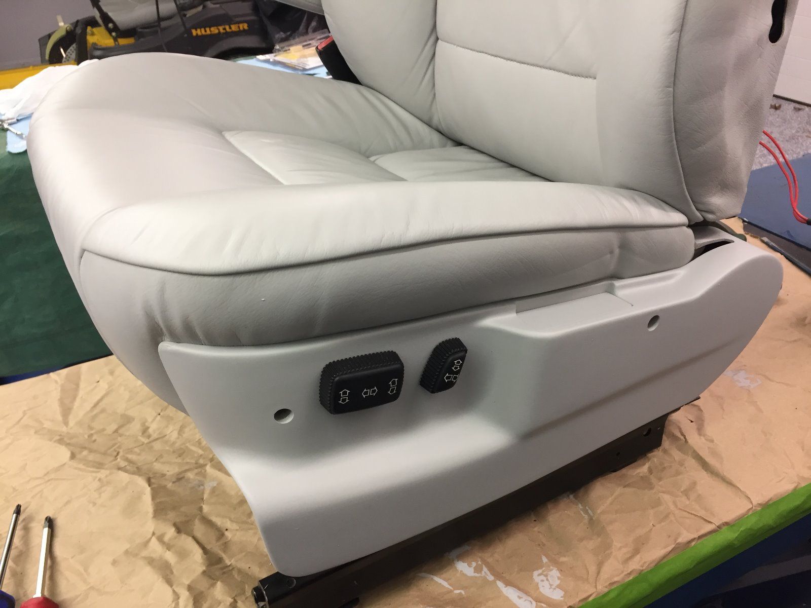

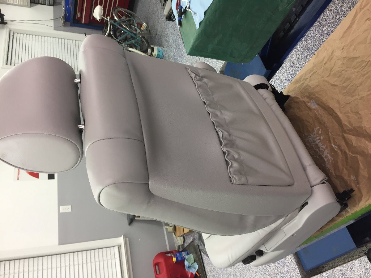

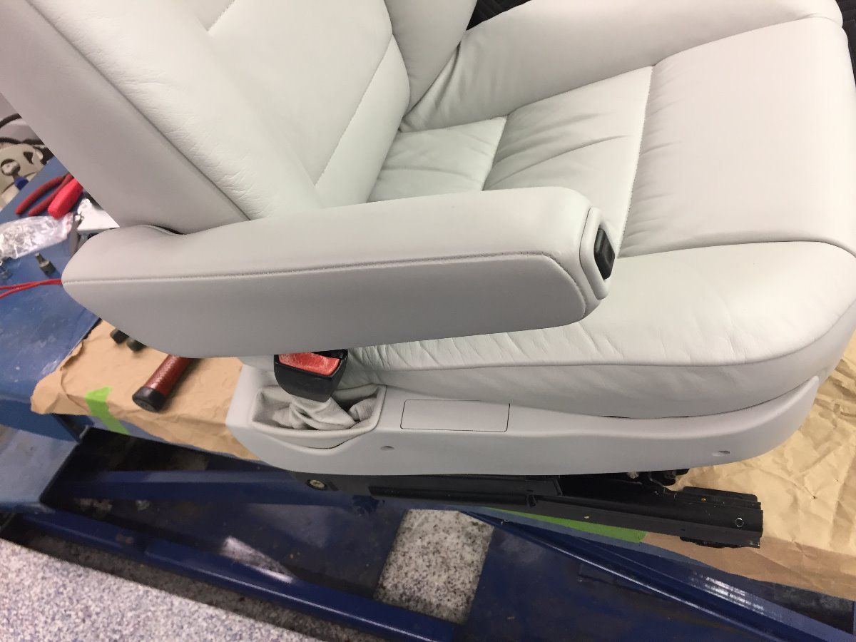

Seats which in my car now. Rebuilt, exchanged L/R leather so driver got good pieces. Repaint all with special paint.

@IvanD ,
Those seats really look great! We are working on a 1947 Willies right now and the seats were painted, sometimes may be the only way to get your colour match.
#2973
Painting not bad. I already have 3k miles on driver's seat and paint holds pretty good. But you can still tell if you look close.
Seats I want to restore have really bad leather (picture in first post is not my seats, just the same seat). It's completely dry and cracked. Even if I paint - it's still really hard and will crack/rip.
I was thinking about finding good deal on automotive gray hide and then just paid whole hide. This way paint won't be in seams/etc and I can lay it perfectly. Afterall they paint this leather just the same, right?
#2976
