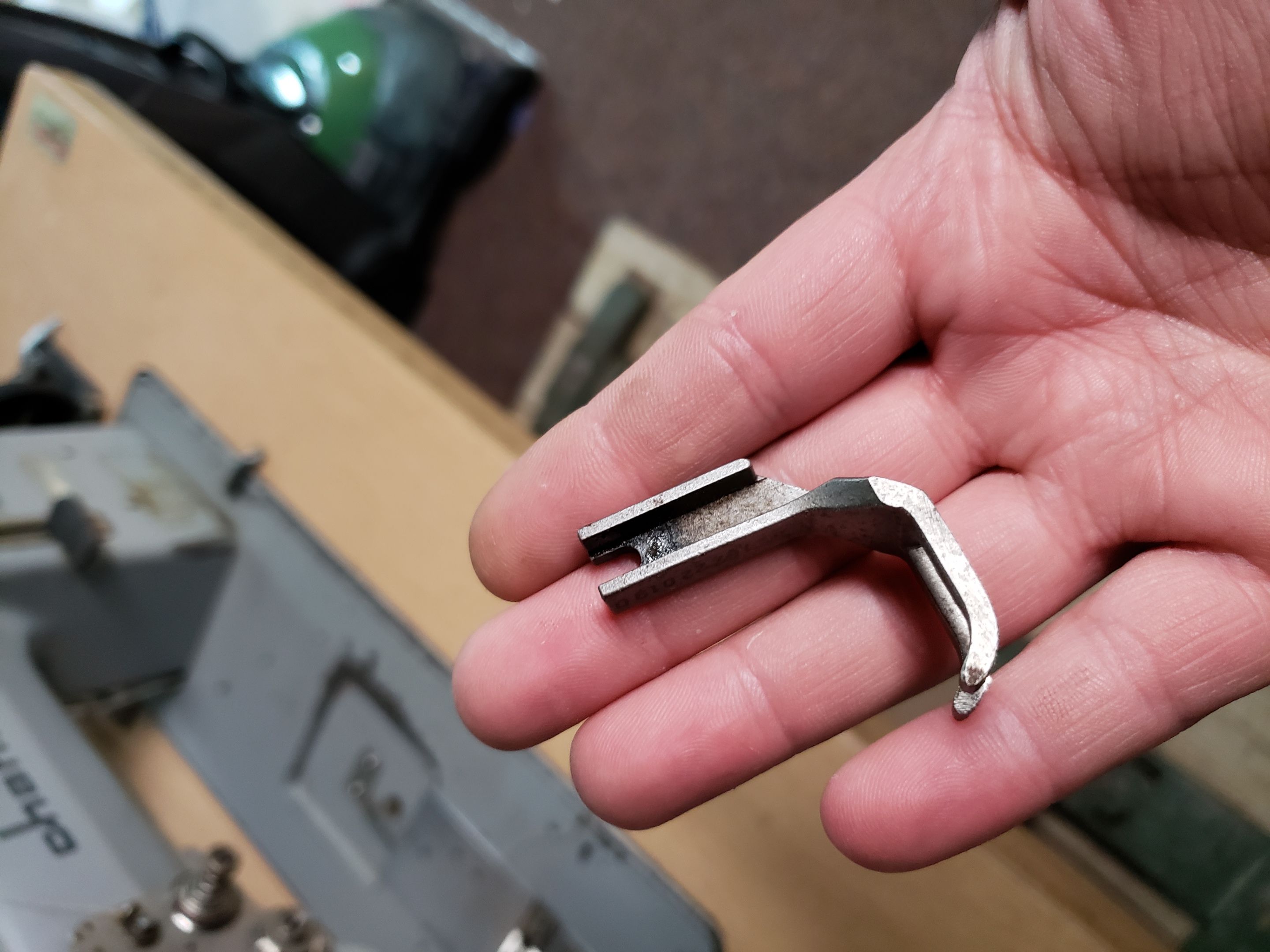

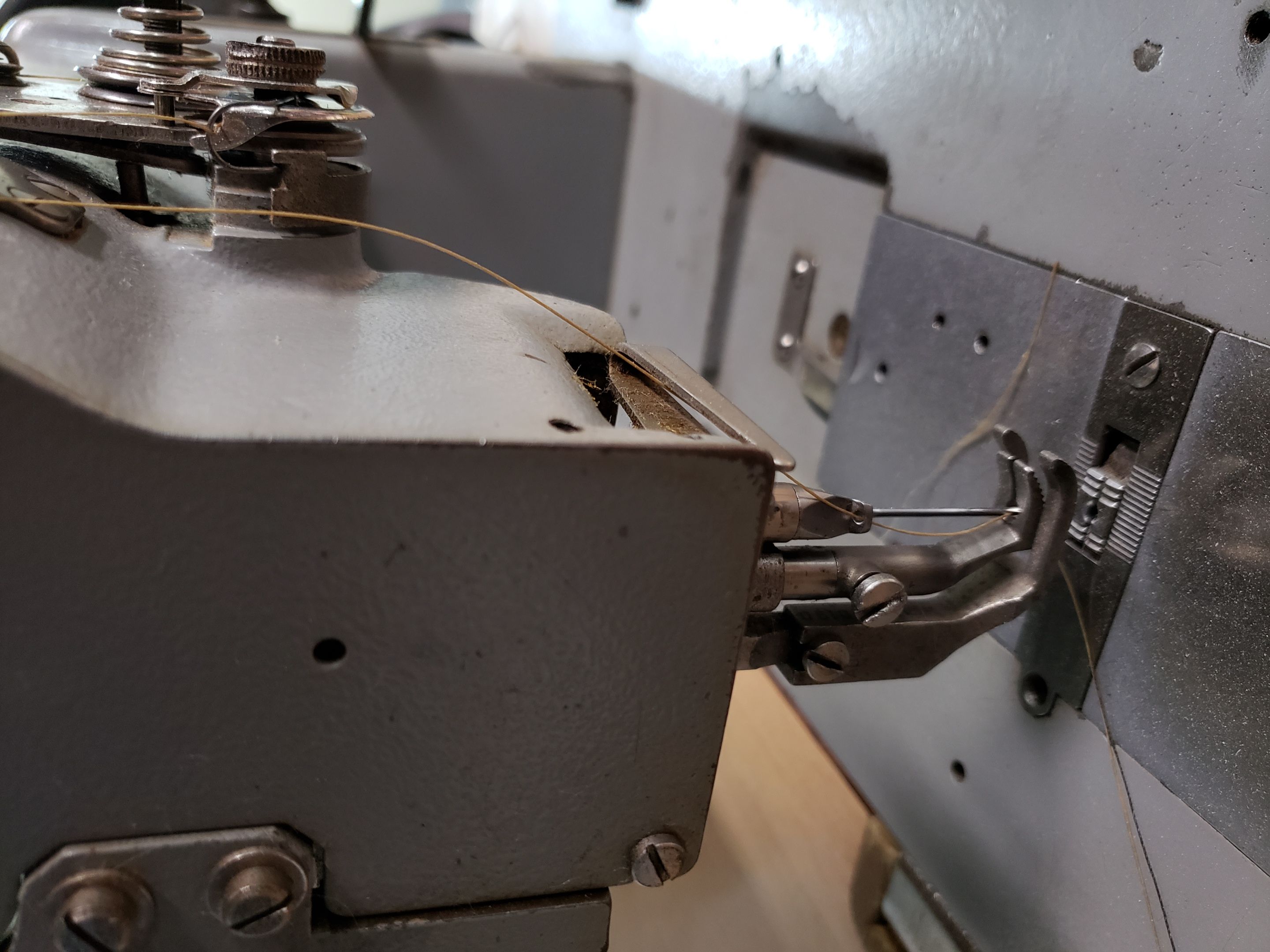

Here are some pics of the foot on the machine now. Also i was watching your beginner videos and you say to use 92 thread for everything. Can i use a #18 needle for that? I just bought a 100 pack of #18 for all the sewing and a 100 pack of #23 needles to use for contrasting top stitching.

The feet I posted will not work on your machine. Try a google search for (Your machine model)+ edge guide feet.
