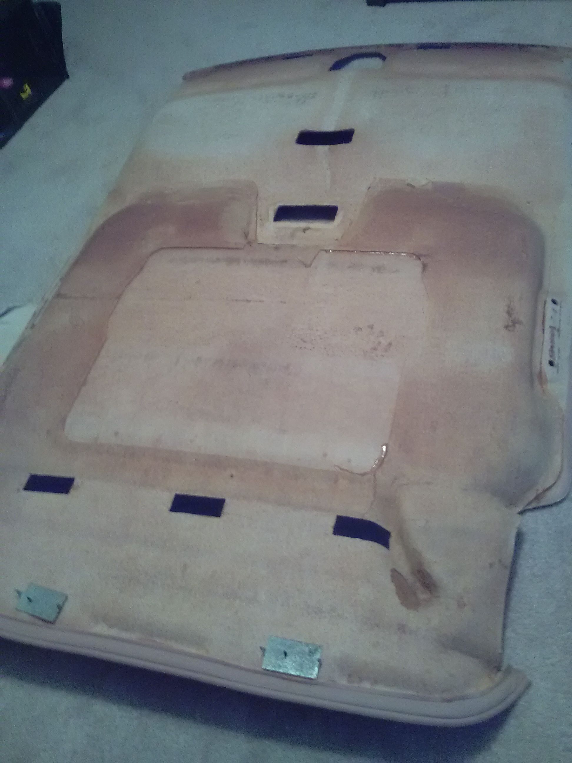

Hi John
My headliner is in two pieces. The front piece has a pocket for the rear air conditioner vents. I need to remove the AC vent covers. Do I need to un-glue (separate) the pieces that form the pocket and if so is there a certain glue I need to use to put them back together. ( Photes attached)

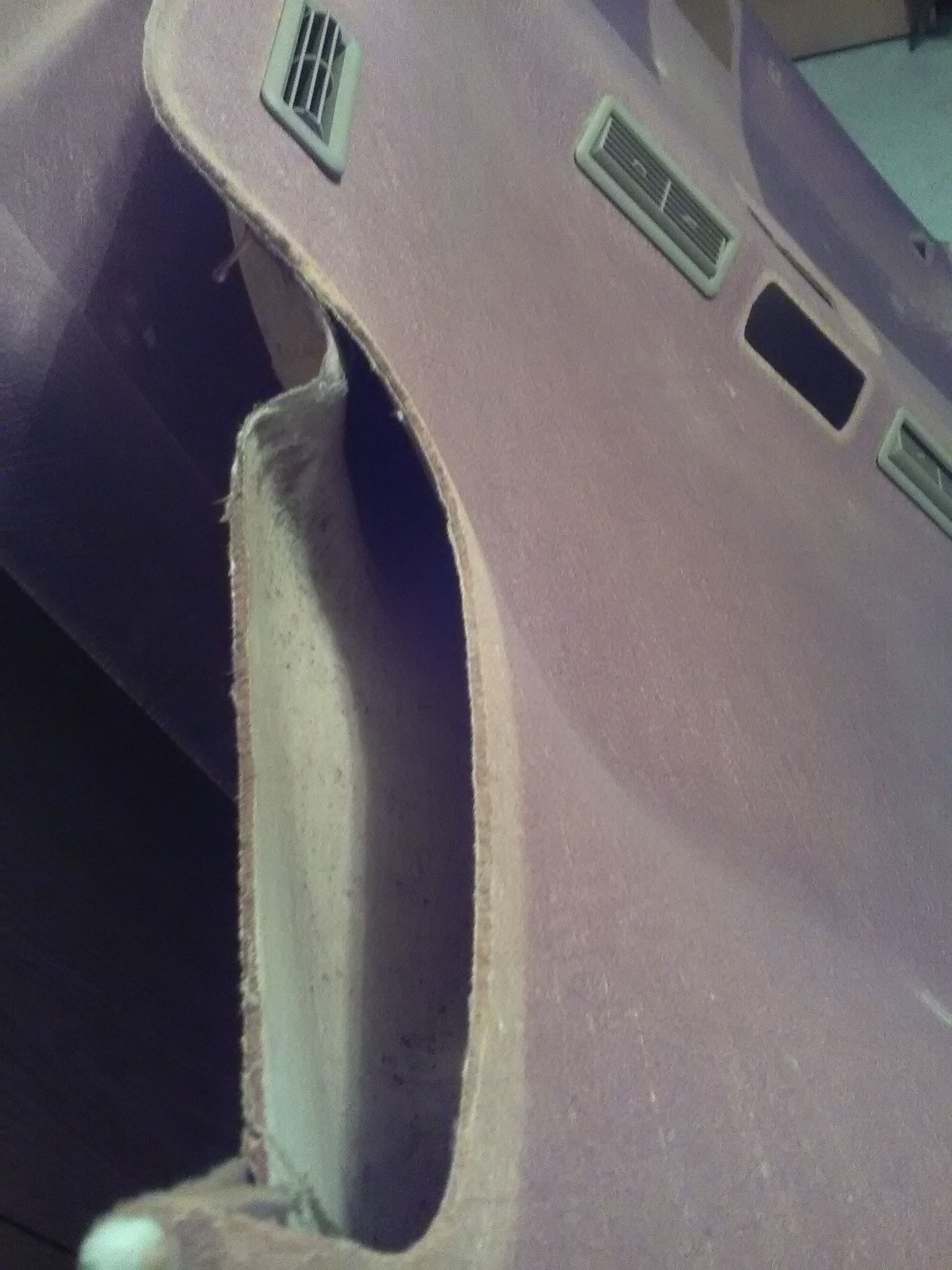

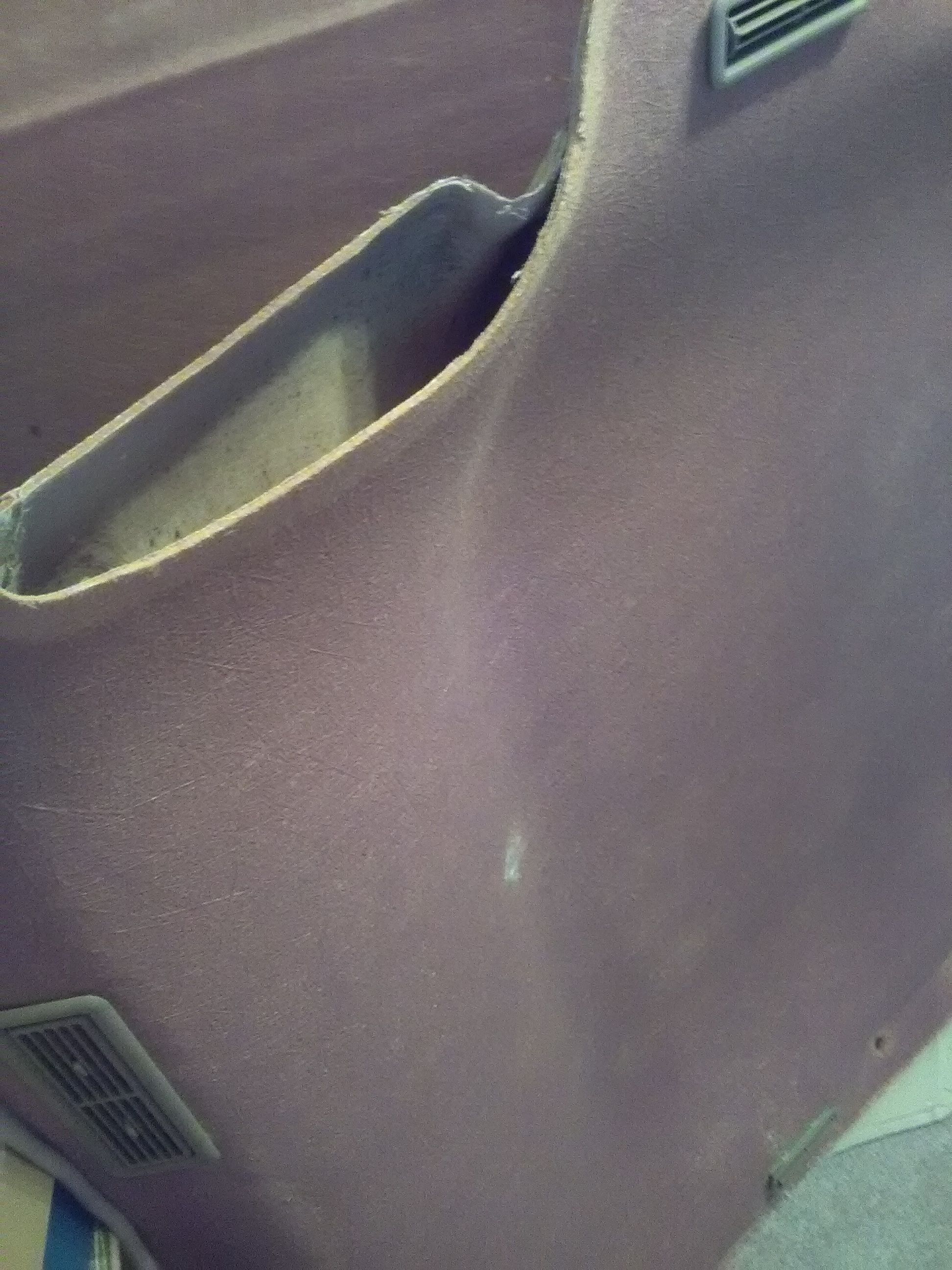

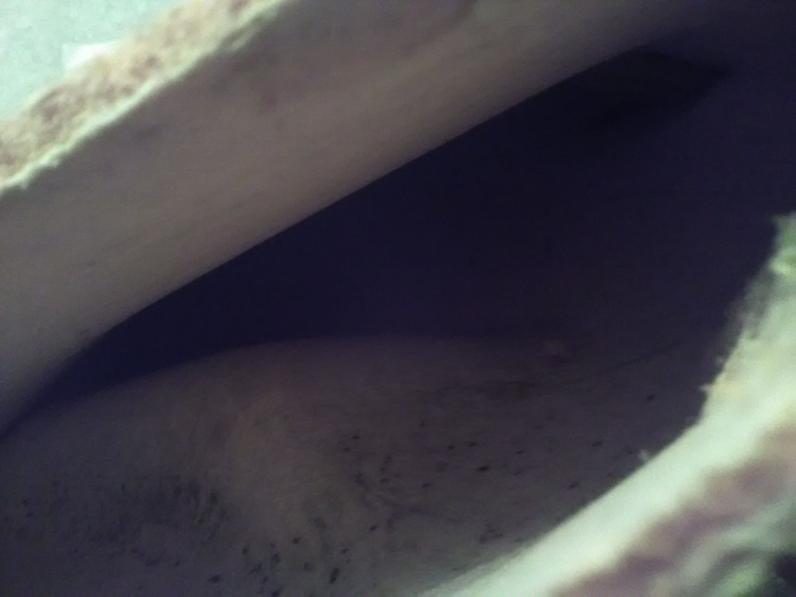

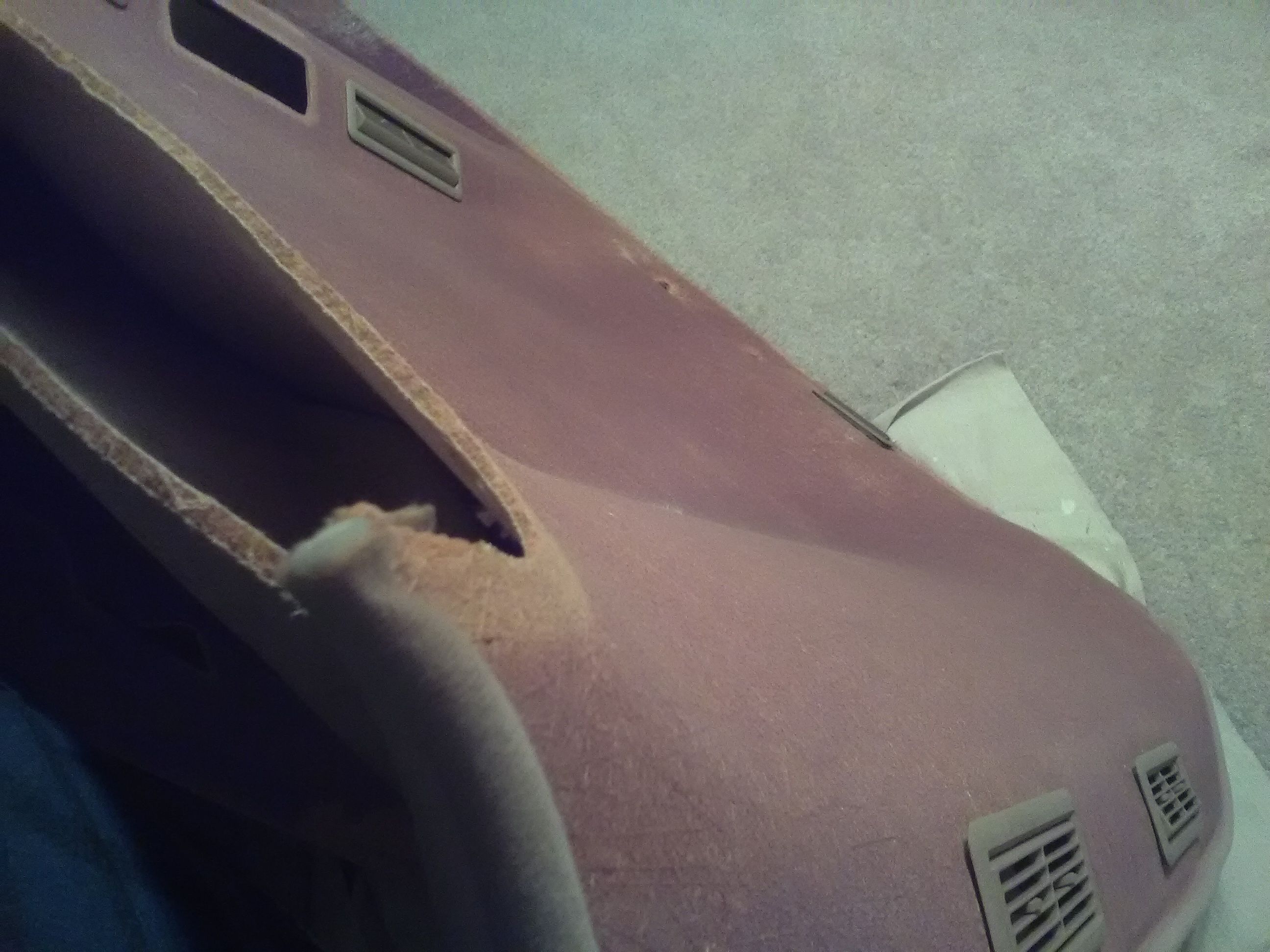

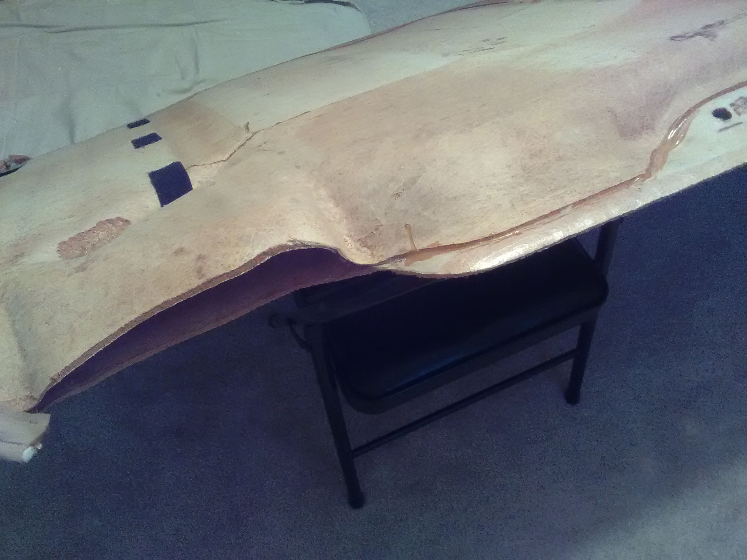

#3123
Thank you for the photo of the air vents that helps alot.
But I can only feel the edge of that first vent. I can't fit my hand/arm in that opening.
I attached more photos.
The opening is 2 1/2 X 10 1/2 inches with a molded cavity.
Maybe I took on more then I thought but I am determined to complete this, even if I have to separate the pieces. Which I really didn't want to do. But if it comes down to that I defently want to make sure I use the proper glue to put it back together.
#3166
Are you able to get some one with smaller hands to reach in there and bend up the tabs? It looks doable to me. If you do have to cut it apart you don't need and special glue. I would probably use construction adhesive that come in the calking tubes.
