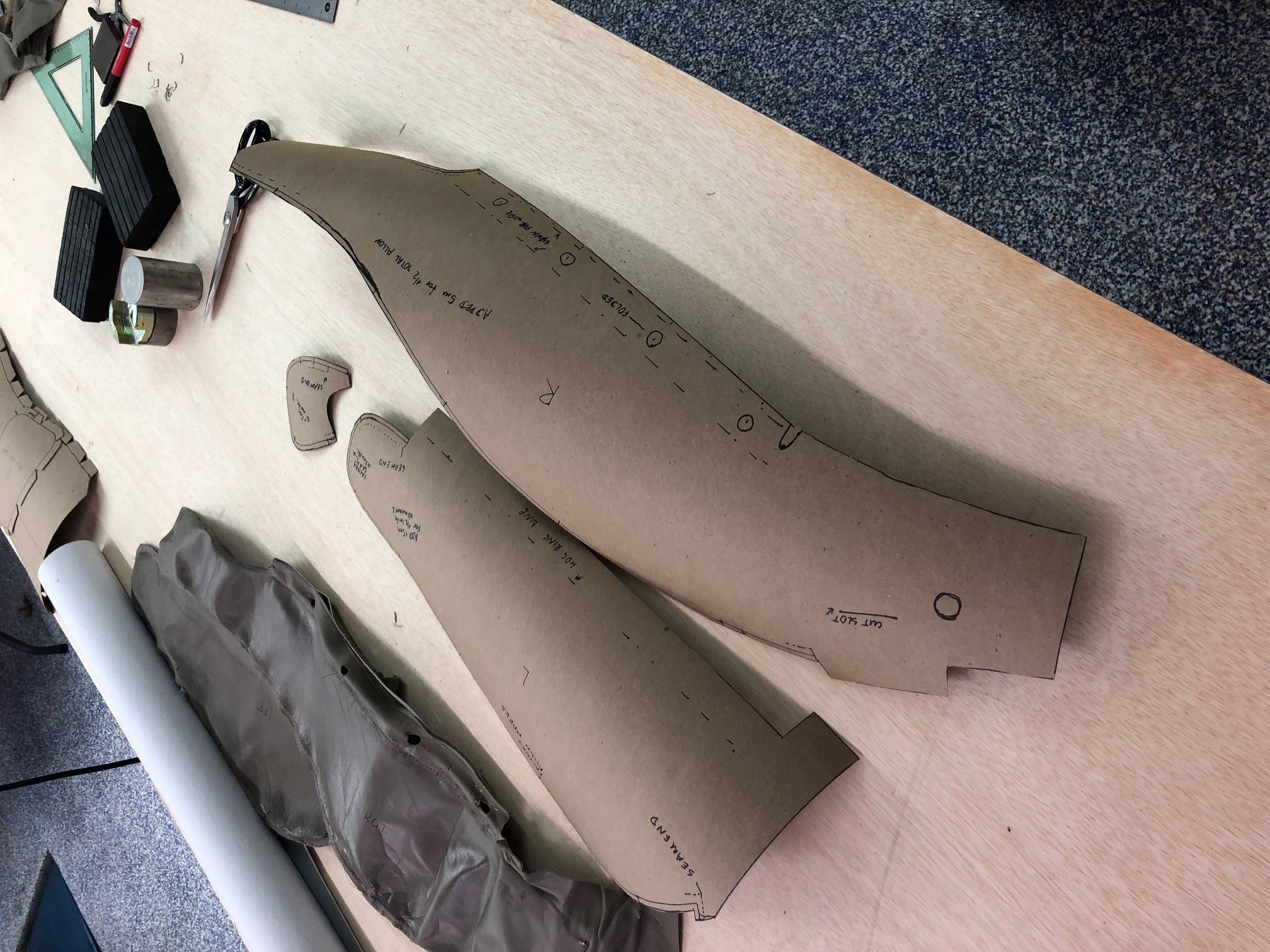

Anyways. I cut L/R side bolsters. Then I found factory alignment mark on those which is great. Then I got L/R stapled together at identical spots. That helped me to get overall shape correctly. Then, as per advice, I got it laid on cardboard and made templates. Added 5mm where seams will be (they had 7mm allowance and I made it 1/2 inch)
I feel good about it. Waiting on correct size needles to come in and I will give it a go.
Problem with headrest is that I'm using 1/2 inch and 1/4 on side foam. March harder to sew this way. I will try again once, but if it won't come up good - I will just 1/4 on main piece (like original was)
