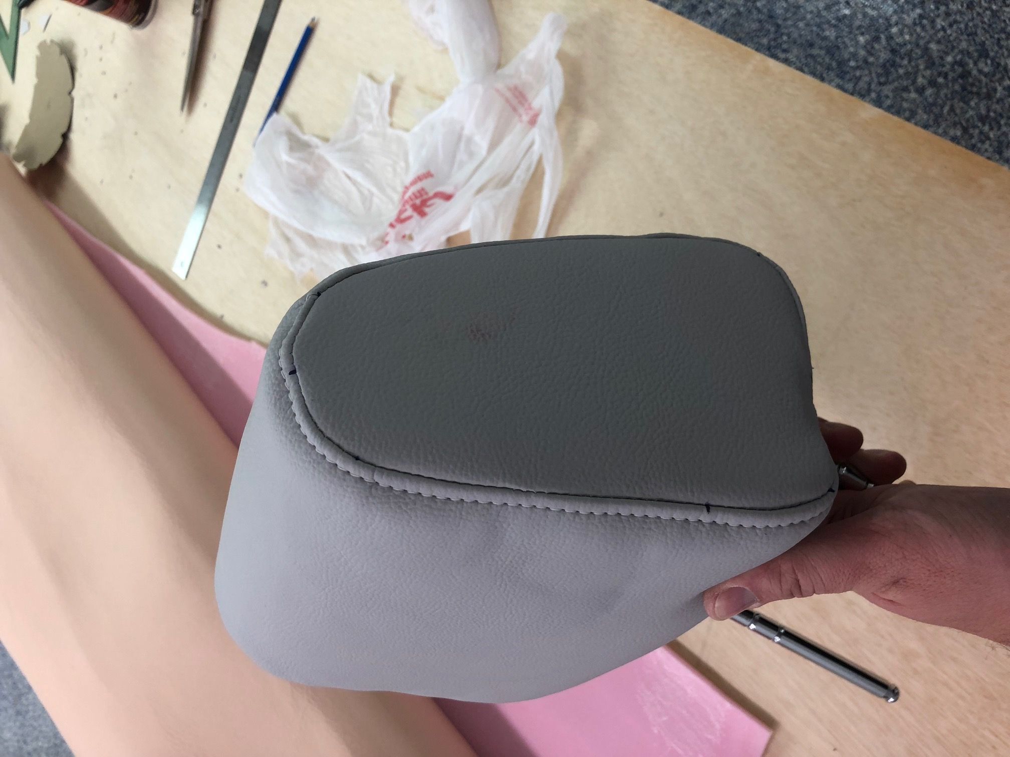

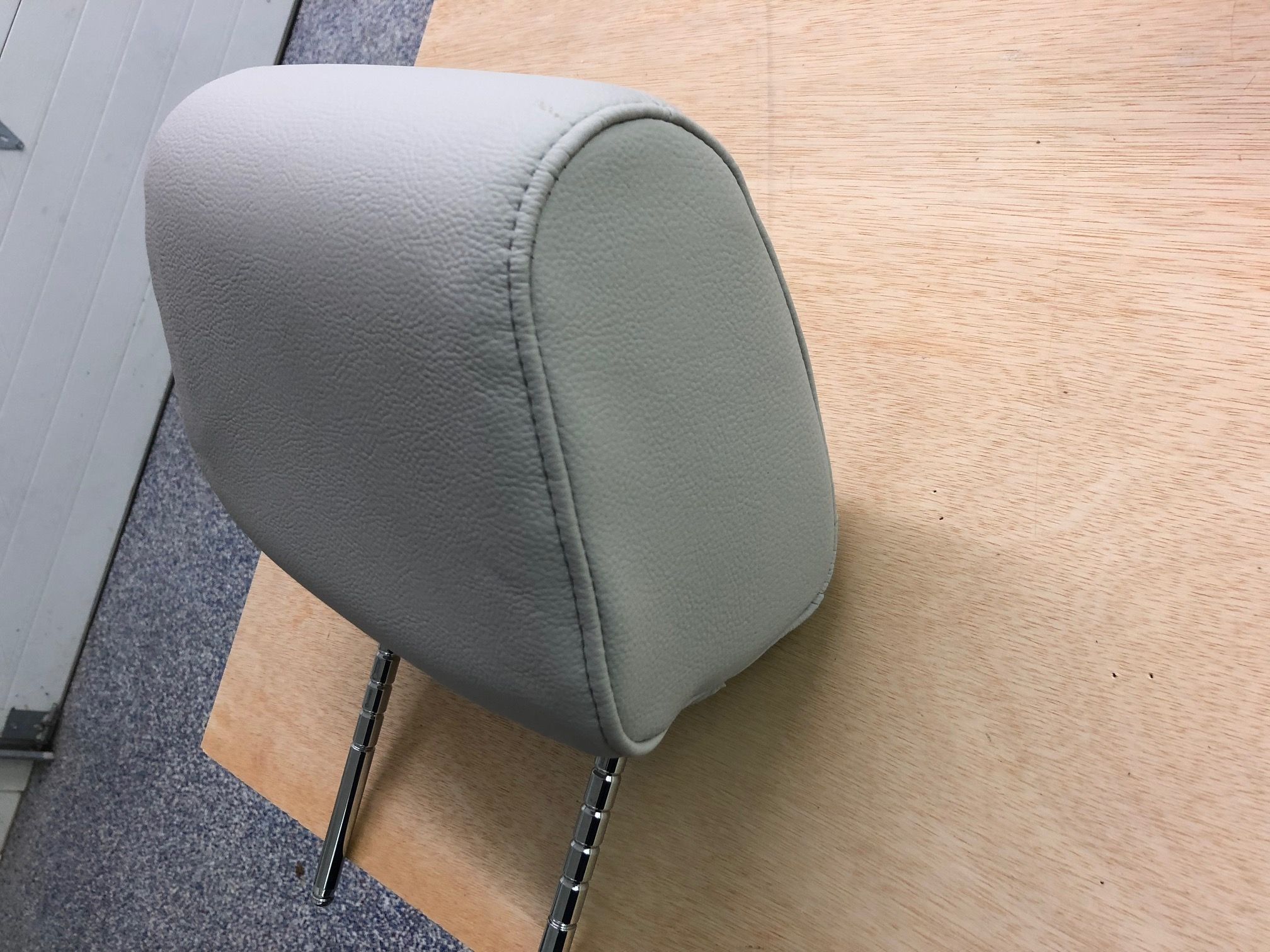

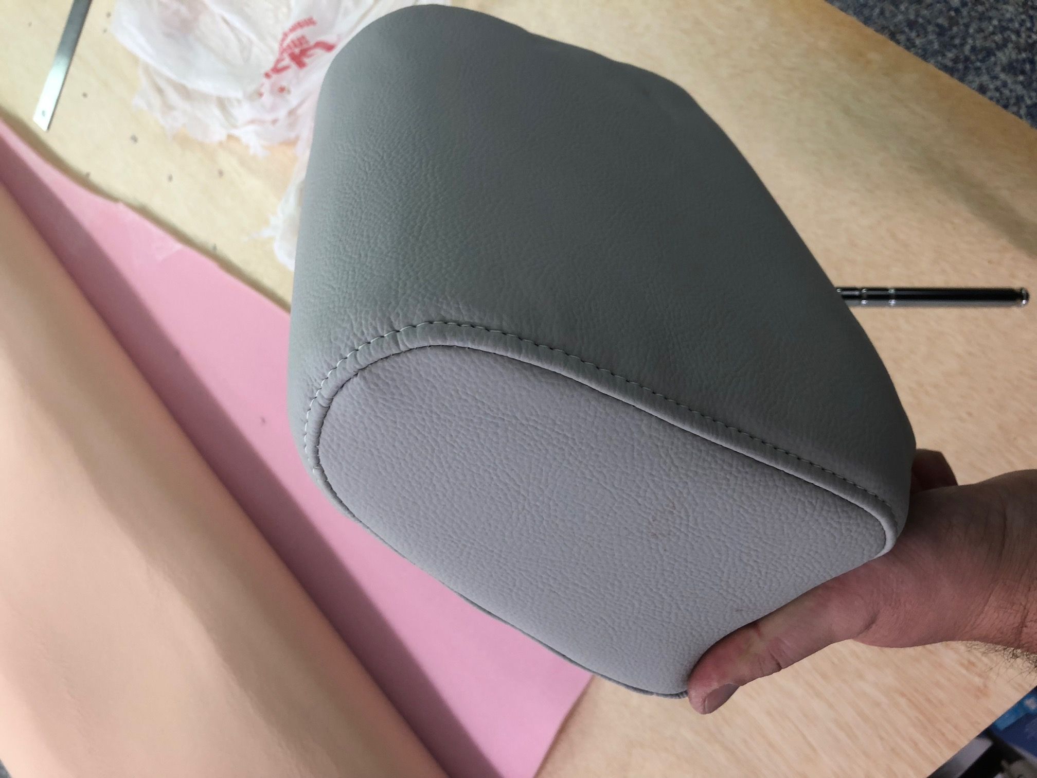

Attempt #4. No foam on sides, 1/4 on main one. Much better but still fighting bulk. Maybe not the easiest piece to learn on.
So far mistakes:
1. Alignment marks all the way to the seam line show
2. Little wrinkling on first run but much better, pretty much good.
3. Decorative seam spacing is bad (which I will fix with special attachment, for now I just wanted to try)
4. Decorative seam - I need to make sure material folded and there is some extra so first seam won't show.
5. You can see on top - underlining foam wrinkled up enough to show
Also, do you think lot of this will come off with steam and/or heat gun? I don't have steamer, but I can try heat gun.
#3113
I think just by the last picture it looks like your side pieces are too small and the top is wrinkling cause it’s wrapping around the side and forcing the material and foam to bunch as it can’t shrink. In the second pic it looks like you can see a line about 1/2” up from the seam showing through from headrest making me think you need taller sides and take a little off the top.

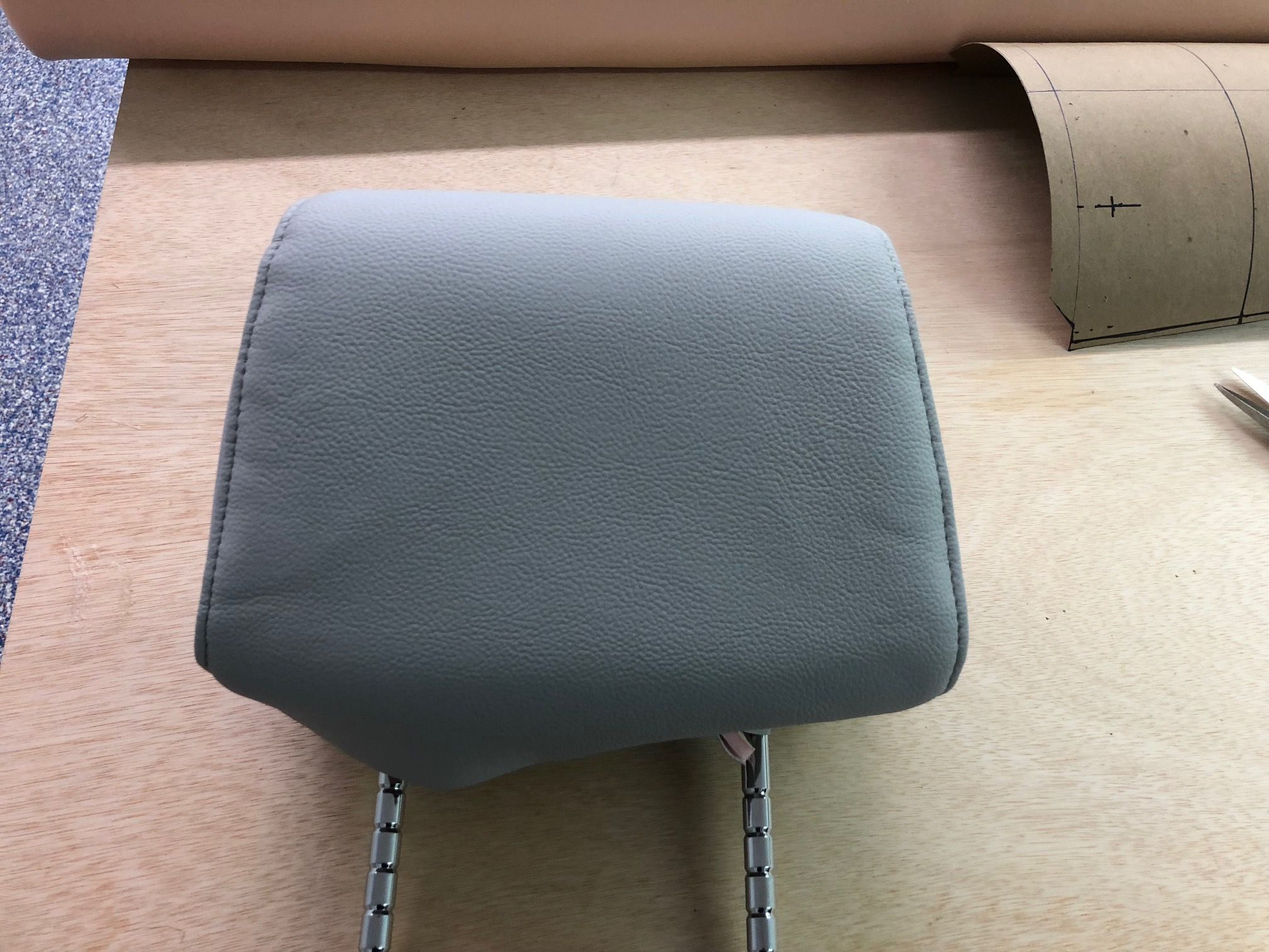

Attempts #4. New templates. Used feet with 5mm guide for decorative seam. Didn't put steam on it yet, but I like it much better. I think next time it will be even better.

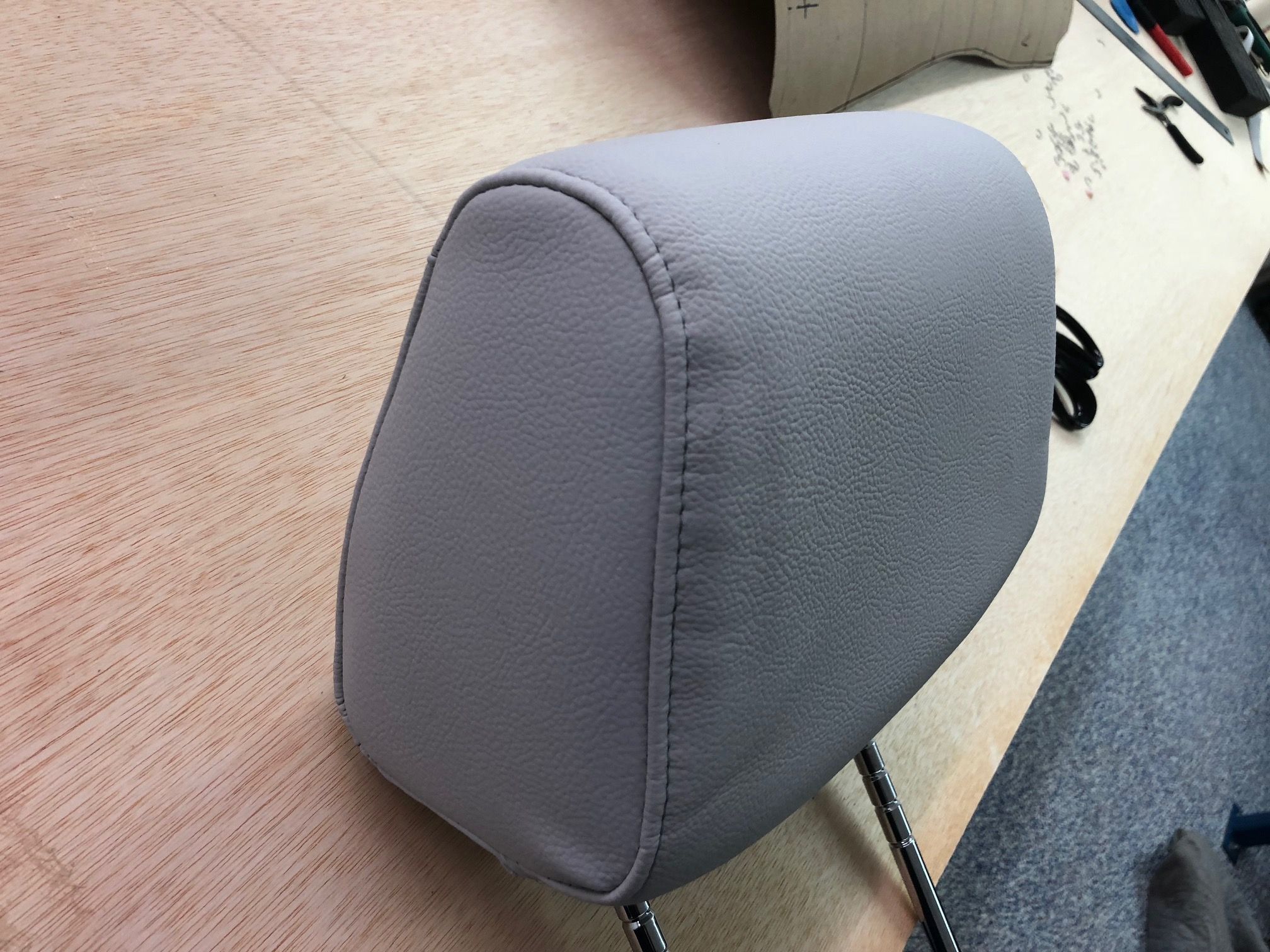

#3264
I did 2 more. Much better but not ideal. Maybe I'm overthinking whole thing. I look into people's cars, look at seams on seats, notice all the small factory imperfections..
I decided to do yet another set of templates. Take them from a foam, not from existing covers.
I also think I need to skip foam padding and just do vinyl sewing, it's tricky enough. I can glue layer of foam to existing foam and not deal with sewing it.

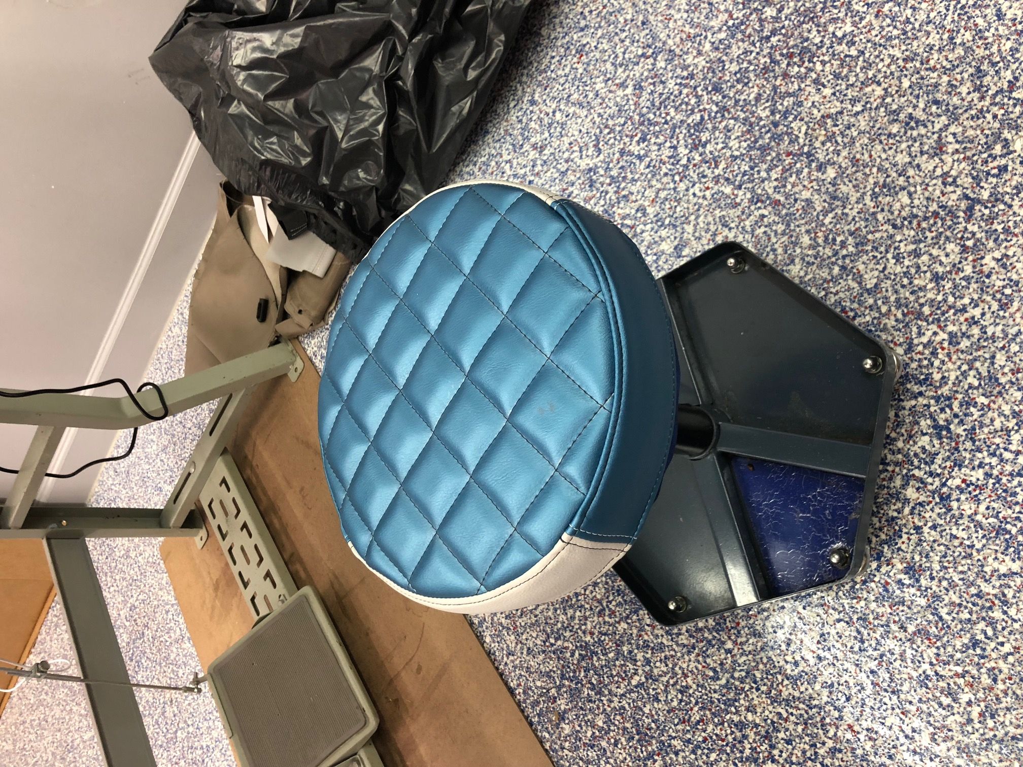

I also decided to move on and switch to another project. I started working on a diamond pattern shop chair cover just to practice more and get away from doing those headrests again :)
