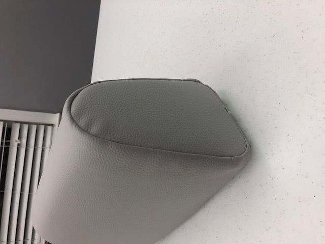

Made another headrest. Lost count of how many I did. Now it looks pretty good, just like original was. Didn't hit it with steam and it's not leather but I can tell it is right. I.m sure it will be even better when I do it in leather.

I made 3 more headrests, another set of templates for headrest. I still like single reinforced seam better then plain seam. I think it's good for now, tired of doing same thing over and over. Will move onto other parts and then do some more practice runs on headrests later.
Given that I didn't steam/stretch very good - I think result is decent. All parts that I don't like not visible anyways after install.
Total I "made" over 10 headrests now. Plus I sewn bunch of circles, etc. Here is another thing about those headrests - seam length between marks different on sides and main part. So you have to "gather" material when sewing.
I also stopped using pencil for sew line, just go by guide. Definitely making straighter seams but those headrests start to get on my nerve :)

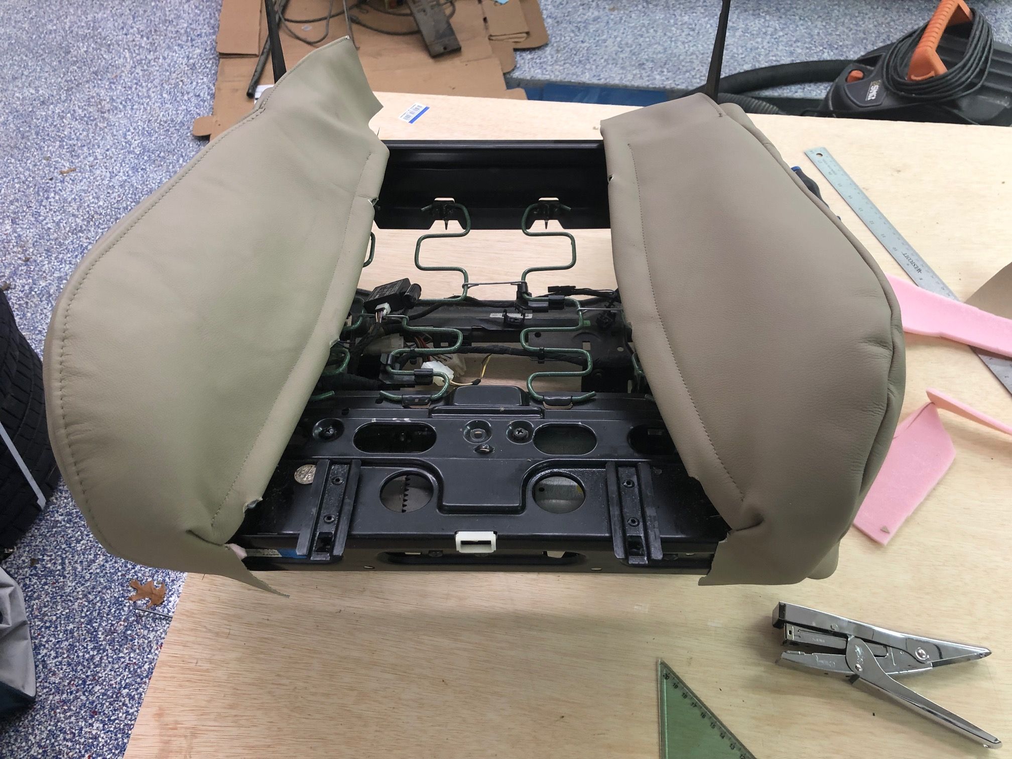

Need advice on dealing with seams. Here is 2 bolsters (pictured). One got reinforced seam and another is factory style. I did cut bulk from both of them, internal part covered with 1/4 skrim.

Posted: Tue Dec 11, 2018 5:37 pm
by Joemcglynn
I’ve never done this - just a beginner myself. But in terms of aesthetics, on the bolsters I think a single win forced seam like in the first picture would look best, but move the seam so it’s on the side of the bolster instead of the top. I’d probably use a contrasting thread too, just to make it “pop”.

Re: E34 BMW sport seats
Posted: Wed Dec 12, 2018 3:49 am
by Cody
@IvanD youre making great progress in all aspect of your project. Keep it up.
On the no reinforcement seam on the back side have you cut vertical slits along the seam allowance so that it can bend? Sometimes if you don’t the seam tries to fold up on itself and becomes wavy and does what you’re showing. But I agree for aesthetics. The reinforced seam looks better. The angle is hard to tell in the last pic but in your first pic of the bolsters, it looks like what @Joemcglynn said. You can see a sharper spot where the foam bends and then your seam is in from there a bit. To help things lay flatter, your seam should fit best on that bend. Think of drawing a line along the apex of that bend. You want your seam to be on top of that line and the material on either side of it.
Posted: Wed Dec 12, 2018 5:21 am
by IvanD
I hear you guys. Thing is - it’s like original is. If I move this seam- material won’t stretch as needed. Almost have to add stripe of material so there will be 2 seams instead of 1
Posted: Wed Dec 12, 2018 3:42 pm
by IvanD
Ok, see pics of original seat attached. In original - they don't do reinforced seam. But it doesn't go on edge. My templates correct I think. I may need to stretch it little more. Another pic shows my current car's seat where same bolster made of more pieces which allows wraping around this "hill".
And my own "invention". Yesterday I was playing with leather and adding second seam about 1/8 from main one for strenght and to help it lay better. You can see main seam "wondering" because I had to go slow and try to stay on line. Plus material even it was fixed with staples still have to watch alignment.
So, I realized that next time I'm going to do 2nd seam first and then do main seam which will be much easier once material is all together. Plus, with 1/2 inch initial allowance it will be easier when I do 3/8 or so first.
P.S. And by the way, I'm still practicing. Real leather is $50 for 2 hides from eBay. Making bunch of freebies for BMW forum members (bolsters) while practicing :)

Posted: Wed Dec 12, 2018 4:18 pm
by Joemcglynn
Are the tan seats the original?
I think it’s kind of a question of what look you want, then figuring out how to make it and have it look “right”. If you want an exact reproduction of factory, that \’s cool. Personally i’d Do (#TryToDo :grinning: ) something flashier. But that’s how I would think about it - decide on the look you want and then figure out a strategy to make that design work.
Posted: Wed Dec 12, 2018 5:36 pm
by IvanD
@Joemcglynn
Yeah, I'd like to make it look factory or very close. Those tan seats is factory. I have multiple issues/questions on making something "better"
1. All other panels already done and conservative.
2. Car is old and classy. Not sport car by any means. Adding any contrast stitching will just look out of place IMO.
3. My skill and my equipment. There is no freaking way I will be able to make french seam on those top bolsters where they go round. Even reinforced seam already pretty hard with flat bed machine.
This is my first project. I'd rather do simple but accurate then colorful with lot's of crooked stitches :grinning:
I do agree that seam looks out of place but again, won't be able to stretch material around to place it on a side. I think part of a problem is that in factory seat they have plain seam and I did reinforced in practice piece which pops more.
