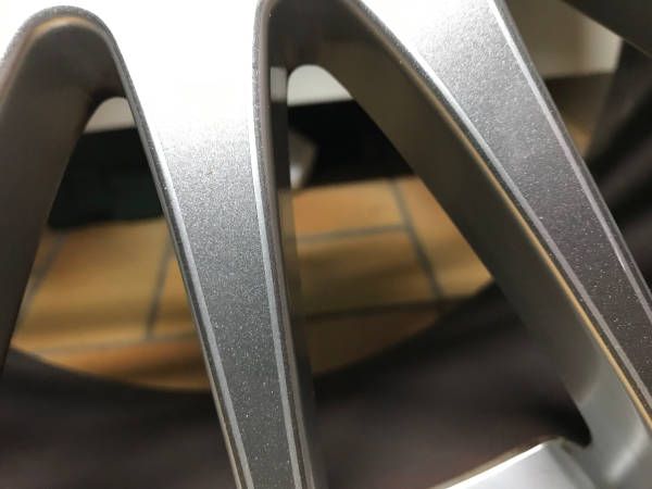

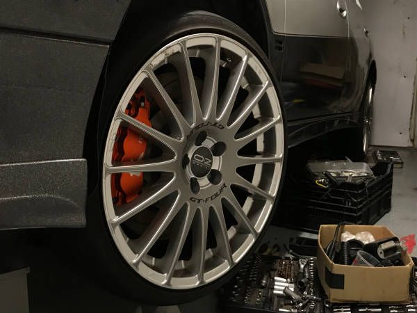

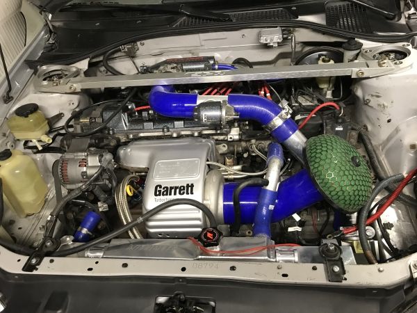

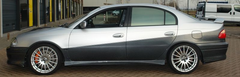

I have started on the upholstery of my Toyota Avensis. This car has been swapped from 1.6 to a 2.0 turbo engine. Drivetrain is swapped from FWD to AWD. MoTeC standalone ECU, Garrett dual ball bearing turbo upgrade, W/A top mount intercooler swapped to A/A FMIC. 356 mm 8 pot front brakes, Fidanza flywheel, Mishimoto radiator. Painted inside and out in 2 tone with House of Kolor Rainbow flakes through the clear coat. RPM gauge changed from 8 to 9k. Mocal oil cooler and filter relocation. Dolby 5.1 and DTS audio. Sparco seats.

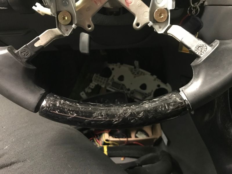

I am working on the steering wheel at the moment, made the bottom of the steering wheel in forged carbon

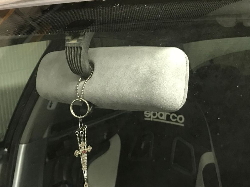

I wrapped the Rear view mirror in Alcantara.

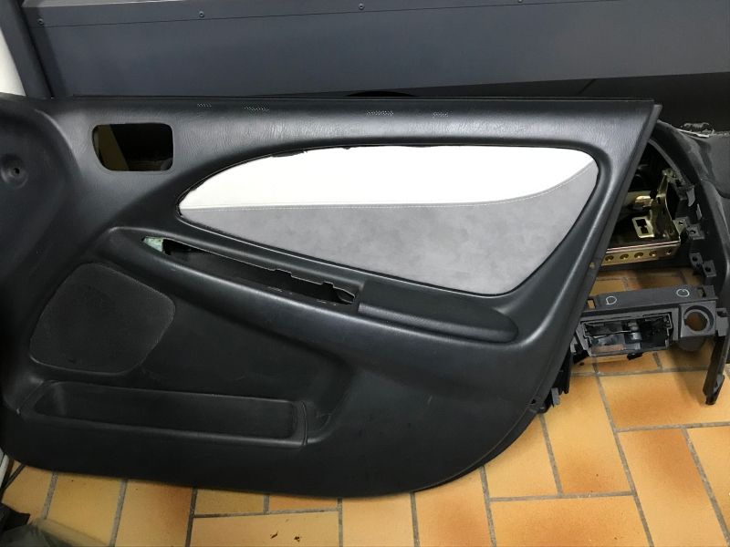

The line on the side of the car is used on the insert of the doorcard. (insert is not glued in place yet).

The bottom of the steering wheel in forged carbon

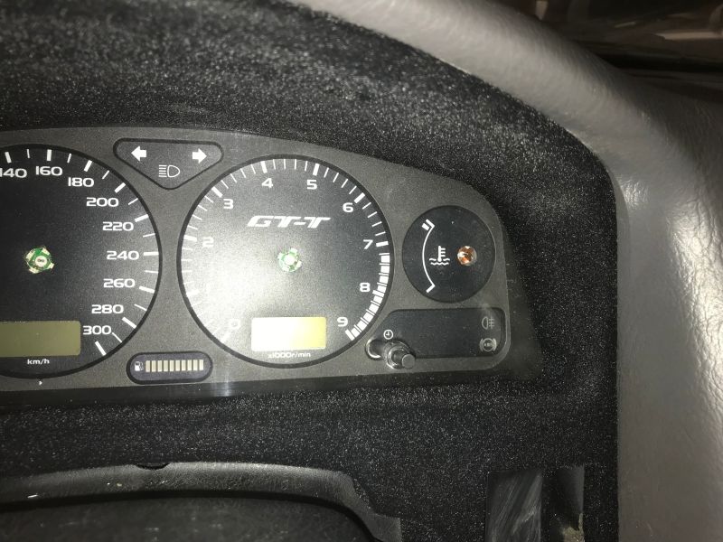

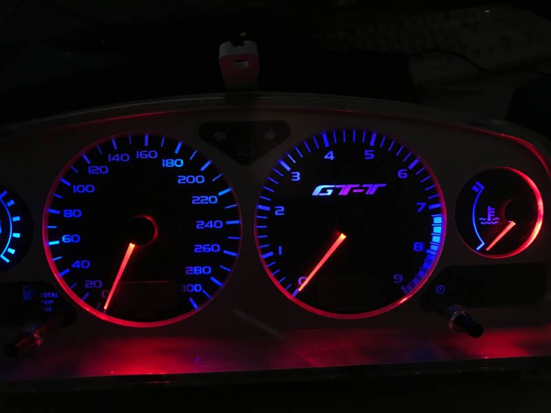

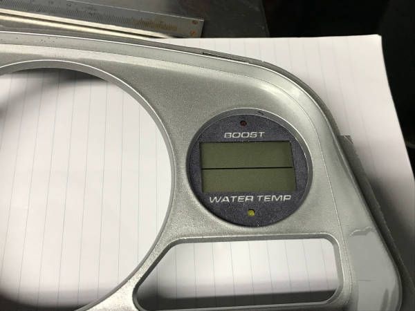

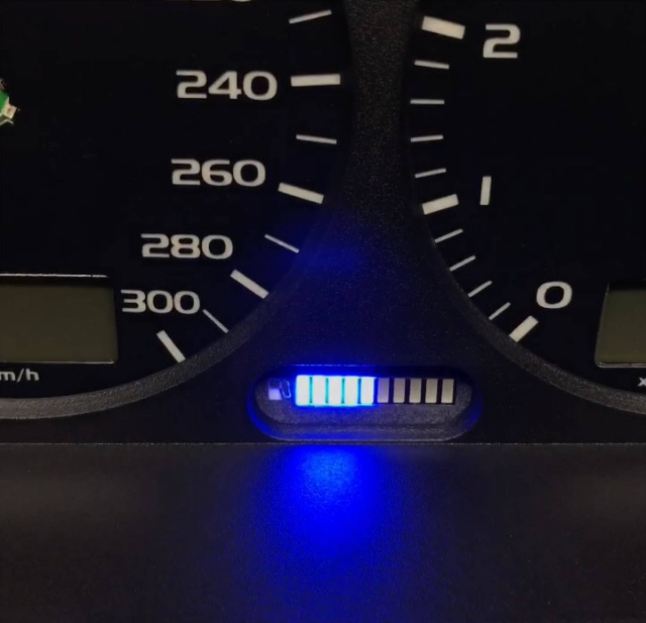

The dials with 9000 rpm tacho, fuel gauge is deleted and a digital one installed in the bottom of the cluster, engine temp gauge is removed. At the fuel and temp gauge i am now installing SPA dual digital gauges.

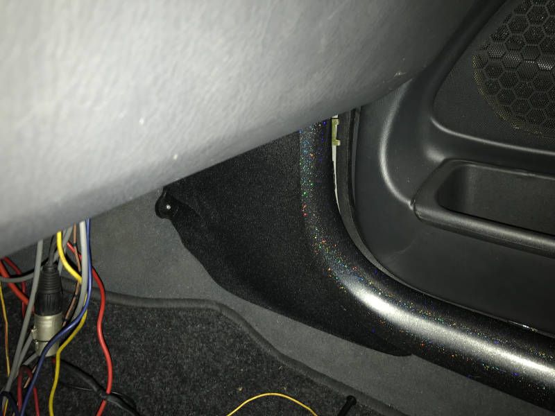

Flocked the kickpanels black

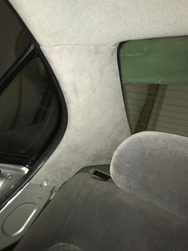

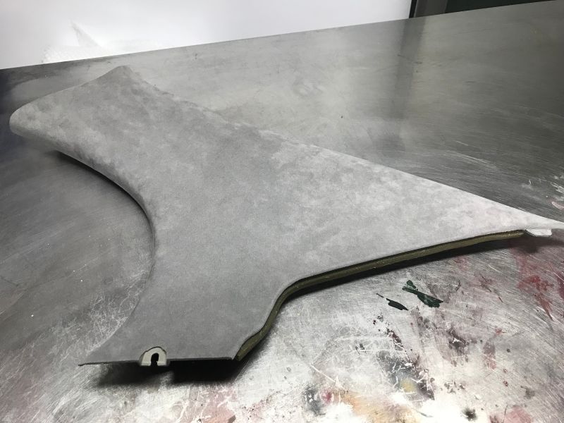

Wrapped the C pillar in Alcantara

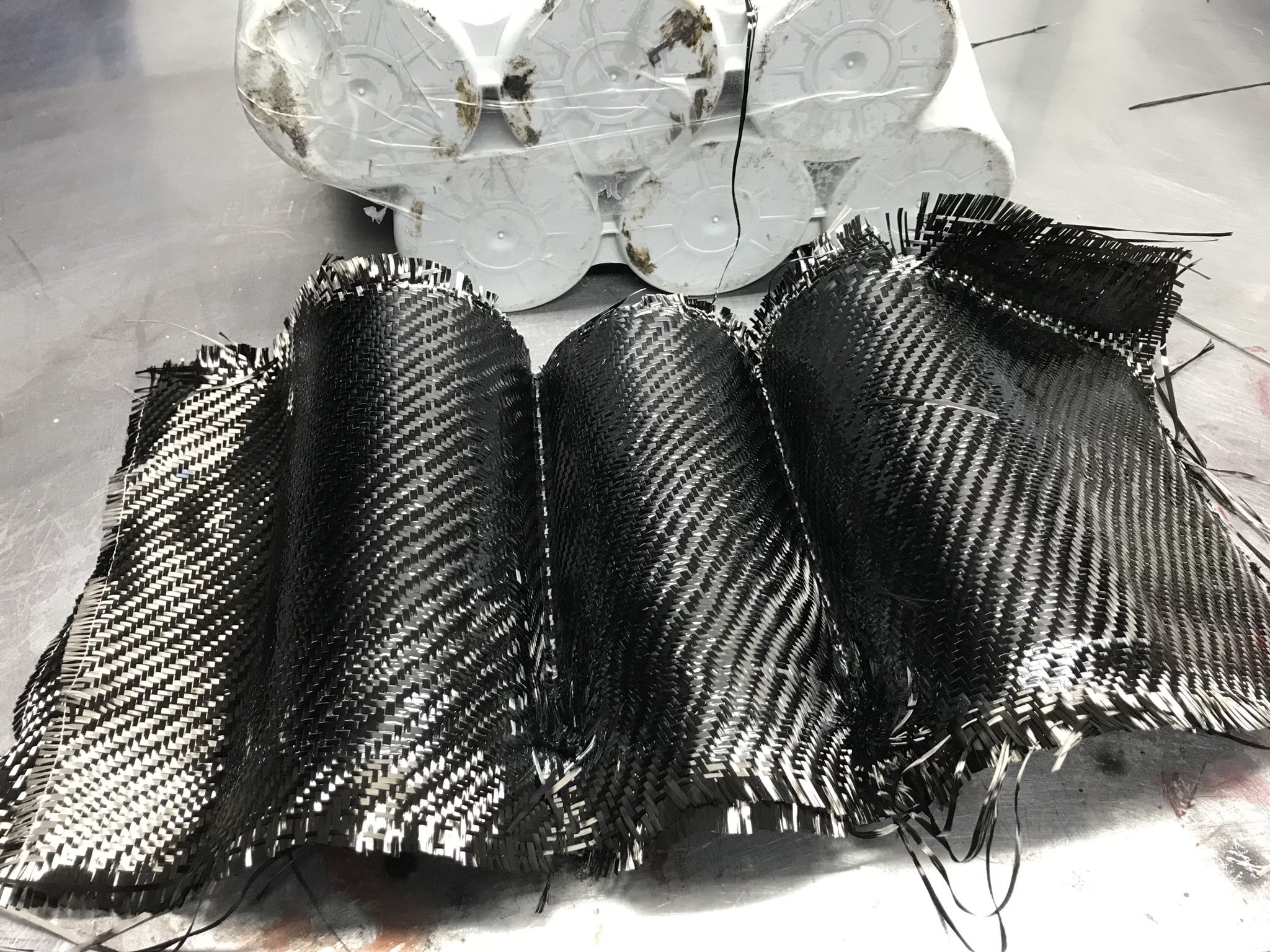

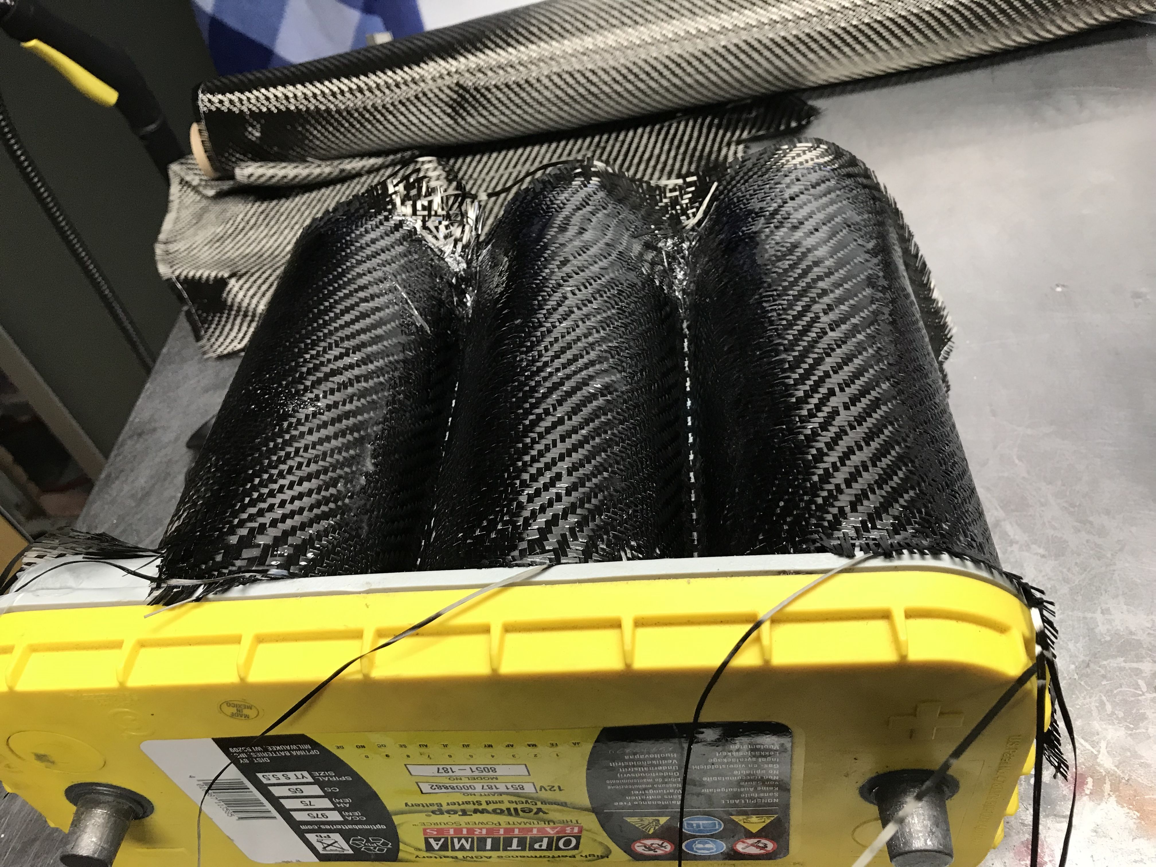

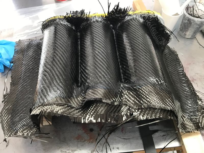

Making carbon fibre bracket for the battery.

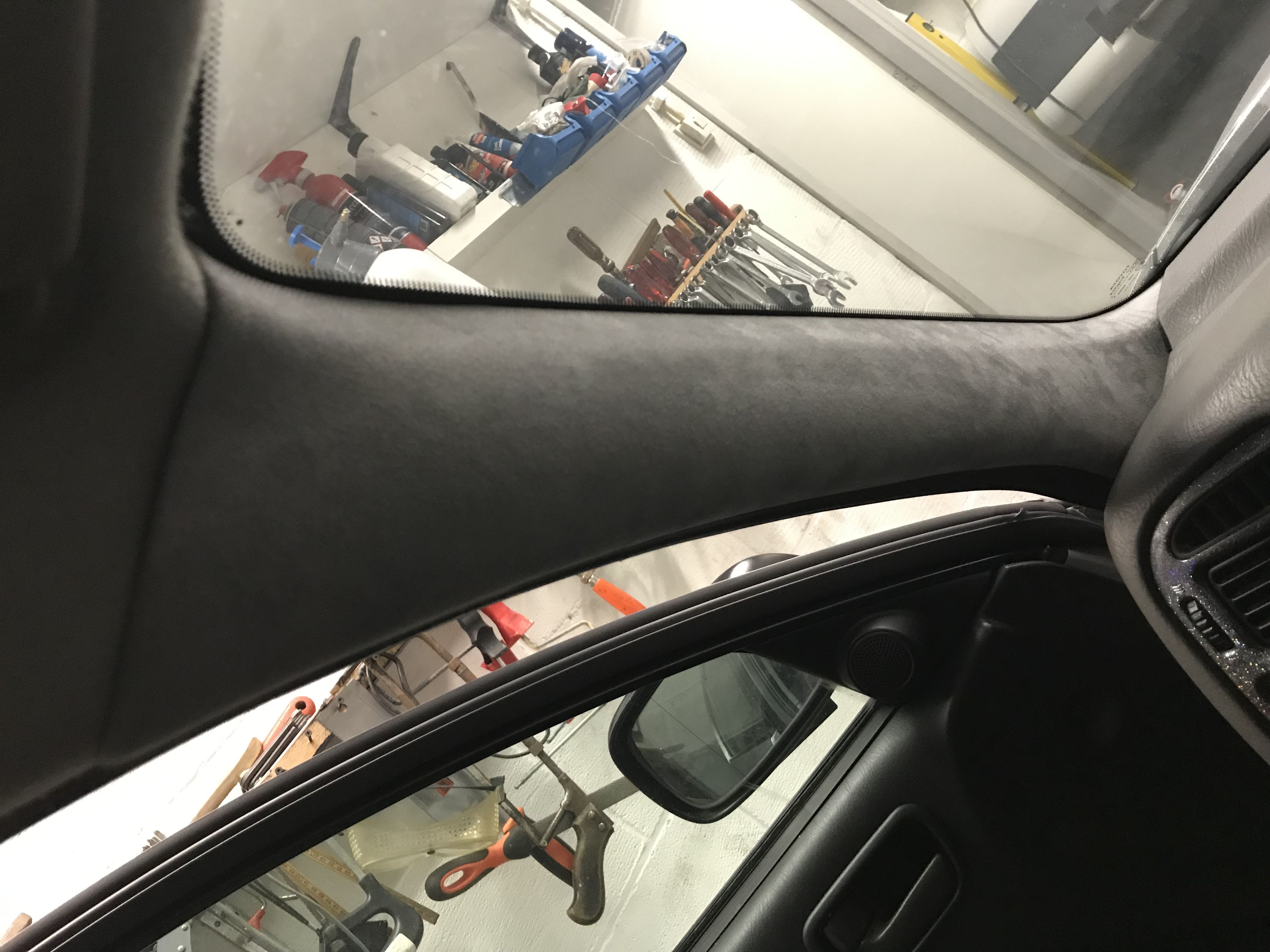

Wrapped the a pillar with alcantara

They also sold other brands, but this colour had the word ALCANTARA stamped on one side on the edge. I have no piece left of that side unfortunately to make a picture.
It is called Orion Grey. The colour number is the same as on another website that offers real Alcantara. So i am 99 percent sure it is real alcantara.

First 2 layers of carbon are almost dry.

#10093
Added layers of Carbon to the battery bracket and made a flange at both sides where the bottom carbon piece can bolt on to.
When it is fully dry i can cut it to the desired shape.
