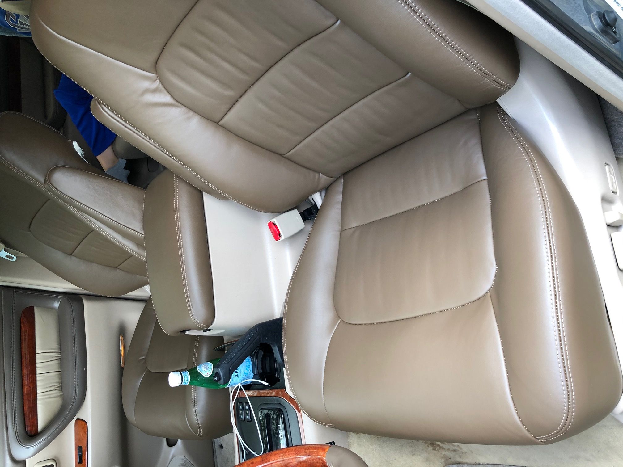

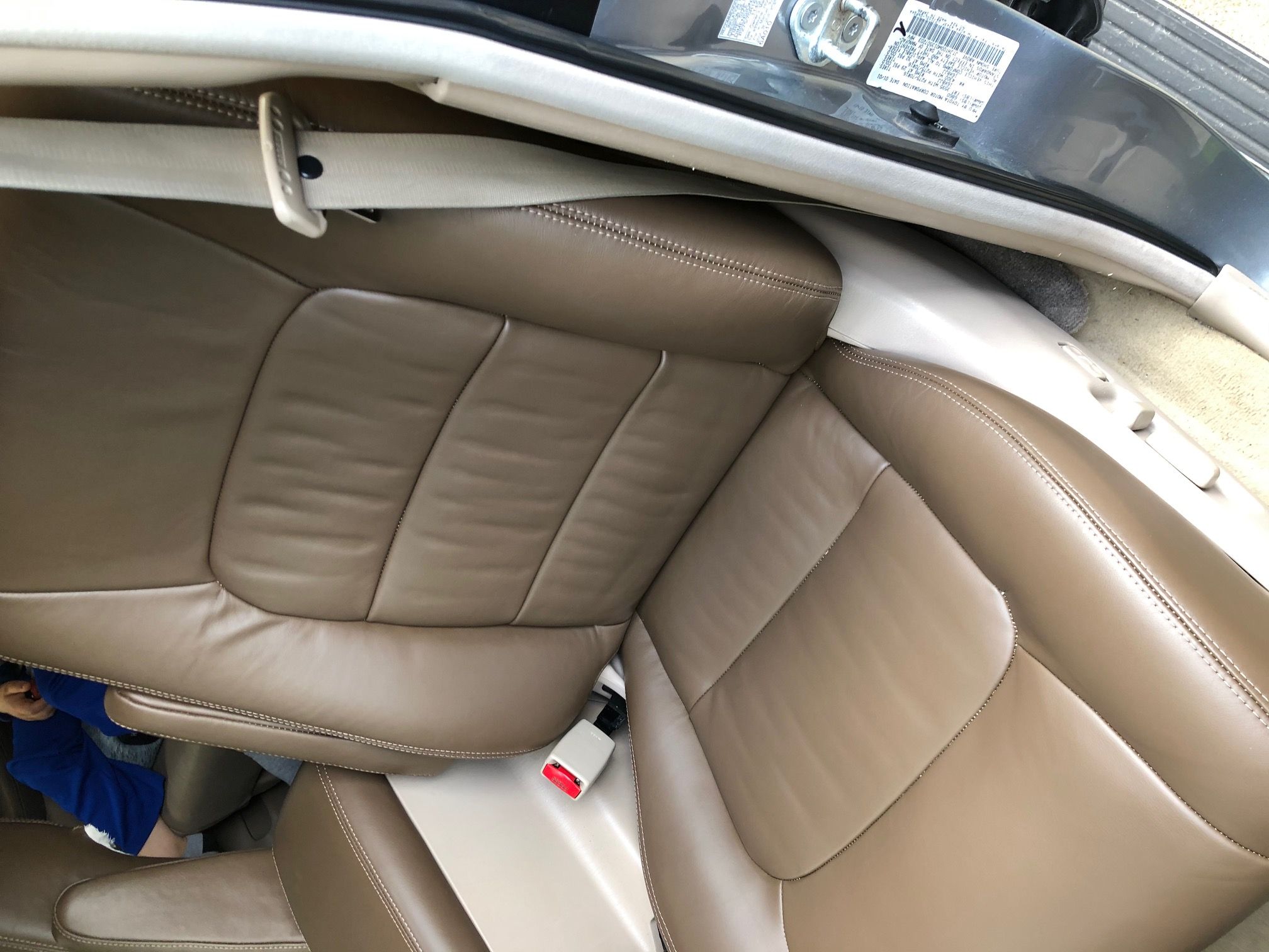

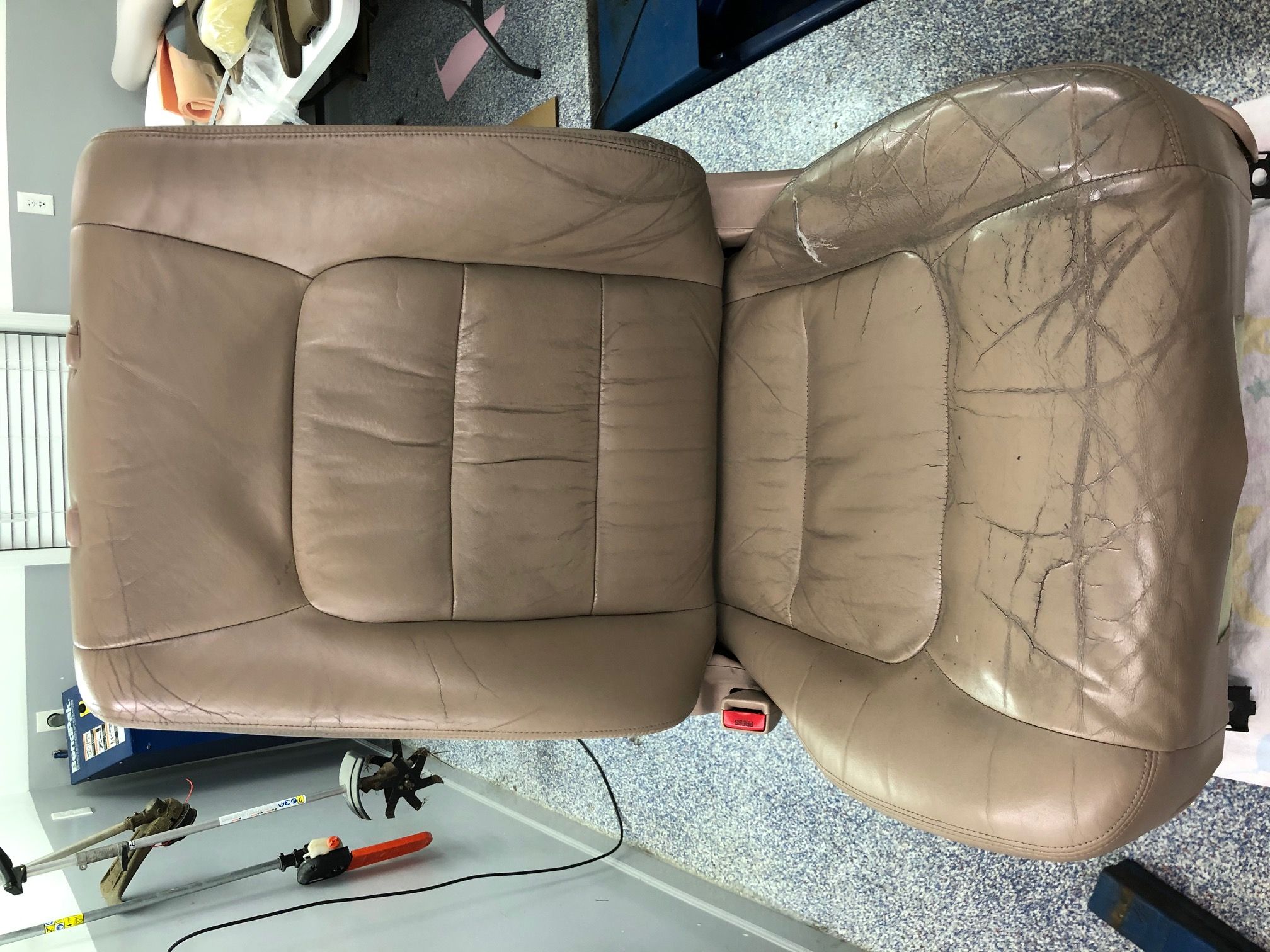

This is first one for me. Man it takes so much time!!! So far 2 front seats done along with center console.
Some before and after pics. I also replaces bottom foam on drivers seat. And there is color change.
Leather was sourced from eBay. It's italian upholstery leather.
Now working on rear seat and it proves to be even harder. Much more smaller pieces.
Wrinkles in a middle is interesting topic! I was asking how to do it, and I read how hard is it to duplicate. It was easier than I thought. Factory glues felt with pre-made pattern. I just had to transfer it to new leather. Will be PITA if you produce aftermarket covers, but for re-doing interior it's just additional work.

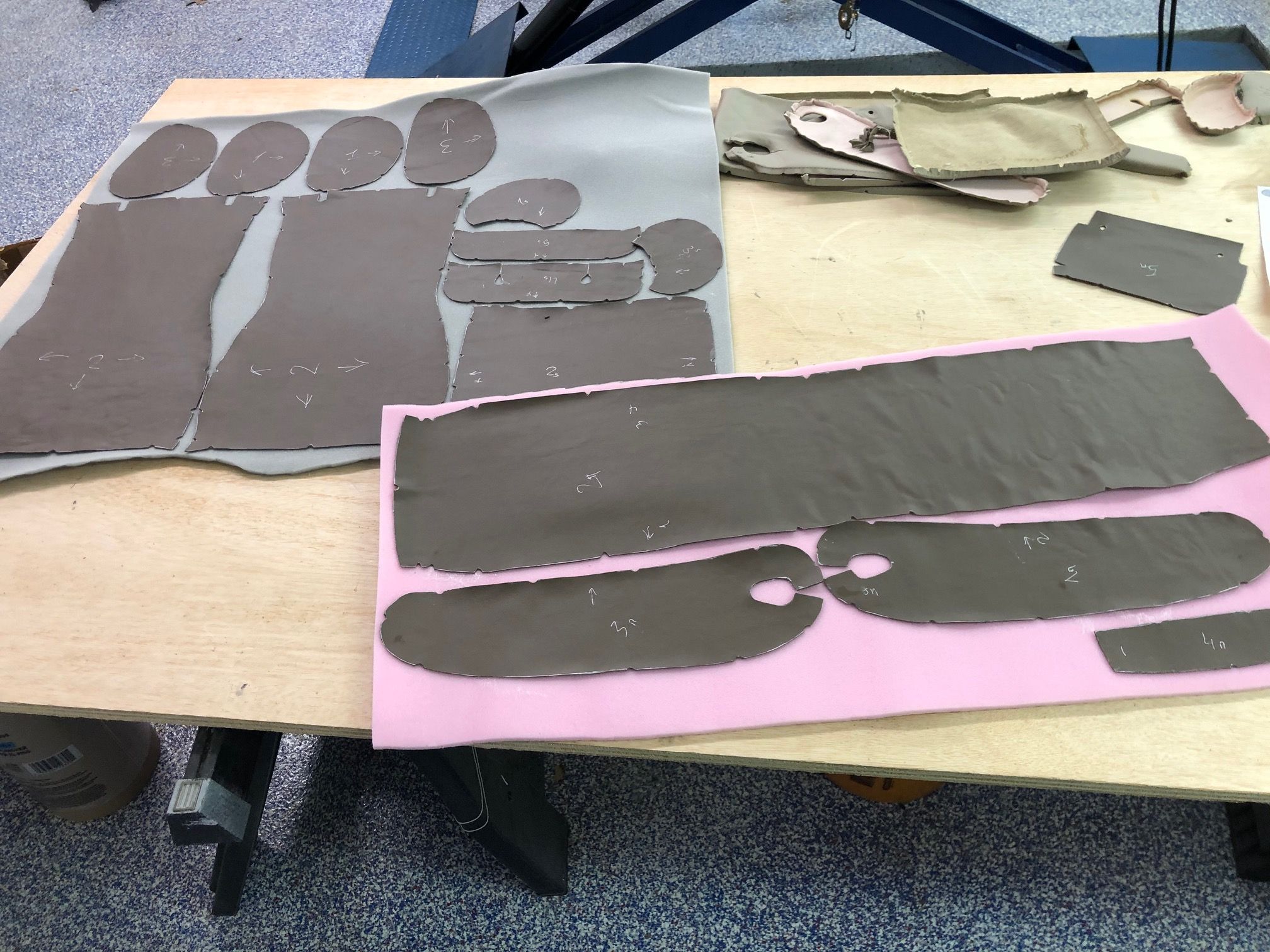

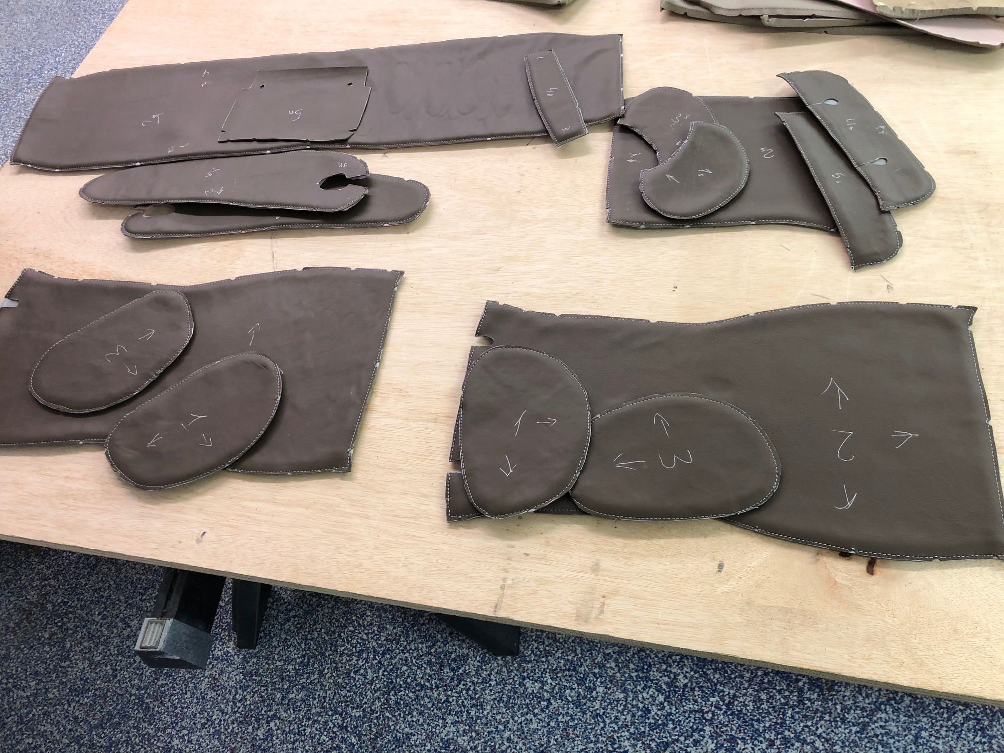

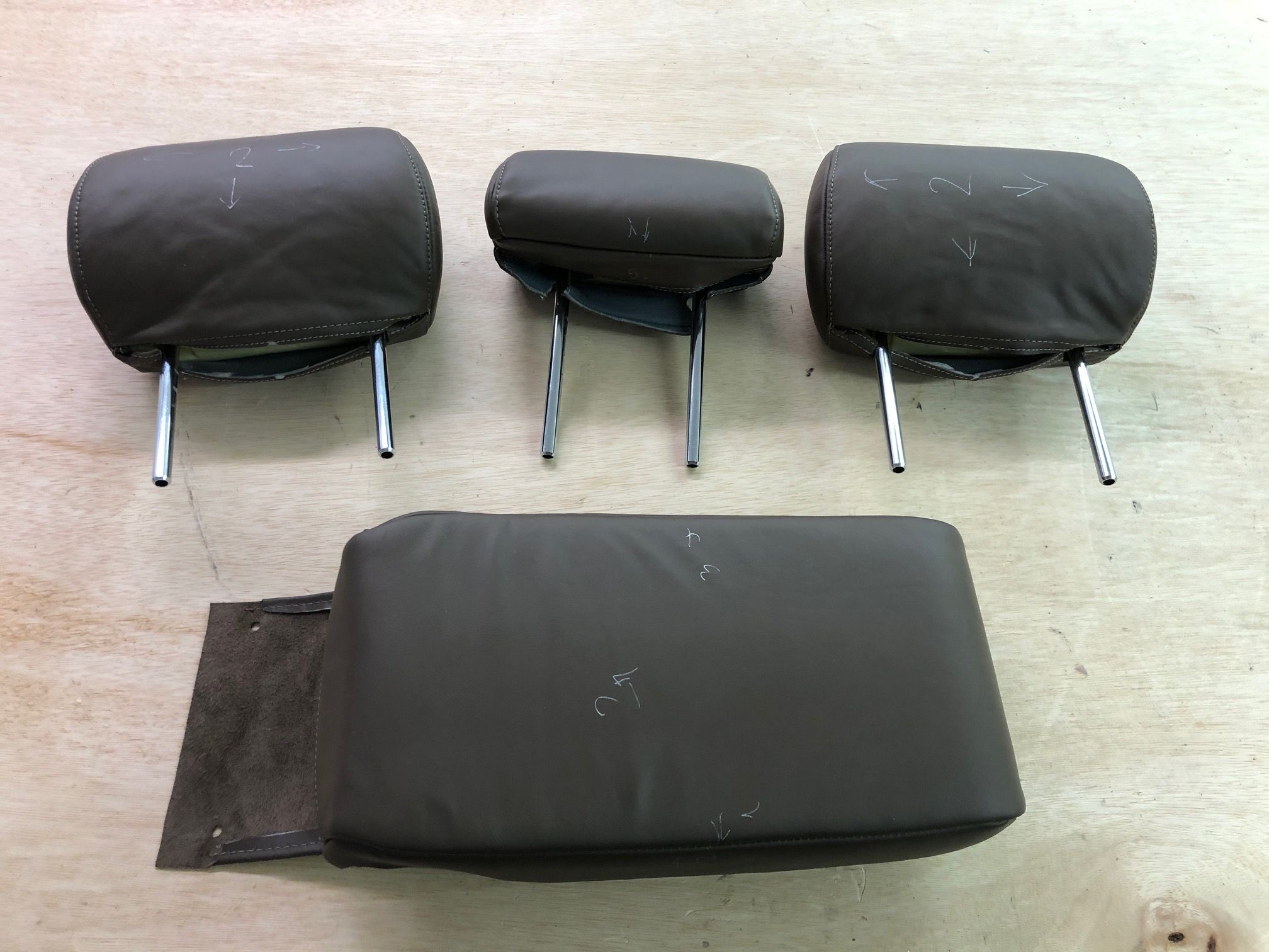

This is what full work day (or 9hr) looked like. 3 rear headrests and armrest. Take apart, document, templates, scrim foam, sew, assemble.
And I still need to hand stitch all of them which will take 1hr. And clean/steam. How much faster pros do those?
#10726
Your making good time. I would estimate around 7 hours for those 4 pieces.
