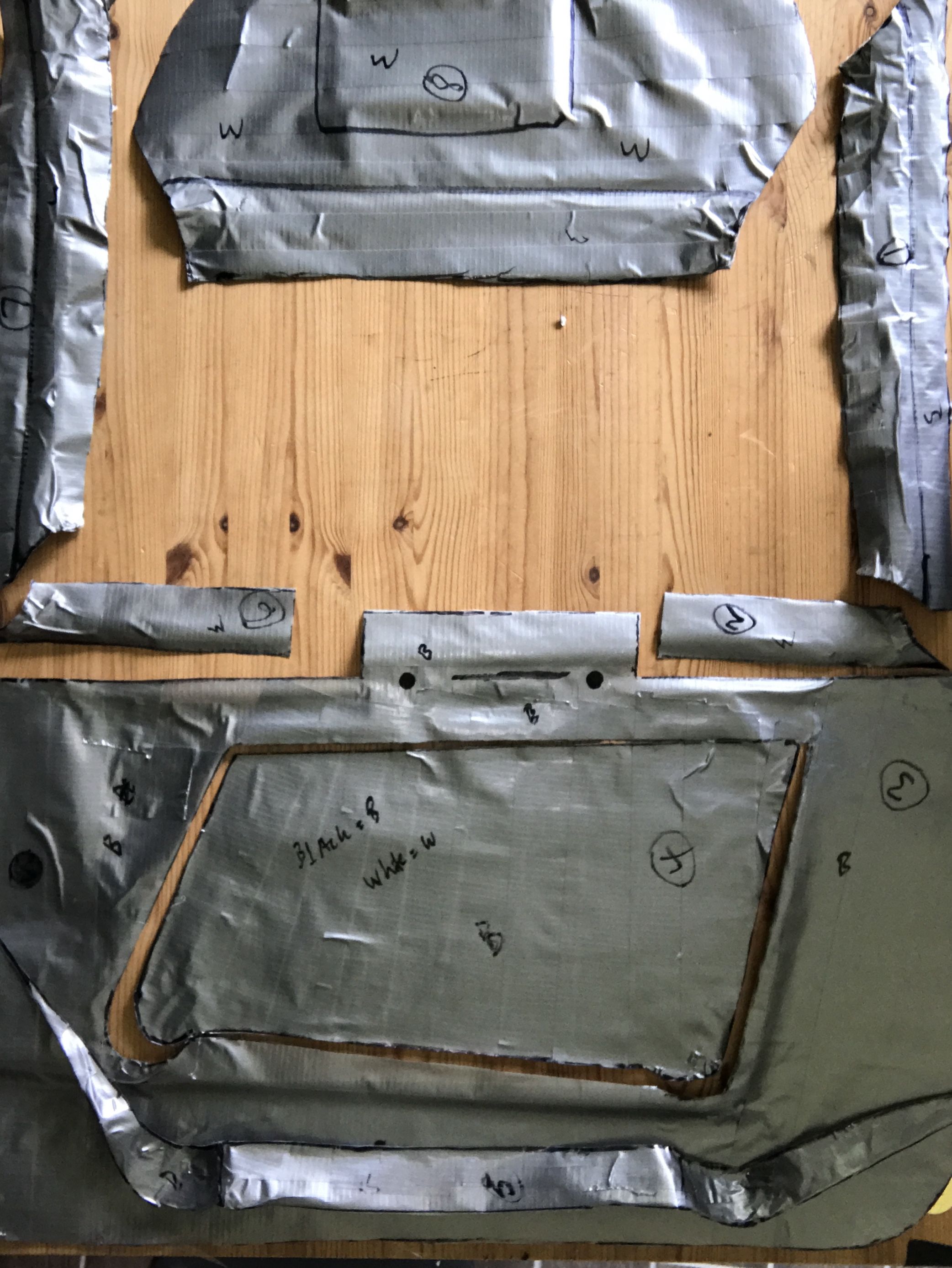

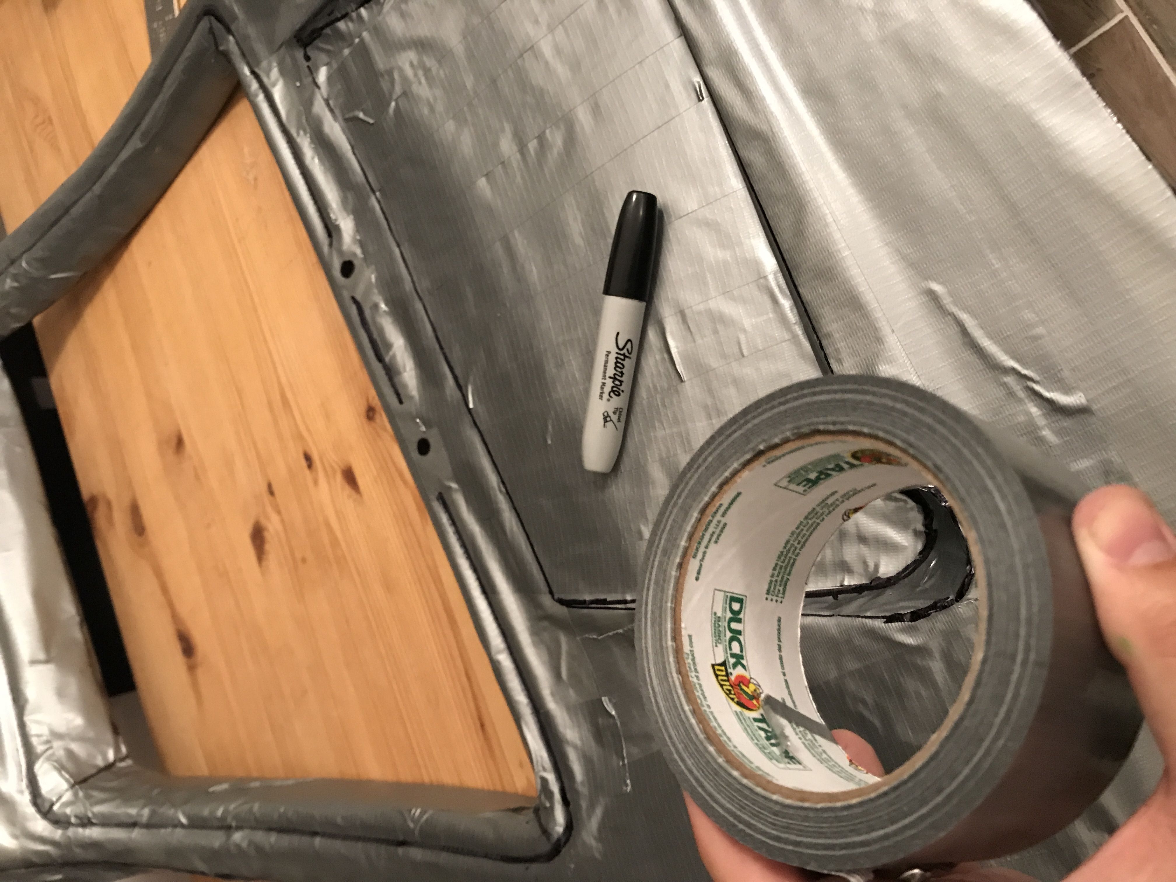

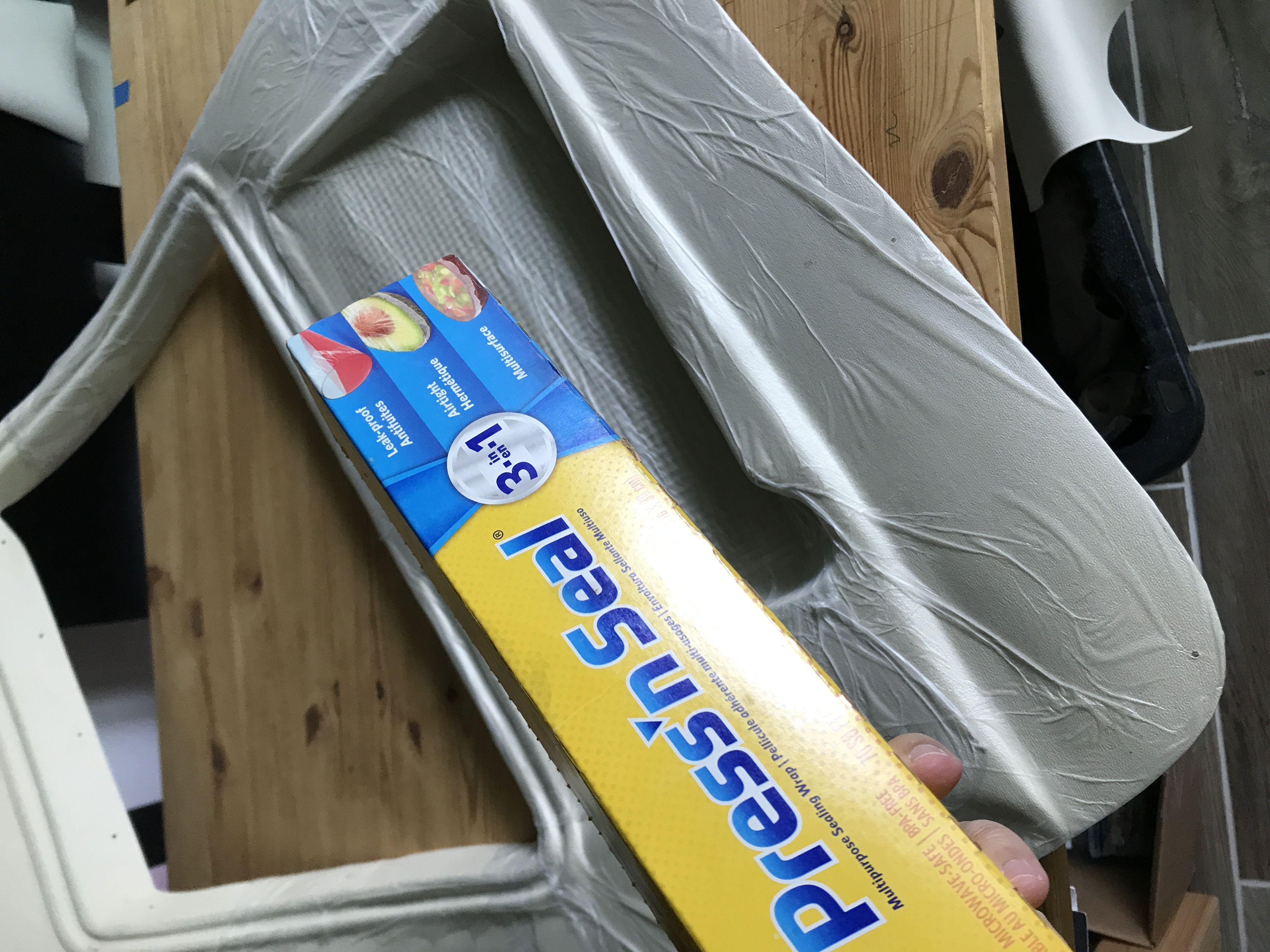

I made a panel template, using Ducktape and Glad Press'N Seal, to cut out vinyl pattern that will be glued to panel. I tried stretching and heating the vinyl (4 way stretch fabric backed) but it would not work well around arm rest. I got the duck tape idea from a costume designer. Does anyone have other methods they have tried and worked well?
#11331
Ive never seen anyone use press'nSeal for patterns. Its a good idea! Thanks for sharing.
My go to pattern material is clear vinyl. But on door panels like that i would use 6 or 12 inch transfer tape. You can get it on Amazon https://amzn.to/2QbUURQ
