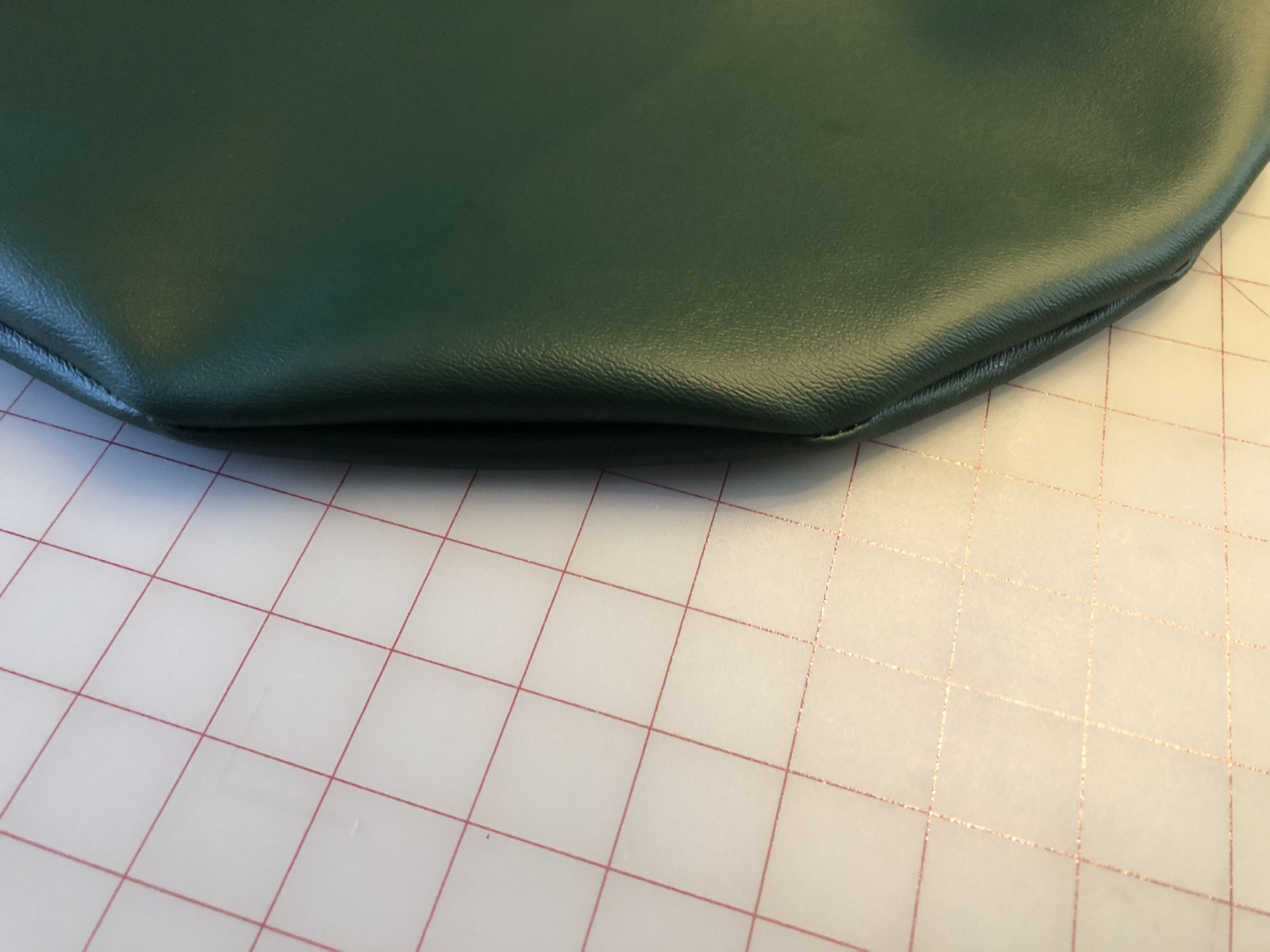

#14780
@BigRig I have put some thought into your original question, and I would probably want a Consew 369RB. I have been running into issue with top stitching different types of parts and feel a post bed would solve the issues. I have had issues on headrest, shift gators and now a 2" boxed full cushion cover without a zipper for use in a ward.

By JimmieJoe
#14802
How would you top stitch this with a flat bed? Seem you would need a post to do it easily and without frustration.
#14829
Its hard to tell from the pictures but it looks fairly large. Should be pretty easy to top stitch it if you fold it inside out and top stitch it that way.
By JimmieJoe
#14833
This is 2 pieces sew together, no boxing. The material from one side blocks you from seeing the other side. This is similar to the problem I was having with the shift gator. However. With the shift gator there was also not enough clearance around all of the moving sewing machine parts.
#14840
I understand that its two pieces and no boxing. It is very do able on a flat bed machine it just takes a bit of time because you can only sew a few stitches at a time.

By JimmieJoe
#14916
Thanks. Seems most of your time will be spent managing the material. I am currently running into another similar issue on a 71" x 18" x2" full cushion cover with no zipper, and trying to figure out how to top stitch the final panel. There is no zipper, so the final seam has to be sewn closed after you get it stuffed.

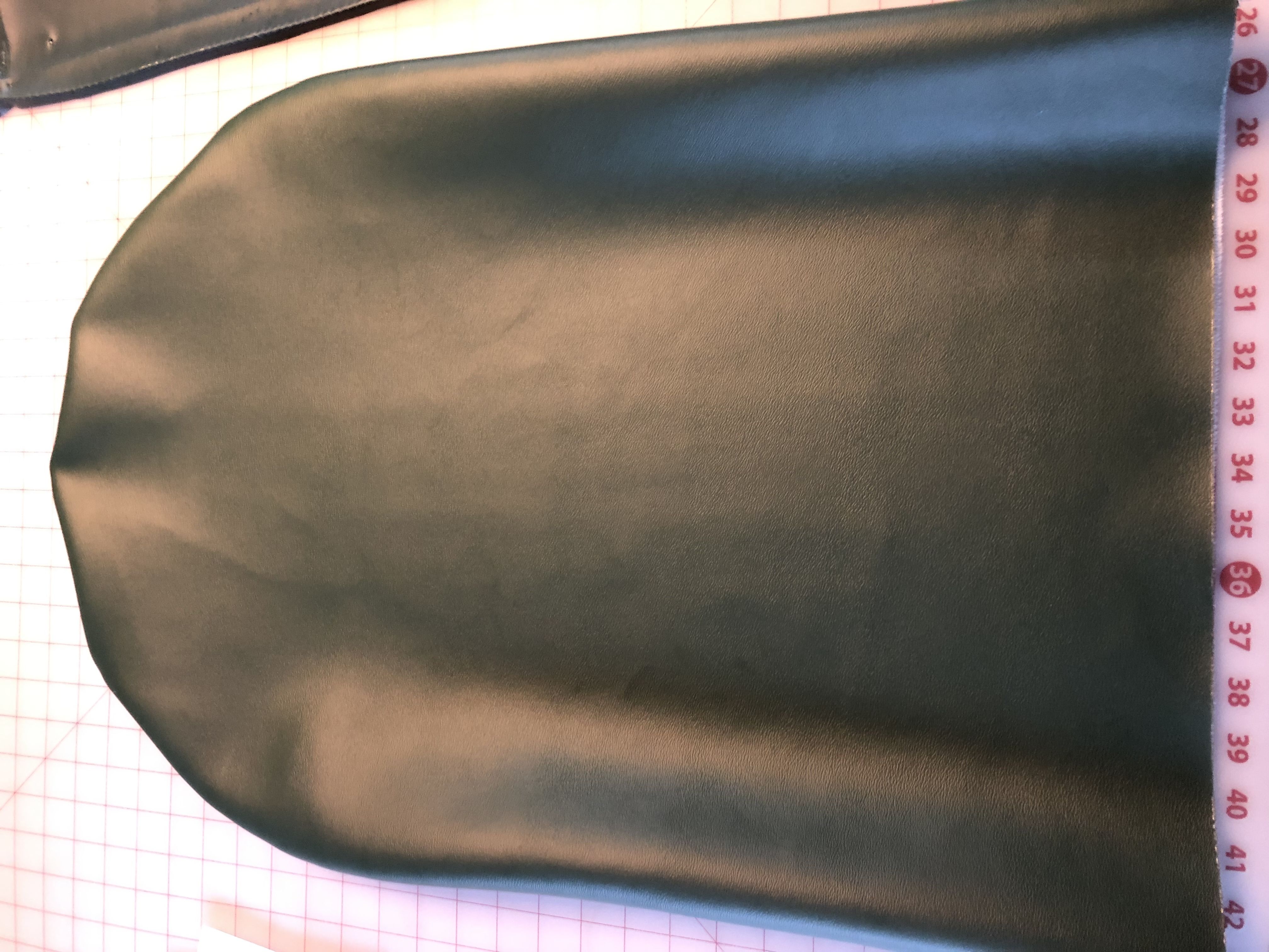

By JimmieJoe
#14918
Here you can see the top stitch I already put in, but not sure how you would put in the other side.
Any thoughts on how to get the topstitch in the portion that has to be hand sewn closed.
