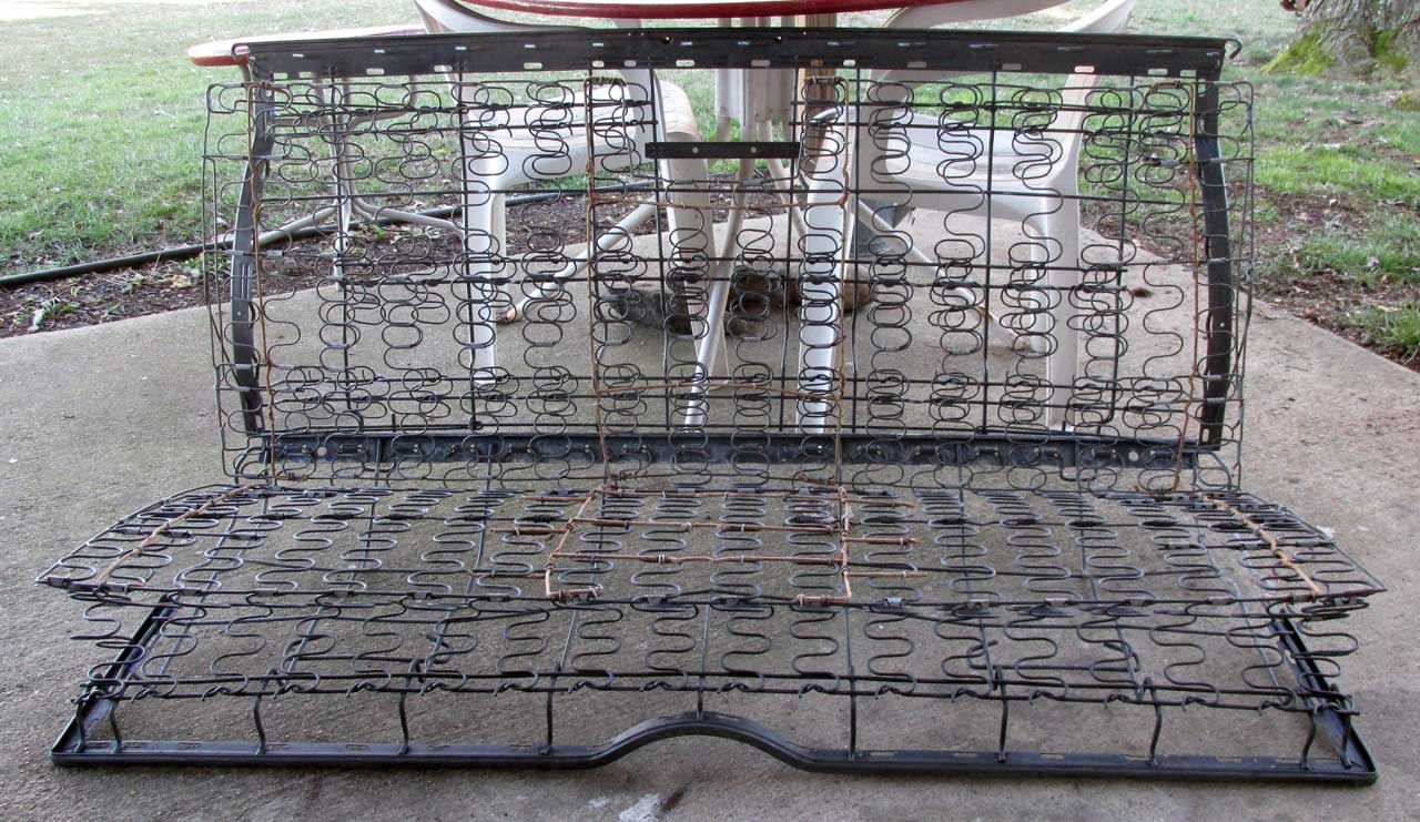

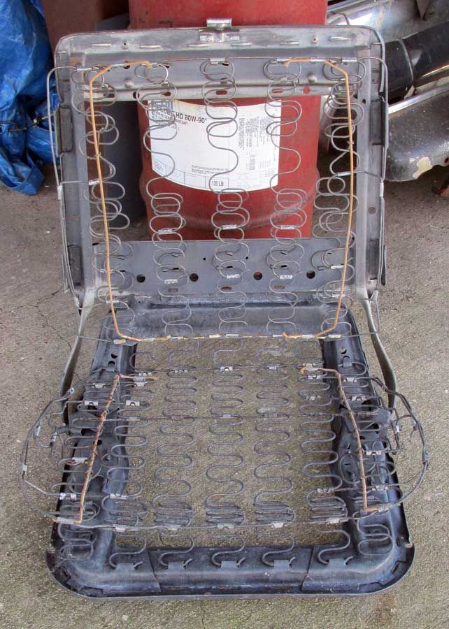

I'm prepping to refoam the seats on a '65 Impala and hoping to benefit from others experience. Instead of using buns I'd like to build up using sheet foam. Density will be 2.8 for longevity but foam weights are my sticking point. Some are suggesting extremes of a very heavy foam (100#) for the base and very light (12#) for the backs. In addition I'm hearing thickness from 1" max total to 2" nominal.
The original foam is so far gone it's impossible to confidently gauge the factory weights or thickness. Would probably be difficult anyhow considering it was most likely poured/molded latex. The rear seat back was also 100% stitched cotton batting which I'd prefer to replace with foam. I'll be using polyester batting elsewhere when appropriate.
My thinking is the following:
Bucket seat bottom - Heavy denim decking / 3/8" rebond foam / 1" 70# foam sheet / Bolsters built up as required
Bucket seat backs - Heavy denim decking / 1.5" 50# foam sheet / Bolsters built up as required
Rear bench seat bottom - Heavy denim decking / 3/8" rebond foam / 1" 70# foam sheet
Rear bench seat back - Heavy denim decking / 1.5" 35# foam sheet
I was looking to make the seats a little firmer than the extremely soft norm of the 60's style. With that in mind I added one additional spring wire across each seat bottoms to tie the ziggers.
Been putting this project off for far too long so any and all suggestions most welcomed.

You plan for foam choices looks solid. One thing I will say though is that if you are looking to prevent the soft norm of 60s style... This is caused by the spring seat structure. You can put any density and it will still be soft from the springs. The bars across the middle will help for sure but it wont make it firm like a solid foam seat.

The heads-up regarding seat suspension being the driving factor in overall firmness is good info and makes 100% sense. I can understand how a firmer foam will be more so only "skin deep". Thankfully my intention is not to totally remove the original character of these seats so hopefully my modest mod (single crossbar) will prove the sweet spot.

Personally I dont use rebond foam at all just regular upholstery foam. There is no reason you cant use rebond. Rebond is pretty firm so that should help you. The most important thing is to put down the layer of denim over the springs. Otherwise the springs will eat the foam up. I actually use discount Black vinyl but denim works fine. Just dont use the orginal style burlap unless you enjoy vacuuming your carpet every time you sit in the seat. LOL
