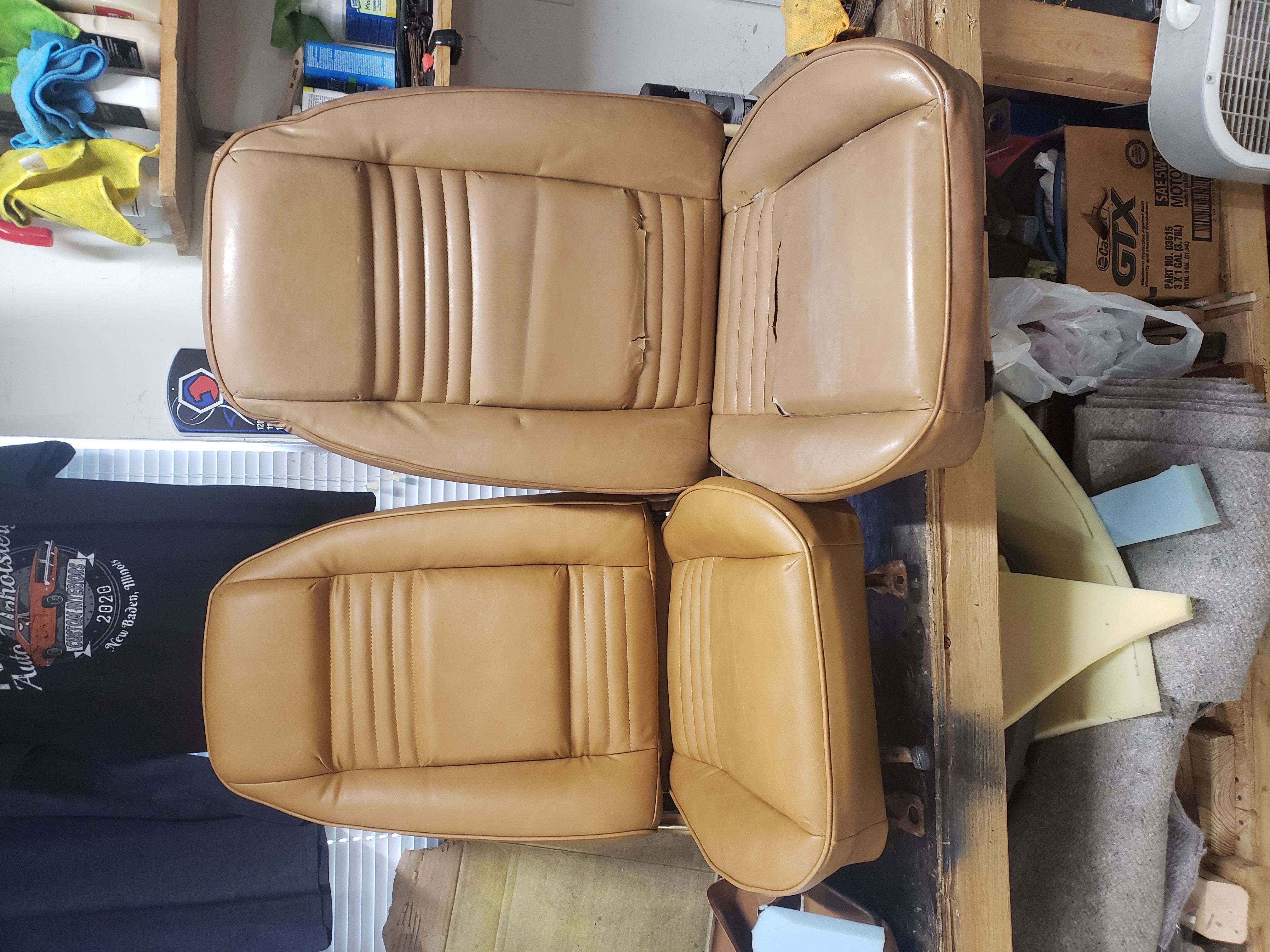

Here is the original appearing one i did a while back. Next to the other seat before that one was done.
#15244
Yeah dont be offended if he doesn't call back or complains about the price. A lot of people just dont understand how much effort is involved and think a seat should take 2 hours.

#15249
Almost makes me wonder if the original seat was a redo before judging by the darts.
