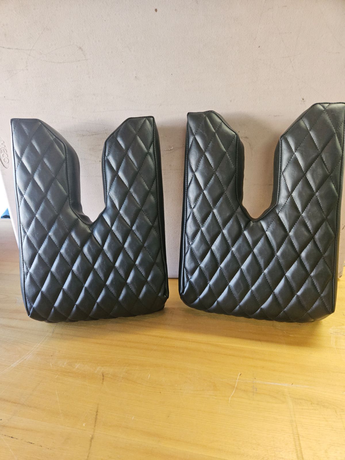

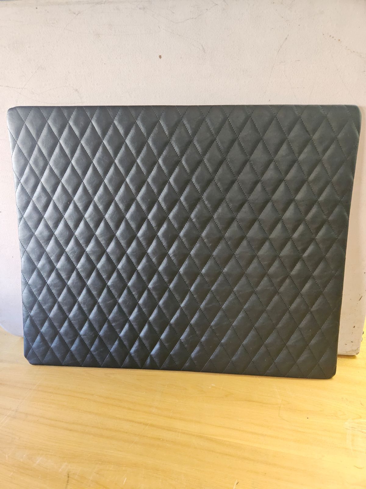

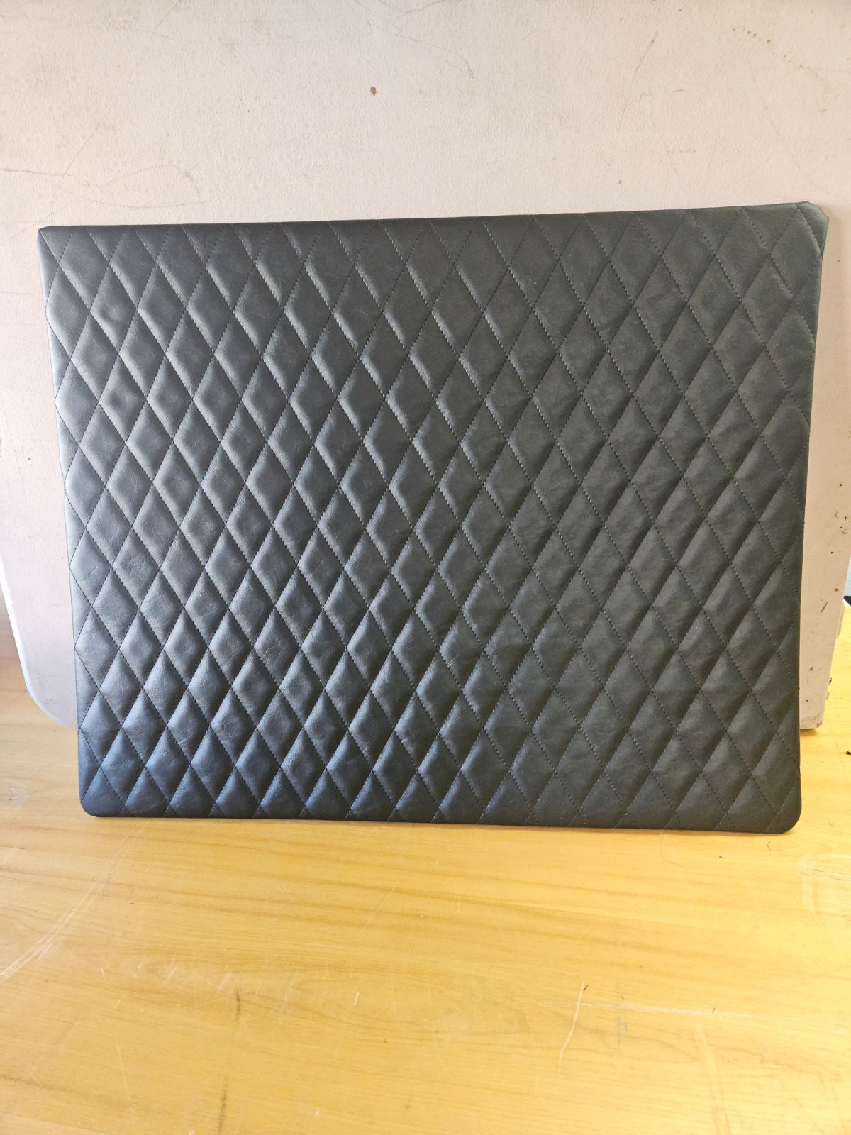

Brian sent us the backing boards for everything as well as the vinyl snap on top that he wanted "modified".
The door panels.

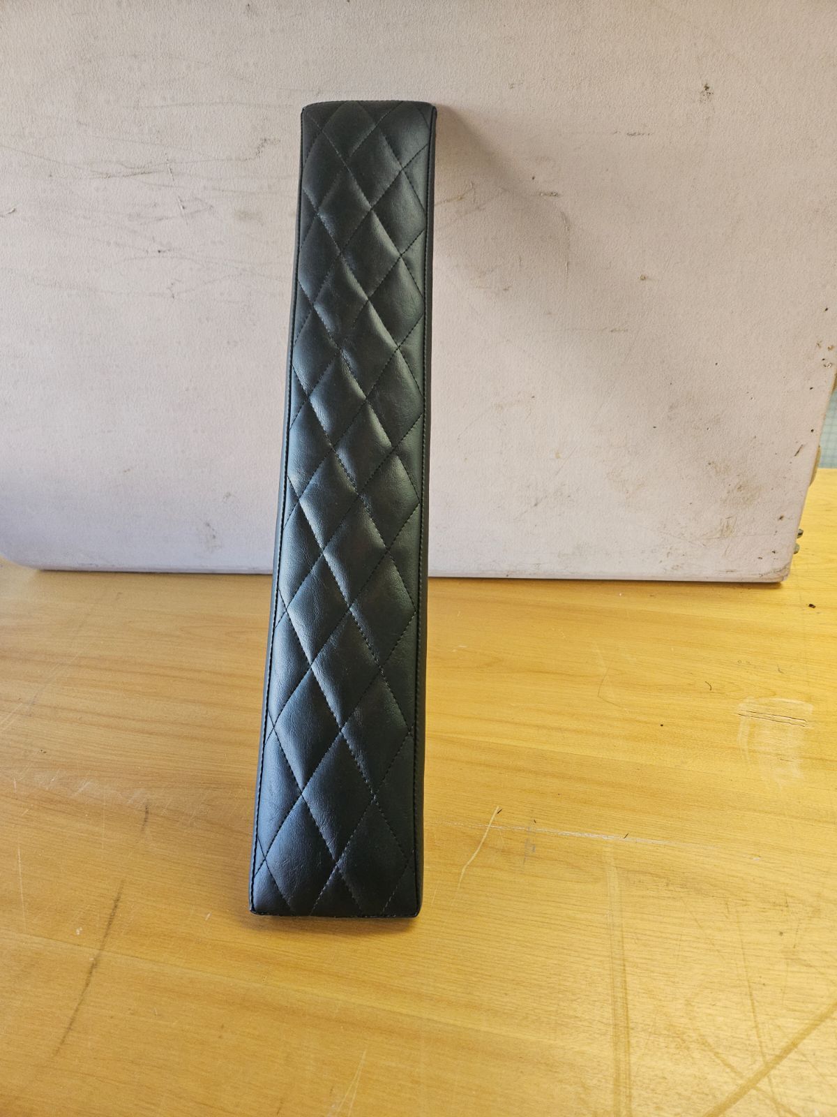

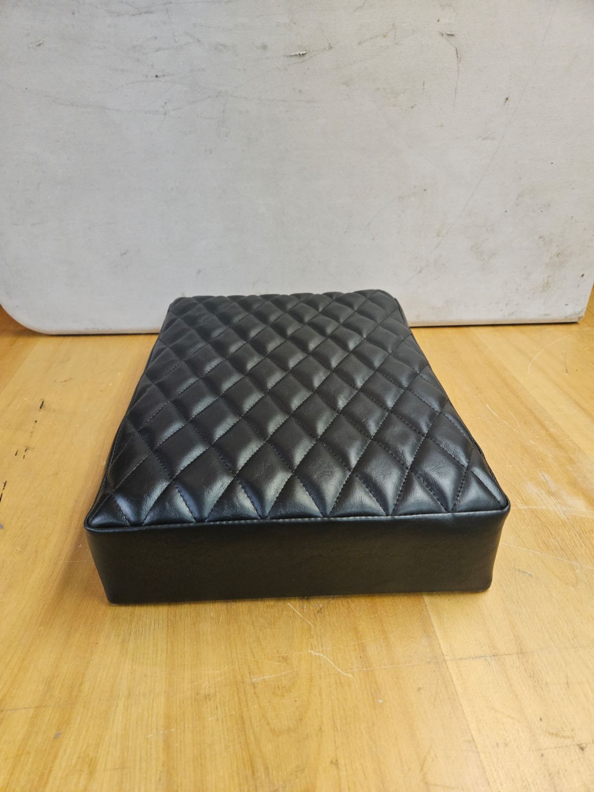

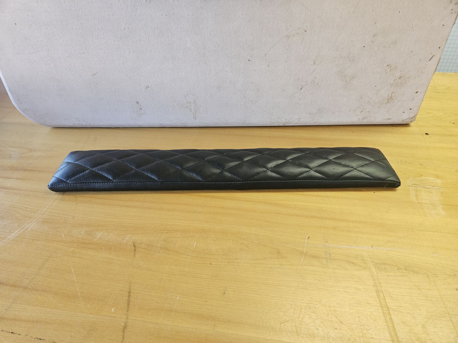

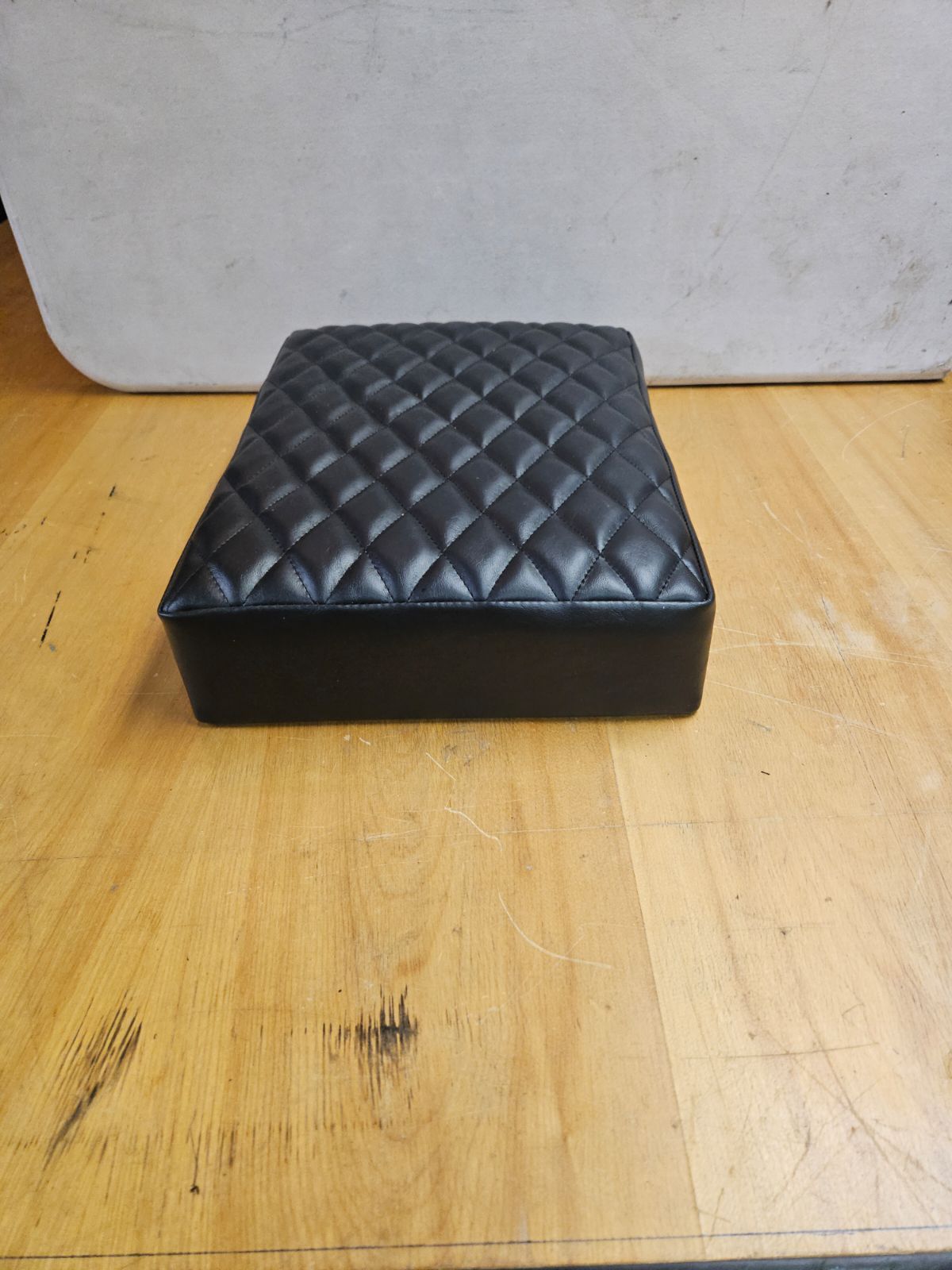

The center console arm rest.....

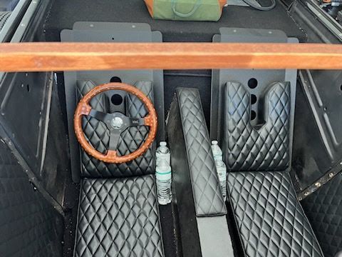

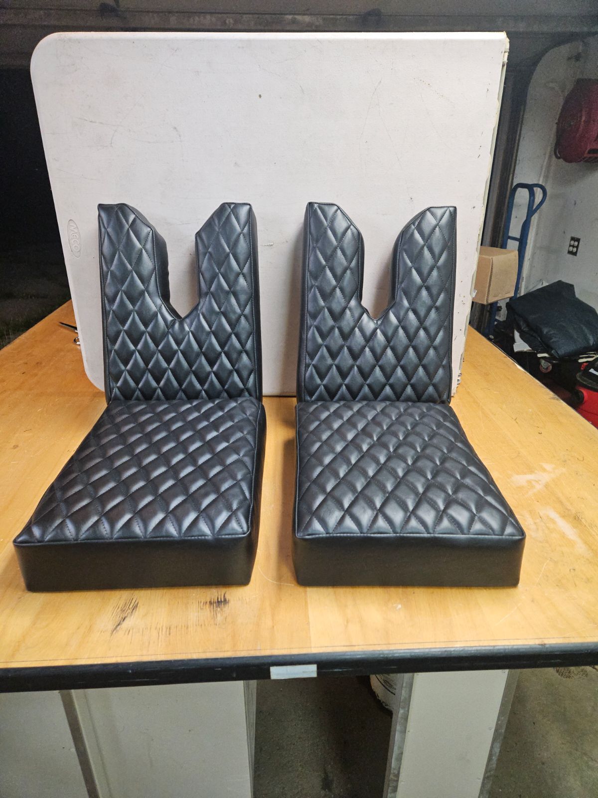

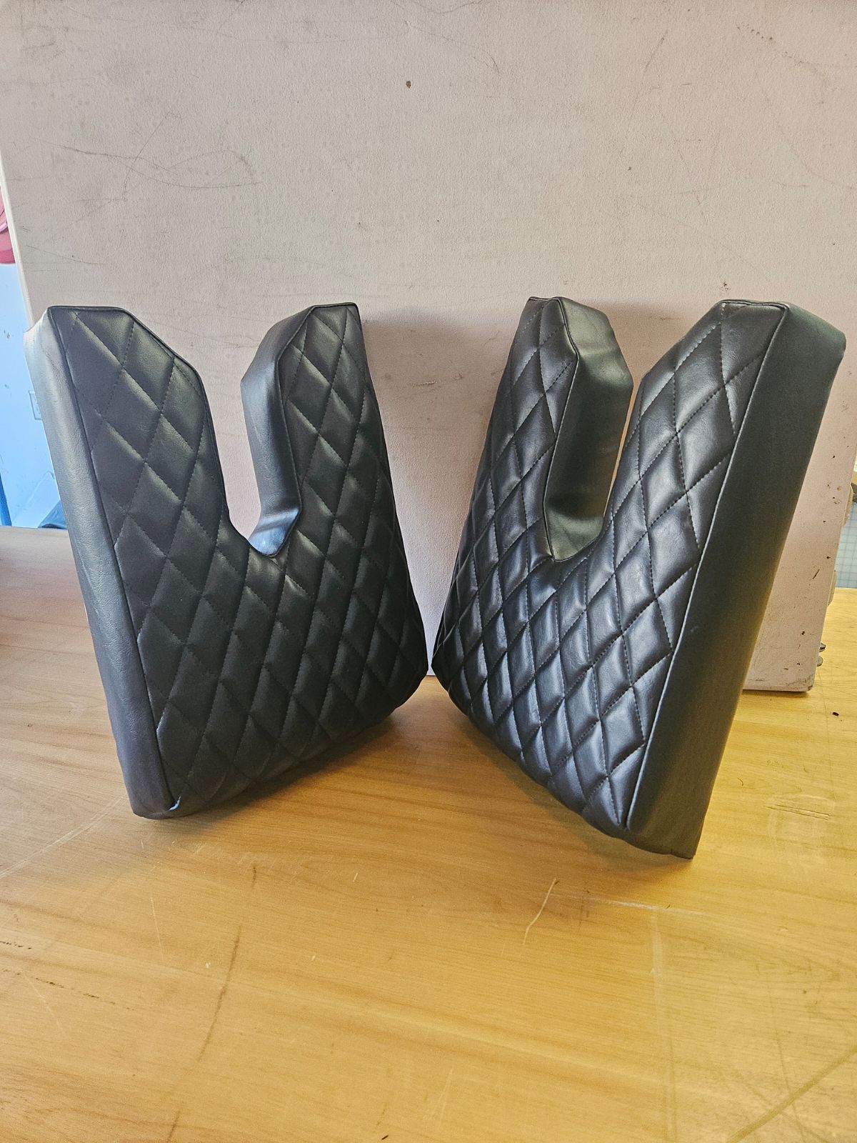

The seat backs..
image000000 (9).jpg (307.69 KiB) Viewed 26050 times
image000000 (10).jpg (246.44 KiB) Viewed 26050 times
I'm not gonna lie, I was a little intimidated by these and not sure if I could get it done. :fearful:

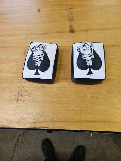

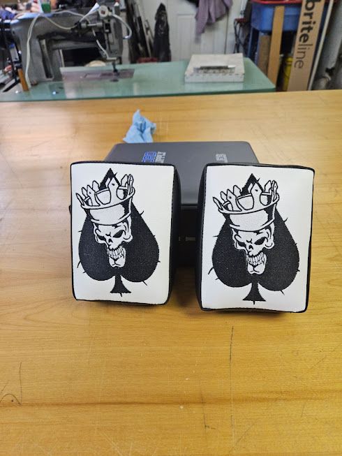

Annie did a little embroidery for the head rests.

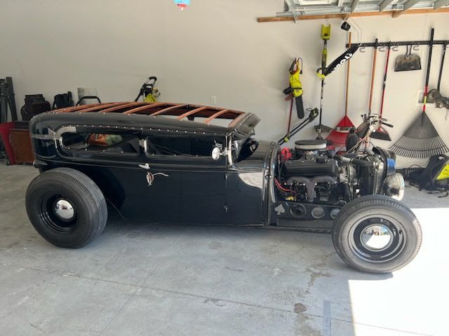

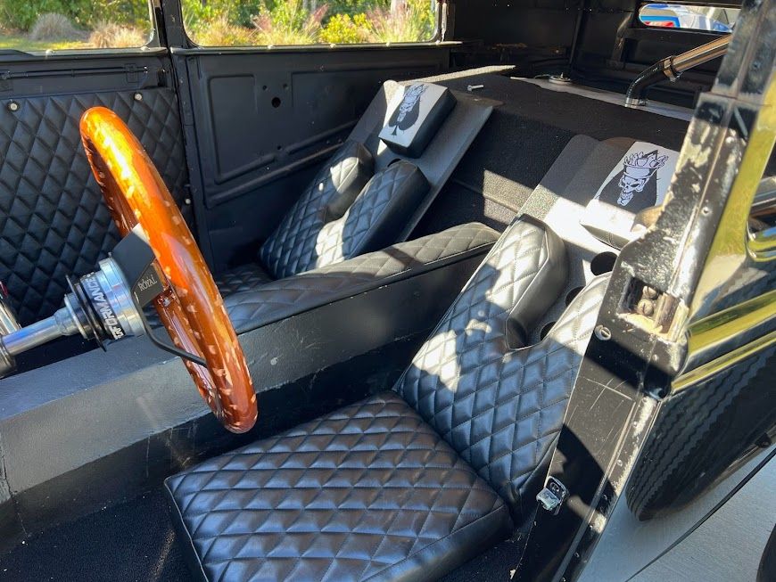

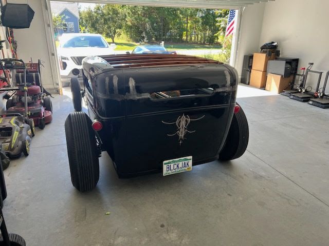

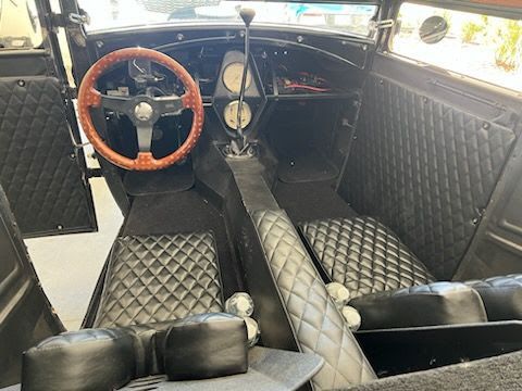

And here's what Brian sent of the interior in the car.....

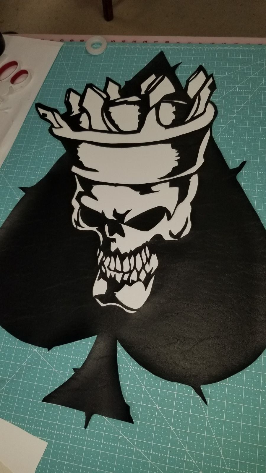

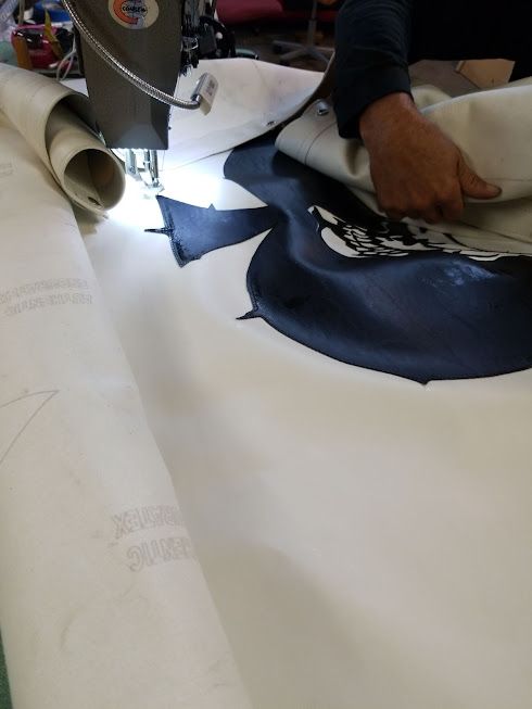

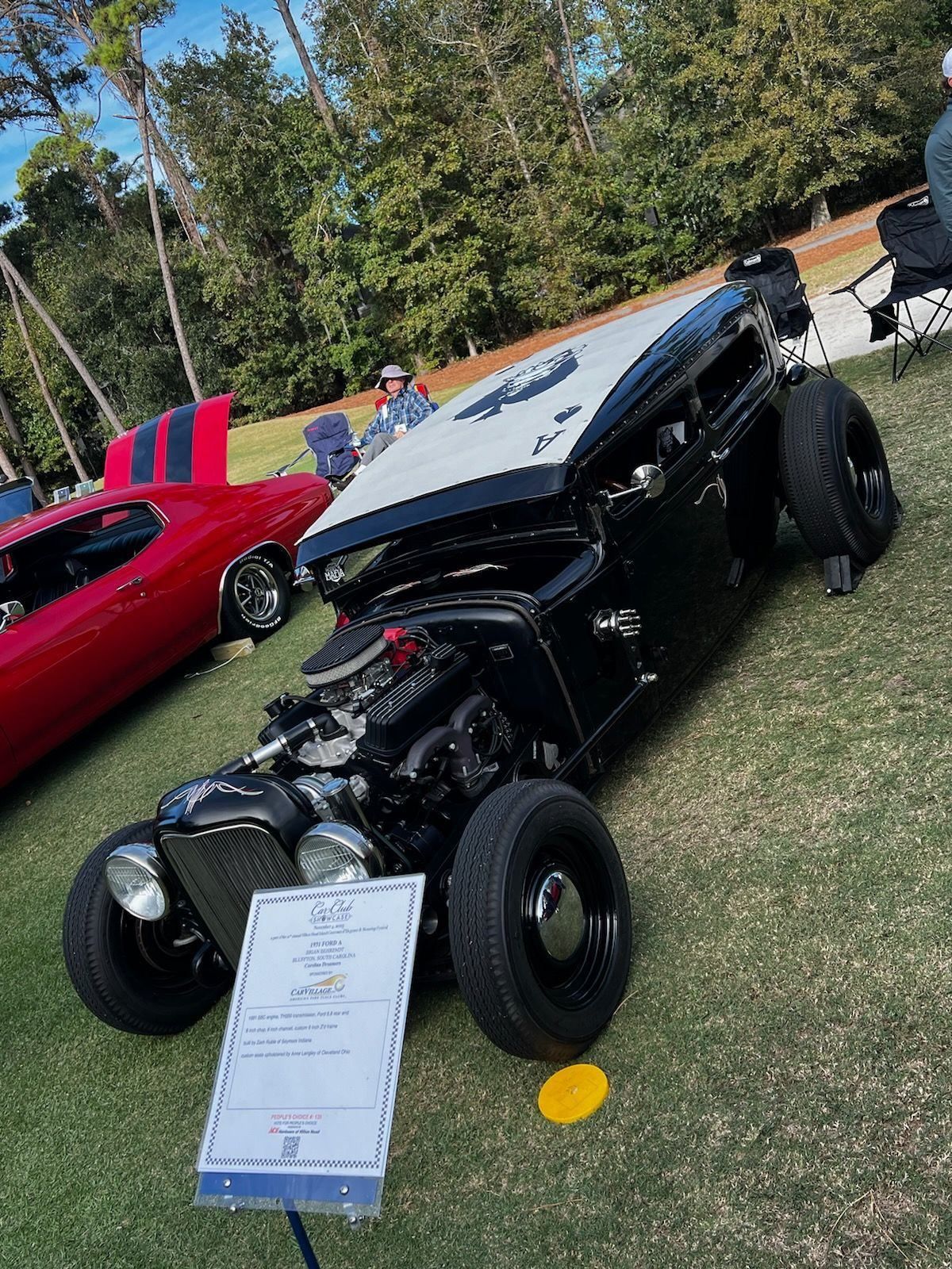

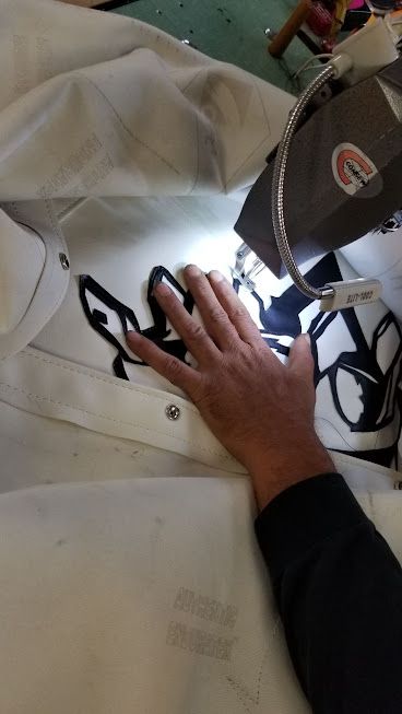

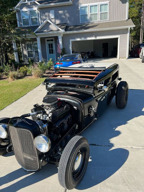

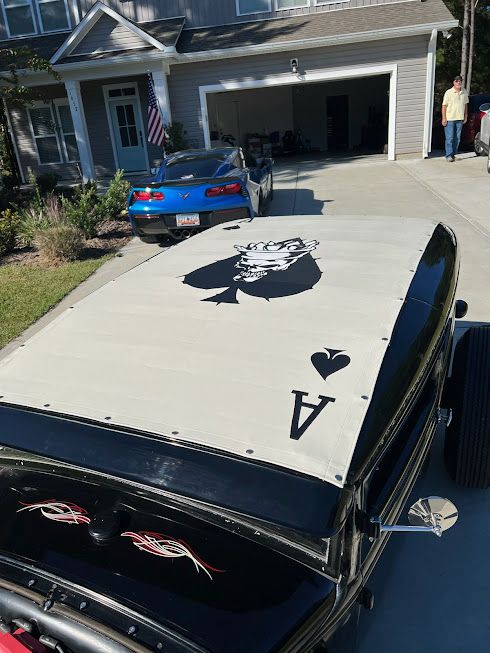

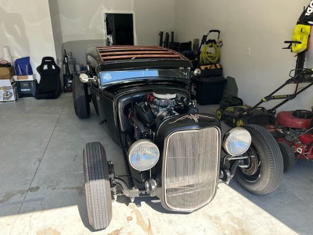

The top....
image000000 (15).jpg (252.21 KiB) Viewed 26050 times
He wanted a way to roll it halfway up so people at the show could look inside so I used a piece of black vinyl and some gypsy studs to make a cover that snaps in place but can be removed

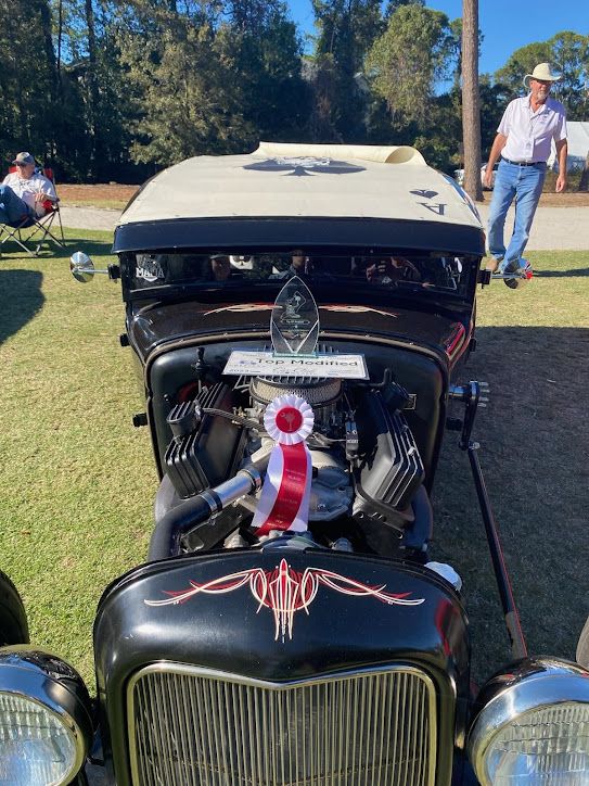

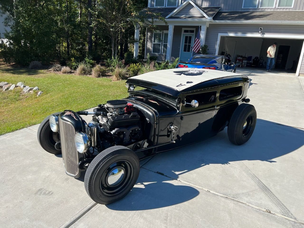

The show was this weekend......
image000000 (14).jpg (553.57 KiB) Viewed 26048 times
And IT WON IT"S CLASS :astonished: :astonished: :astonished:
#16775
Nice job that you did. Looked to be a fun stitchIng project. I don't think that is classed as a rat rod. Things are to neat and shinny paint.
By WILD BILL
#16776
Thanks. Not sure I would call it a rat rod either but that's what the owner called it so who am I to argue LOL.

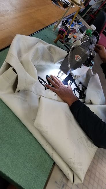

I will say it was a bit fun albeit challenging. I really wasn't sure if I could pull off the seat backs the way he wanted them. I did a couple practice attempts on some scrap before I committed to the real deal.
Sewing the stuff on the top was the most tedious and nerve racking. Almost all of it was done with the hand wheel. One stitch, lift knee, adjust, repeat. The points coming off the spade I found easiest to sew out to the tip and then hold the reverse lever and back up to the main body as opposed to trying to spin the whole thing under the throat.
#22278
I just noticed the wheel chocks at the rear tires. Is that a car show rule or just cautious people? Nothing wrong with it, just curious.
