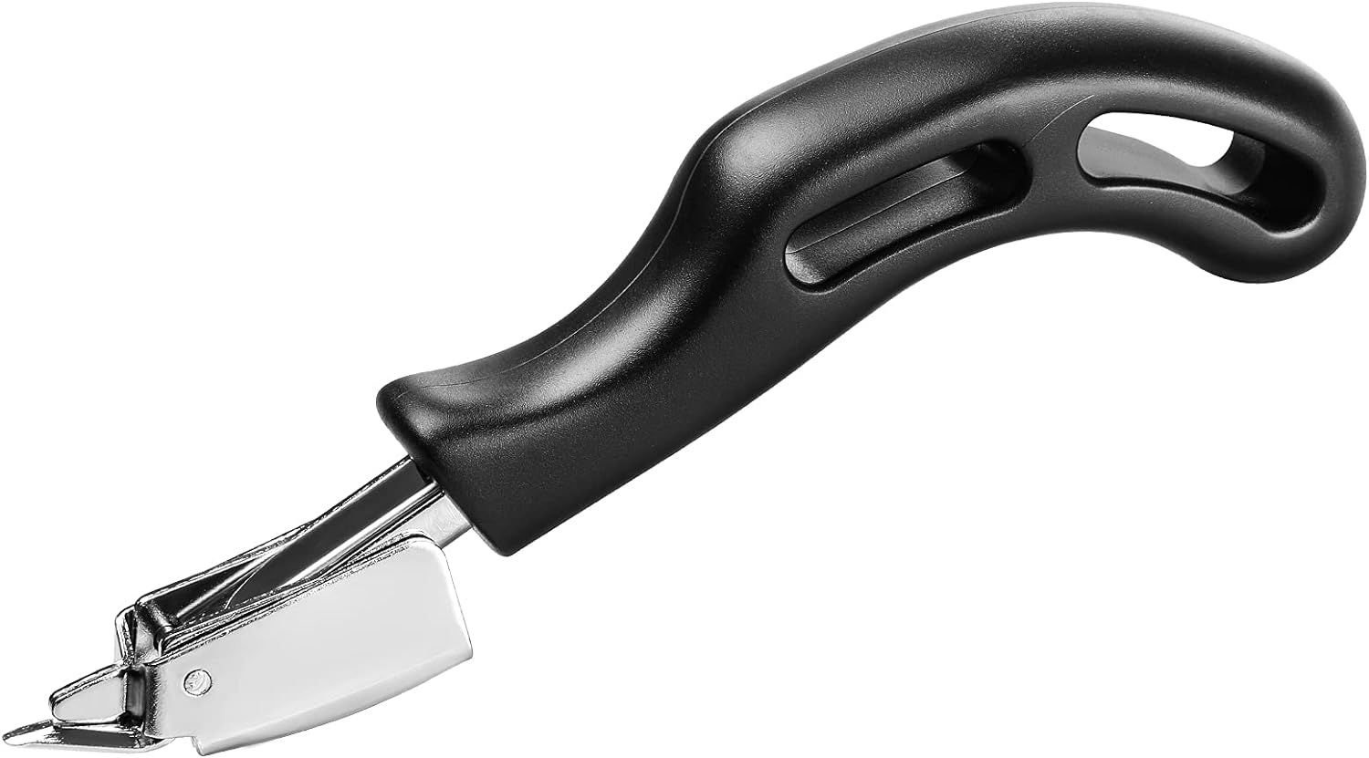

Hello, I have a question about sourcing an old model C.S Osborne staple puller. I make furniture with a process called cold-molding where I staple strips of glue over a form and then pull the staples when the glue has dried. Because of the size of the pieces I end up pulling thousands of staples. I have been using a 12$ puller from amazon that I will post below. Ive used a friends staple puller and its the same style with the two piece pivot, but its C.S Osborne model that is made much much better and doesnt deform like the one Ive bought. I talked to a representative at CS Osborne and he says its the old model 710 that they stopped making 20 years ago. Ive gotten the new model 710, but it doesnt work nearly as well . So basically Im wondering if anyone has a lead for how to find this old model. I havent seen anything come up on ebay. Or maybe someone knows of a company that makes a high quality version like it. Thanks so much.

I use an Osborn but they are evil, one slip and you have a puncture usually in the left arm (for right handers) from not keeping your body parts behind the fork. So far my stab count is 2 in the past 5 years.
If it was me….. I’d consider either turning down the pressure feeding the staple gun so the don’t seat so hard into the wood (if that will give you enough contact pressure) or I’d lay something like a finishing nail down and shoot the staple so it ends up in the middle of the crown then it can be used to pry the staple up when you want to remove it. Alternately you could fold a small piece of vinyl and shoot the staple through it, when you want to remove the staple go in the open end of the folded vinyl…. so that thing has less chance of stabbing you 😂
AGP123, Adam12 liked this
#17390
These are both very sturdy. The one that has a screwdriver handle says "C.S. Osborne&co.USA 120 1/2". And yes, many injuries using both :dizzy_face: . I get one side of the staple up and use a pair of angled side cutters to pull them out. Not a sharp pair or ones that you're particularly fond of but works well.
