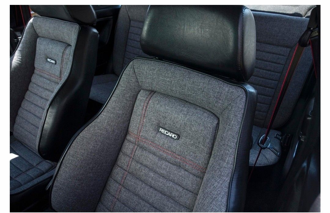

Anyways, to come back to the main subject. I have this vision of using a tweed fabric for the center inserts. Usually tweed is 100% wool and I'm thinking that it's most likely not a good idea for a summer car... To you that's a professional, what would you use? I'll be layering it with 1/4" scrim foam. I annexed a picture of what I'm looking for. Cheers!

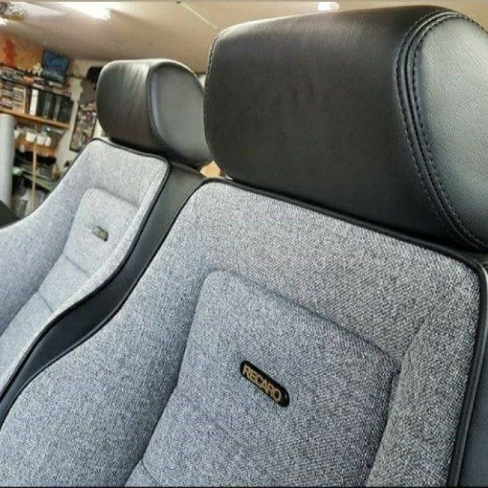

These guys have done exactly what I have in mind. But I can't really ask them what they've used right? I totally agree with their description, it's period correct for an older European car. They also say that tweed is a nice soft material and I've read its pretty thick and easy to wash.
Is it a polyester that mimics tweed or its actually wool tweed? That's what I would like to find out! Anyone here ever used or made something like on the picture?

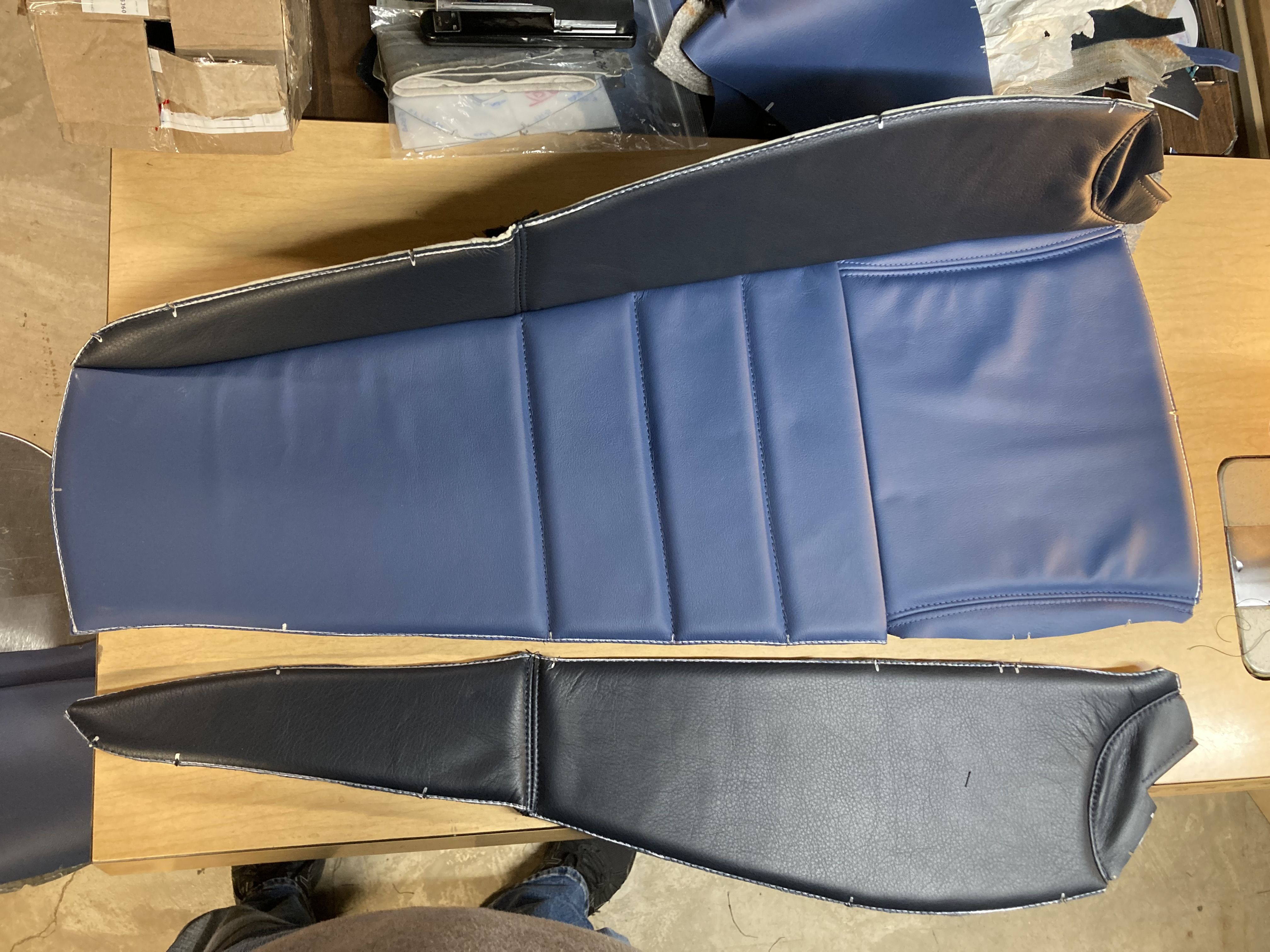

Here is a picture of my center insert with the bolsters, one sewn and the other not, both have 1/2" scrim. Honestly I would not even consider 1/4" unless it was for door cards, there just isn't enough definition.

fibersport wrote: Sun Apr 21, 2024 12:57 pm Here is a picture of my center insert with the bolsters, one sewn and the other not, both have 1/2" scrim. Honestly I would not even consider 1/4" unless it was for door cards, there just isn't enough definition.
Since I have to repair my bolsters and I was thinking of covering my repair with 1/4 scrim after completion, I though 1/4 scrim on the covers would be plenty as it adds up the 1/2". I'm I wrong to think that? Like I said previously I have no experience with upholstery so...
Yours look definitely really good. Is that leather or vinyl? If leather, did you use an interfacing?

Thanks for the compliment, the loose areas should tighten up when I install them. I'm not following when you say you're covering your repair with skrim. Are you planning on leaving the original material and adding new on top? On mine, I took the original covers apart and a friend made me patterns. the 1/2" skrim was glued to the leather and the pattern traced onto it, then it was sewn on the line and cut out. As I said it is leather, what do you mean by interfacing?

There's a local upholster who told me to fix the bolsters with glue and foam, then shape. Once done, cover the repair with glued on top 1/4 scrim. That's what I was told. But thinking about it now with what you're saying, maybe it would be easier & cheaper to just do 1/2 scrim on the leather and call it a day. So you glued it on the leather. I wasn't sure if I should glue entirely or just spots? I've seen both done.

The seats are going into a Jeep CJ7, when done they will be the nicest thing on the whole vehicle! I now understand what you were saying about the 1/4". So you are repairing the foam and then covering the whole seat foam with the 1/4". My friend who has years of experience in upoholstery work suggested I do someting similar as my foam needs some repairs as well. His suggestion was again 1/2" plus the 1/2" that's already attached to the leather. His comments were that it's 40 year old foam and it has really lost its shape. With 1/4", you could always keep building it up to see how you like the look of it in varying thicknesses.
