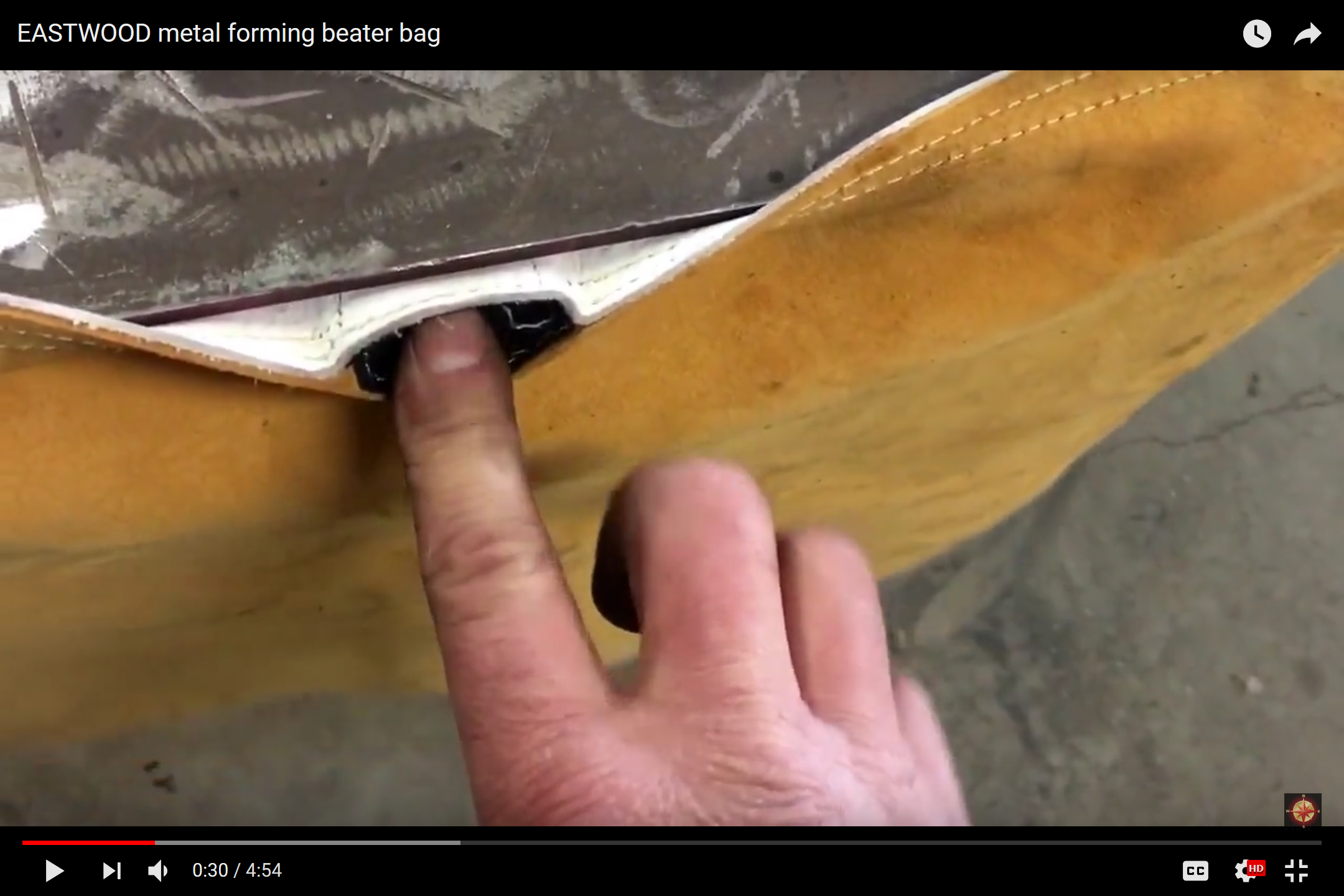

Great question. So on the cheaper bags I have seen and used have Velcro like your talking about. You might be able to use a super strong Velcro like dual lock and have better luck.
Here is a picture of an Eastwood bag with velcro.
Screenshot (37).png (1.78 MiB) Viewed 3778 times

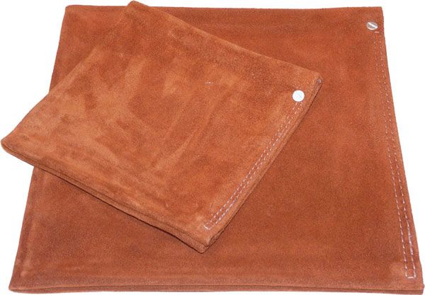

The nicer higher end bags Ive used are closed in the corner with what I call a screw rivet. They are also called Open Back Screw Posts or Binding screws. You have to make a smaller hole but this works nicely. Also the big time sheetmetal guys all recommend using lead shot instead of sand. Its a lot more expensive but you can shape panels much quicker and the lead balls are bigger than sand so it wont come out easily. But lots of people still use sand.
Here are some links to the screw rivet things I'm talking about. You'll have to find on in the size you need.
https://amzn.to/2JYgK6i
https://amzn.to/2JX1u9y
https://amzn.to/2JYhbgW

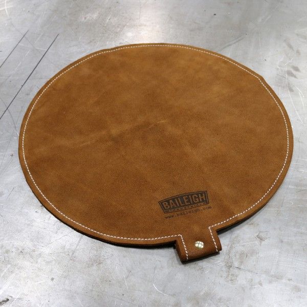

Here is a picture of a bag that uses one.
Some also have a tail that folds over like and is closed with a screw rivet.
