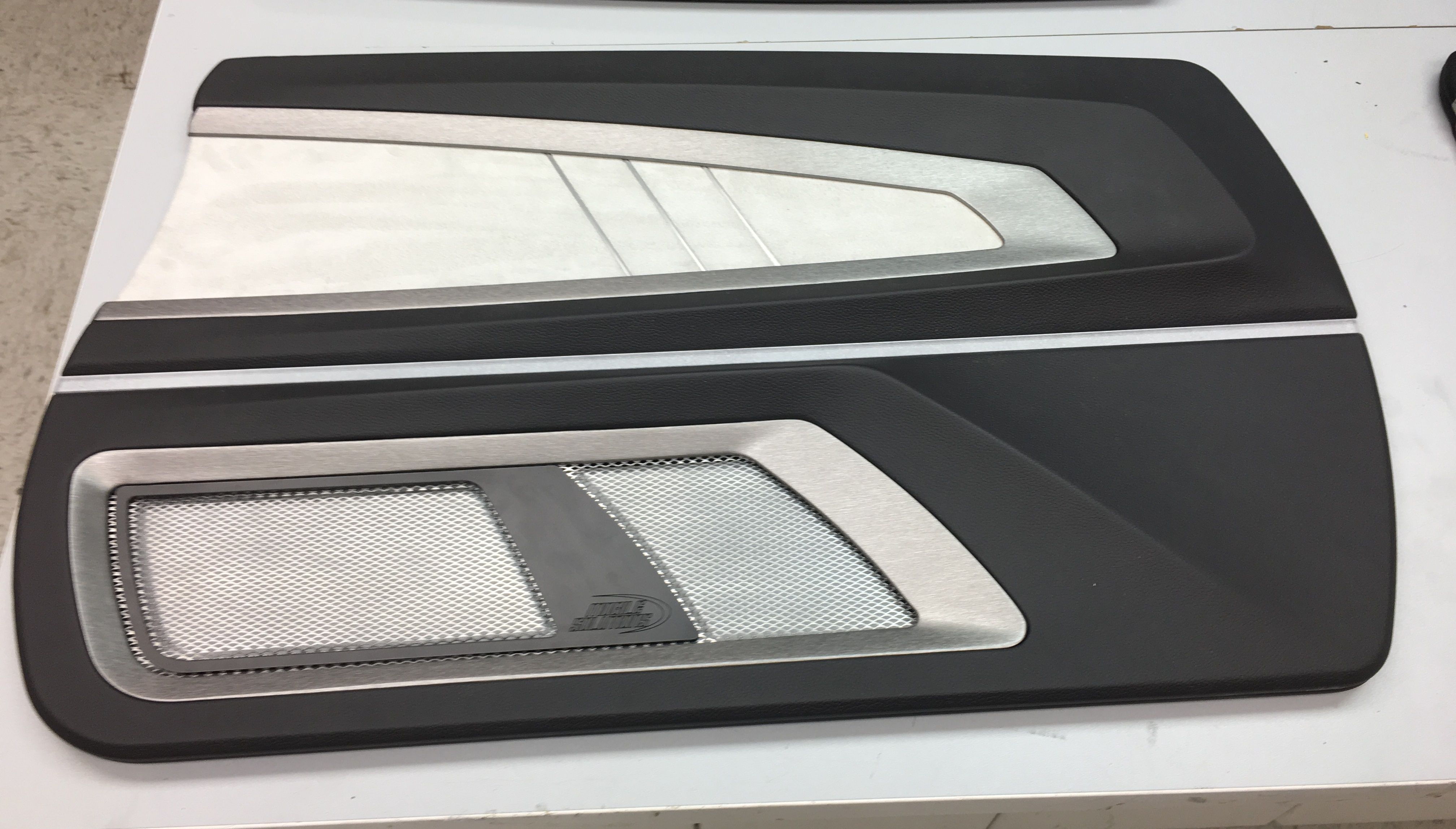

@Trimmerman79 I was just at the door panel class 2 months ago. It was really good. I learned a lot! I decided not to do the subwoofer class in June. Ive never really like or been interested in custom car audio. It was actually kind of strange. There was only 4 trimmers in the whole class. I waiting for them to do another center console class.
This was my panel

John wrote: Wed May 09, 2018 5:51 pm @Trimmerman79 I was just at the door panel class 2 months ago. It was really good. I learned a lot! I decided not to do the subwoofer class in June. Ive never really like or been interested in custom car audio. It was actually kind of strange. There was only 4 trimmers in the whole class. I waiting for them to do another center console class.
This was my panel
Great job on that panel. Looks fantastic! I have yet to making to any of the classes yet. I have a lot of friends that been. Since I’m in he car audio business. Yeah most guys that attend are going to be car audio guys. I love building car more then just building audio systems. Reason why I’m getting into upholstery, so I can do it all from start to finish. I know at one time they had a hotrod trimmer guy teach a class on sewing. Not sure if they still offer it or not. I’m going to watch your online videos.
This was my panel
Ok, my credit card is ready. How long until your Advanced Door Panel video comes out? :wink:
