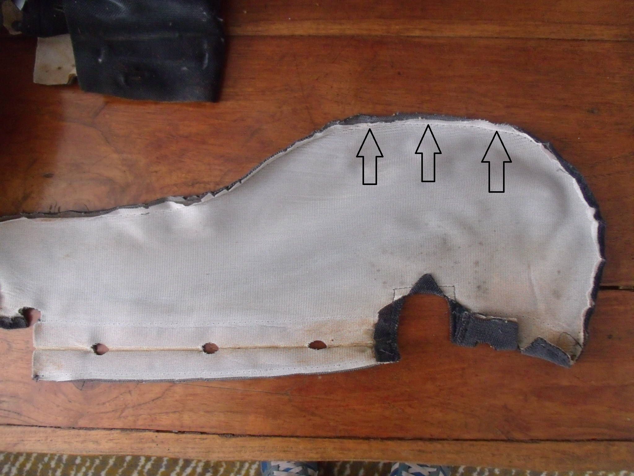

I am about to start a project to recover a pair of old Recaro seats. I have a question regarding cutting patterns from the original cloth.
Should I trim the old seam allowance off the old cloth, to allow for marking an accurate new piece, then obviously add it back to my new fabric, before trimming and sewing ?
Hopefully that makes sense ?
