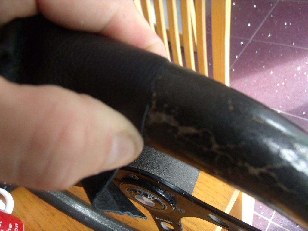

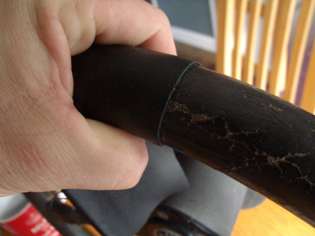

I would like to have a go at recovering a classic 3 spoke steering wheel.
I need to create an invisible join at the spokes, where the short wrap around piece meets the actual circular wheel.

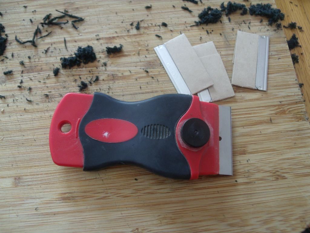

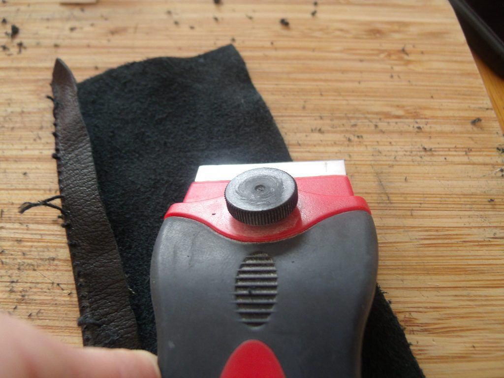

Right then.
I had a look into the bevellers, but I don't think they'll work so well on very thin leather. So, I bought some new razors off Fleabay and tried again, using an old scraper and viola !! Just needed a new sharp blade.
Use a forward shallow crosscut action and it works a treat. Cheers guys.
