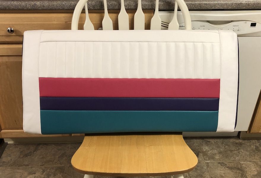

Re: Re-Upholstering cockpit seating of my 33 foot boat
Posted: Sat Dec 07, 2019 2:19 am
by TedP
Here is my re-make of the previous skin.
I got the top stitching much better than the previous attempt. This one will be a keeper.
Posted: Sun Dec 08, 2019 9:02 pm
by TedP
I got the matching base to the seat back that I made done . . .
Here are the pieces
IMG_3710 2.JPG (60.78 KiB) Viewed 74086 times
Here is the completed seat.
Here is the pair . . . Seat back & Base
I am still having trouble with the sharply curved areas. I tend to get a wrinkles or 2 in the seam.
