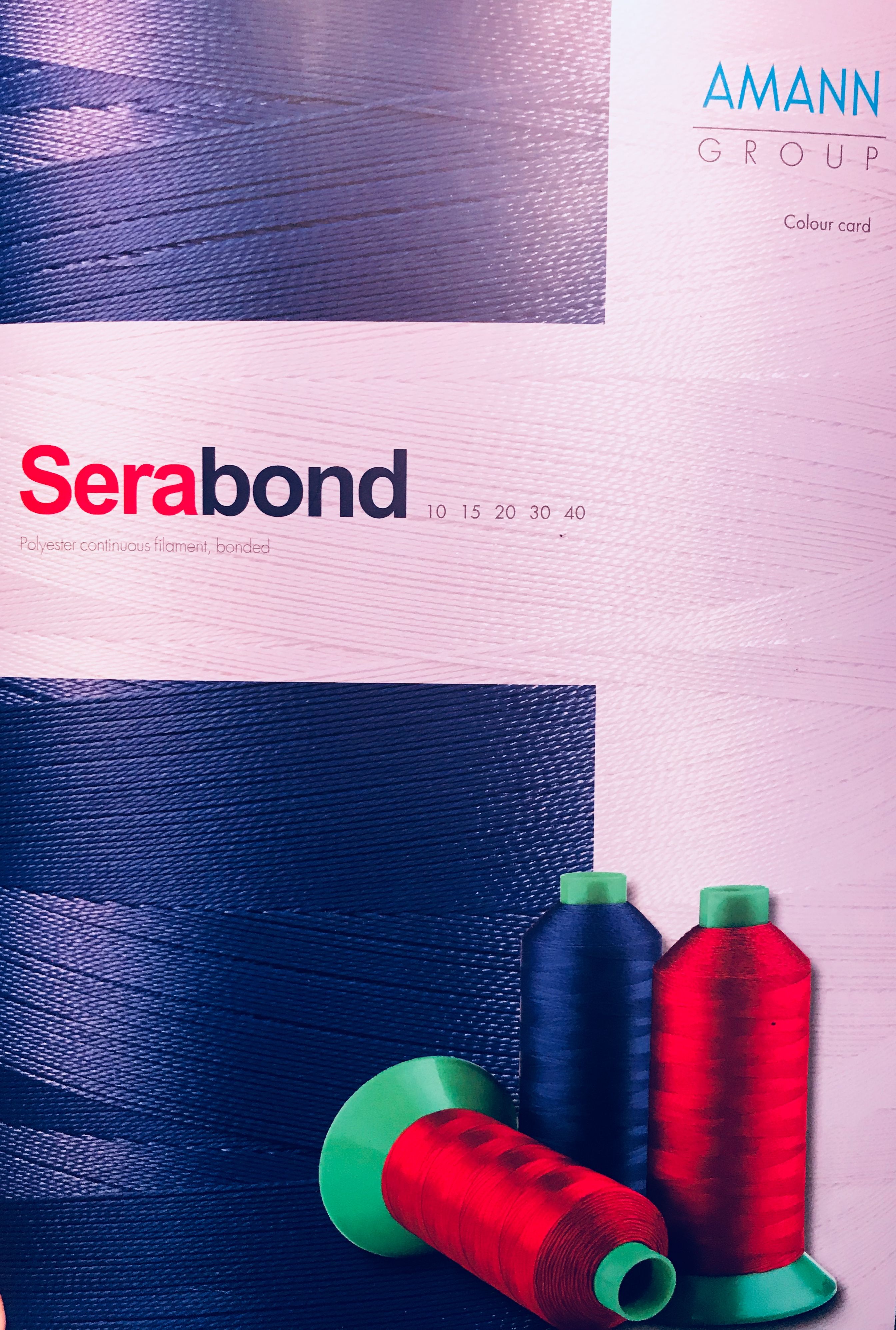

I see that you just became a distributor for Amann Serabond Thread. I have herd nothing but great things about this thread.
I'm hesitant to try it because I have been using Coats UV bonded for years with no problems. A lot of people have told me Amann Serabond Thread is cheaper, better and comes in more sizes and colors. I'm really curious to try it out.
Whats your opinion on this thread? Has there been any tests compering it to Coats? What are customers saying about it?

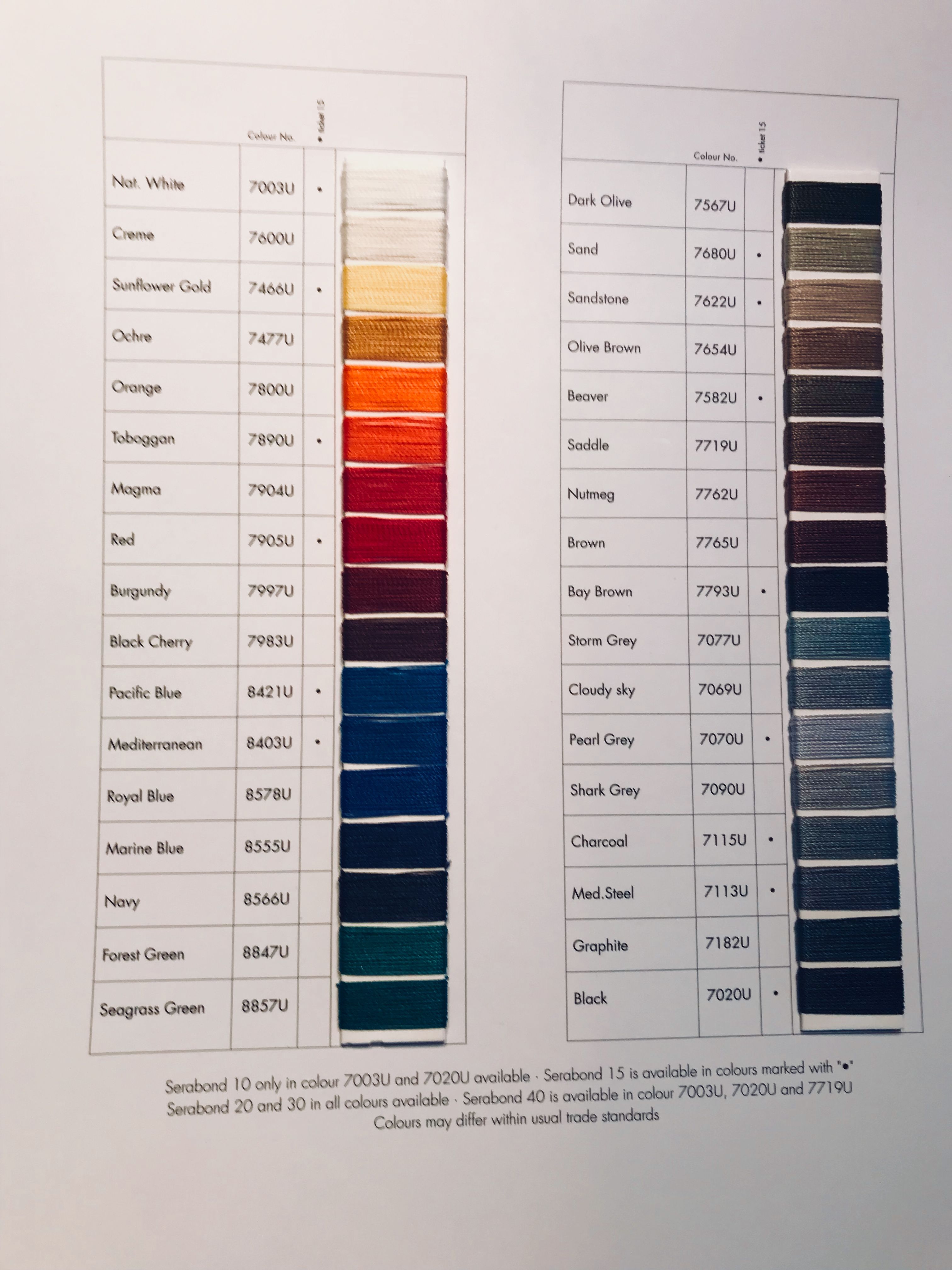

John,
Serabond really is a fantastic thread. It is made in Germany by Amann Group who is considered to be the premier thread manufacturer in Europe.
Serabond is manufactured using the best UV stable dyestuffs available in the world. It is also bonded using a proprietary process which prevents it from unraveling or balling up on your needle while sewing.
At Bry-Tech, we tested it in the field for months before becoming a Master Distributor.
Our customers love the quality, color range, sizes available, and most of all the price!
We stock Serabond in 92,138, and 210 and Bobbins in style G and M in 92 and 138.
I can email a color chart and price list to anyone who is interested.
